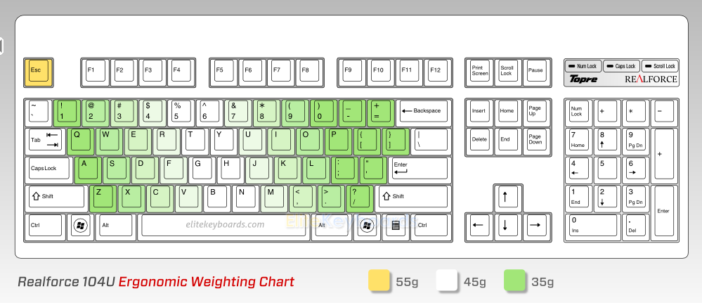

Ah that makes it a bit tougher without the option to easily obtain (with the potential to return) the 45g uniform board. Usually the 45g uniform board is the solid go-to for those who like a light topre switch. 35g variable weight is met with very very mixed reviews.
Personally, I think it’s alright, but the main thing about the variable weight is the keyboard expects you to type on it properly. The keys are lighter/heavier corresponding to how close they are to the center (with your pointer and middle fingers being a bit stronger than your ring and pinky fingers). The exception is all of the keys surrounding the main typing cluster which they keep at 45g.
Even with this in mind, the variable weight has a naturally inconsistent feel that some people appreciate, but a lot of people dislike. Many people also don’t like 35g as it’s regarded as “too light”, but I know there are quite a few who have some appreciation for it. I think @norbauer likes his 35g domes.
