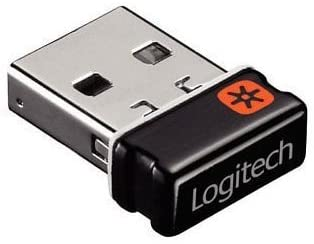

Logitech USB receiver:

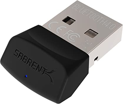

Sabrent Bluetooth 4.0 dongle:
