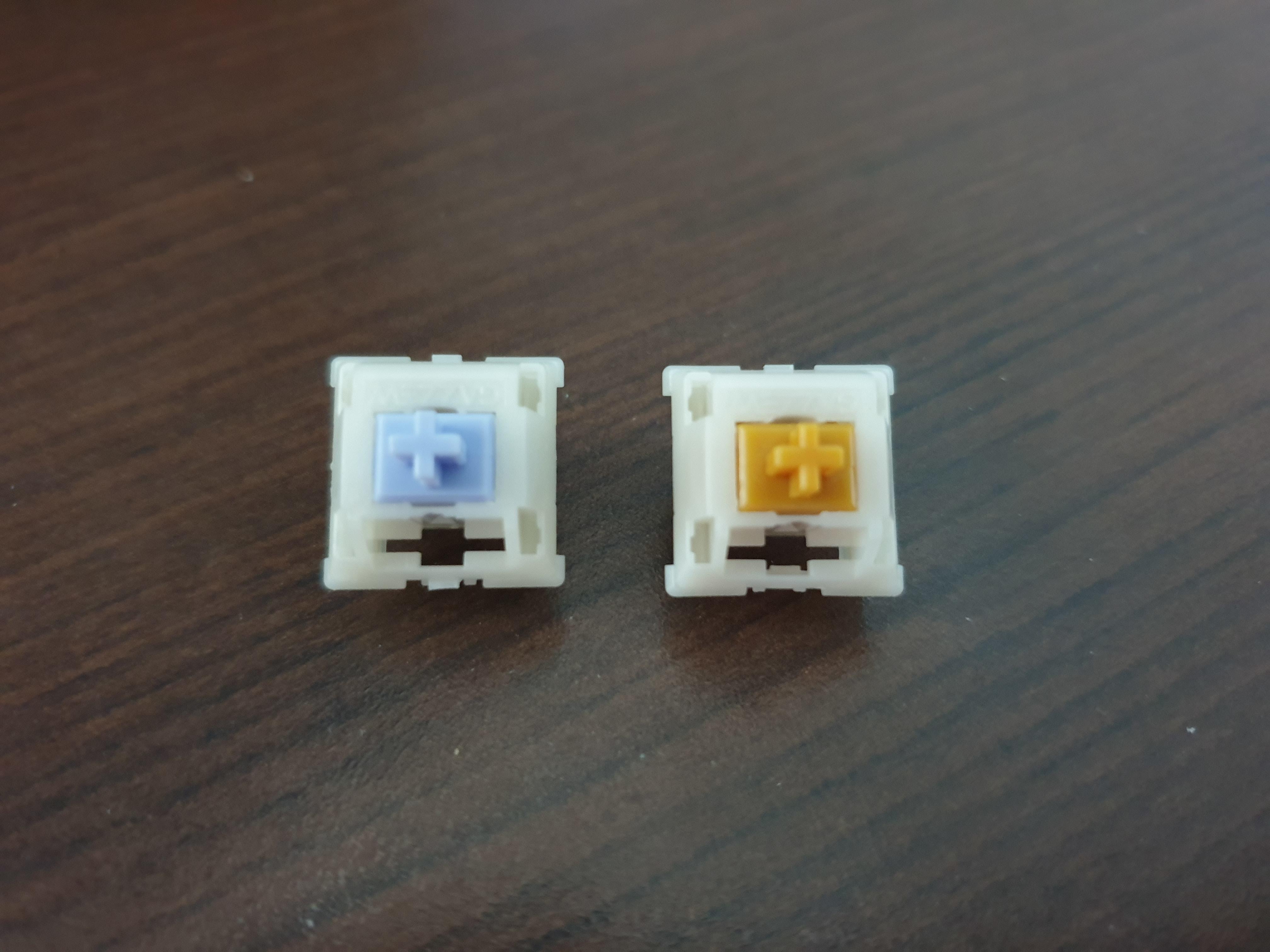

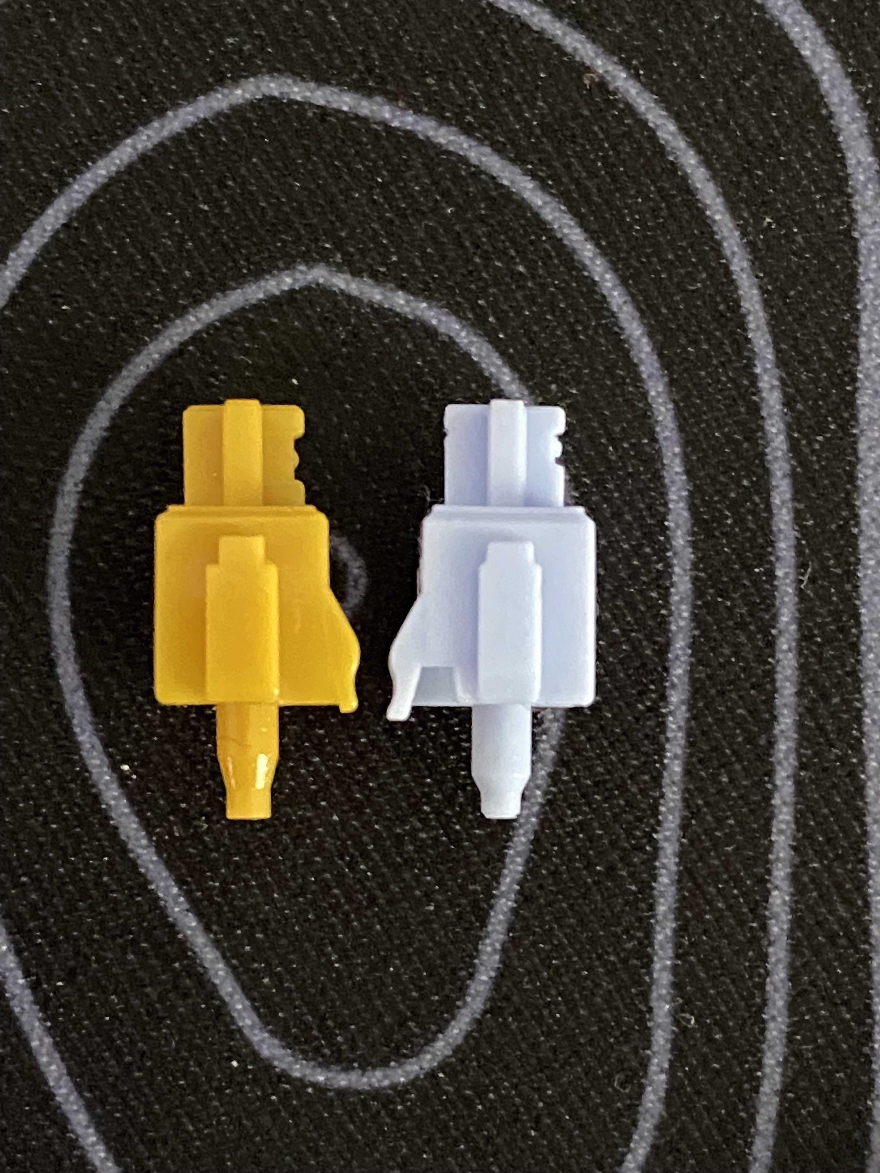

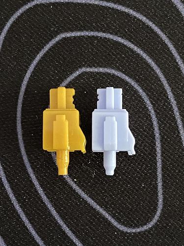

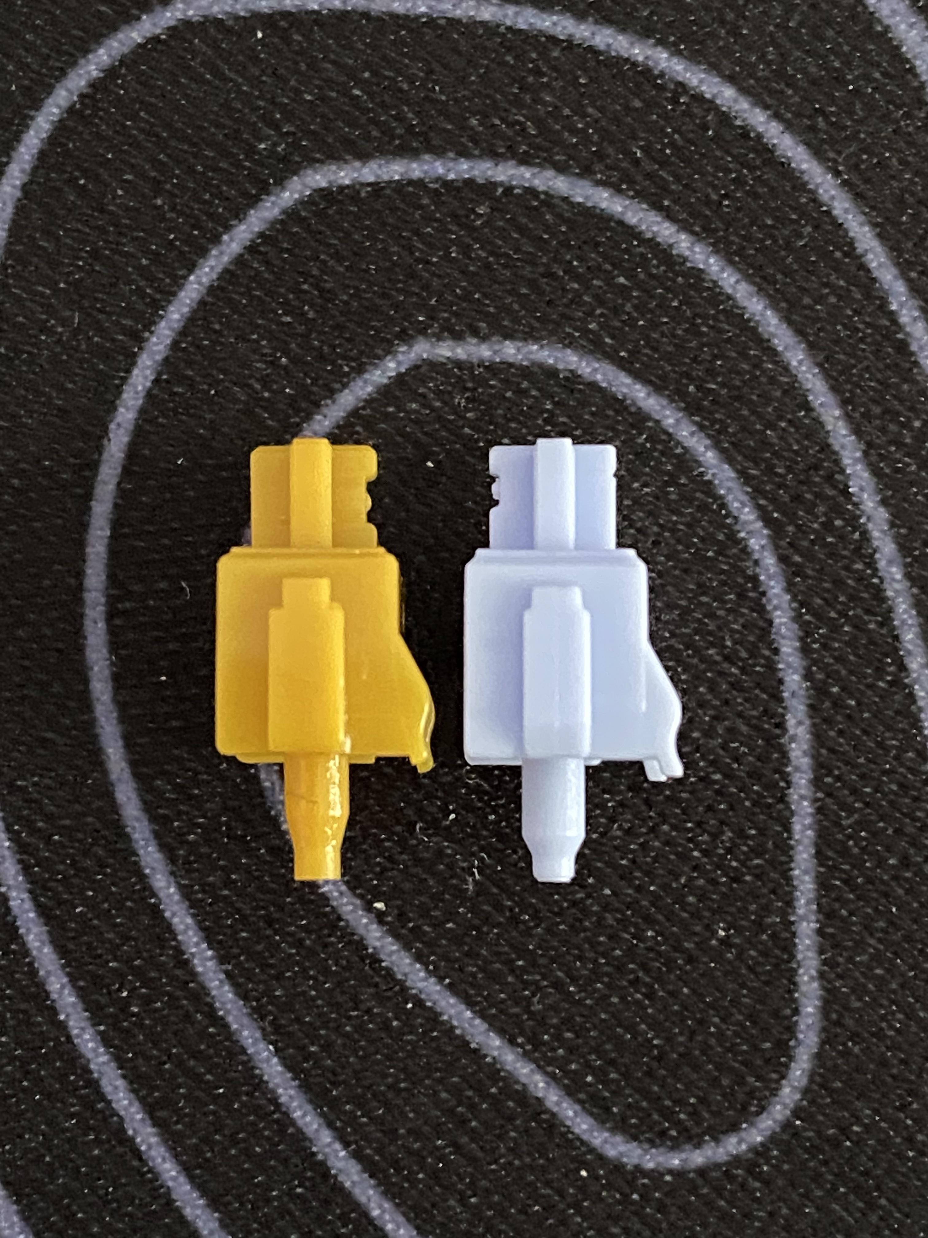

Hello all,
I thought I would contribute a couple of comparison pics of the U4T vs. Polia Stems. And my experimenting w them.
Before I attempted this swap I could not find any pics w these two stems compared.
My research tells me that Polia & Halos are the exact same stem. Since I was able to grab the polia’s
dirt cheap. I gave them a go…
Issues I ran into are confirmed:
- Stem return on just a handful of 110qty.
- My normal “go-to” spring weights felt noticeably heavier. I tried…
- 68g stock Boba’s
- 67g TX long (16mm)
- 62g TX long(16mm)
- I finally arrived comfortably @ 60g TX Long.
I could even go a touch lighter and would be happy. maybe the 58gL
I think the the long spring or any hybrid spring may help with the return issues on some housings for sure with making Holy Bobas. And other housings swapped in for the same stem w issue performed without issue. Trial & error is necessary for tuning imho.
The results for me are a success. I like them much better with the crispy bump & sound. I can definitely feel the difference in both variations of the switch. Happy tuning!
