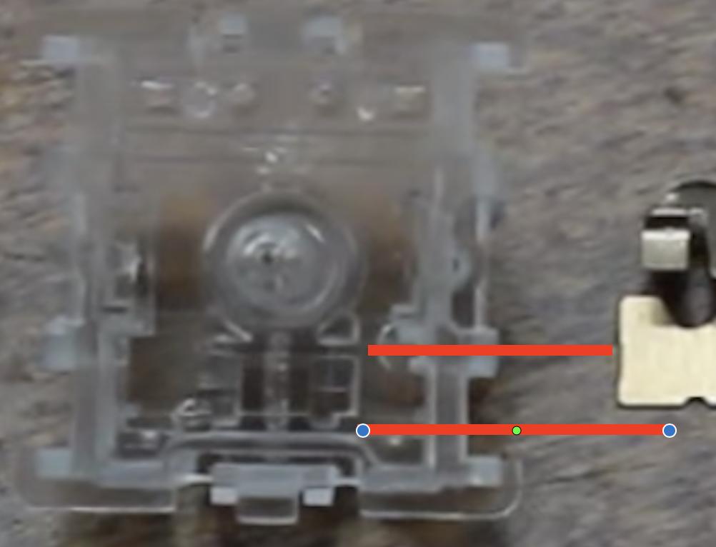

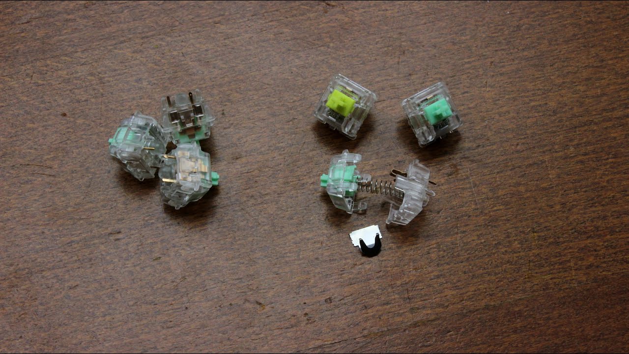

Chyros doing his thing. The way they go into tactile mode was a surprise to me & apparently the feature Zeal wants to patent.
Hmm so you can move it from Clicky to ultra tactile by where you place the leaf… I am thinking the leaf in the tactile “mode” is so close it can’t click any more?
I am assuming these are the two rails were the leaf can sit?
Really interesting. I was kind of hoping for a tactile bump similar to ALPS Browns, cause I would love to try something like that (that is readily available) but I sounds like this will be a big bump. More akin to HPs or something.
What I had read from hearsay suggested that the tactile mod is very tactile, like BOX Royal or higher.
Ah, that makes more sense. So it is still possible it can be cloned by someone else again, just without the adjustable leaf feature.
