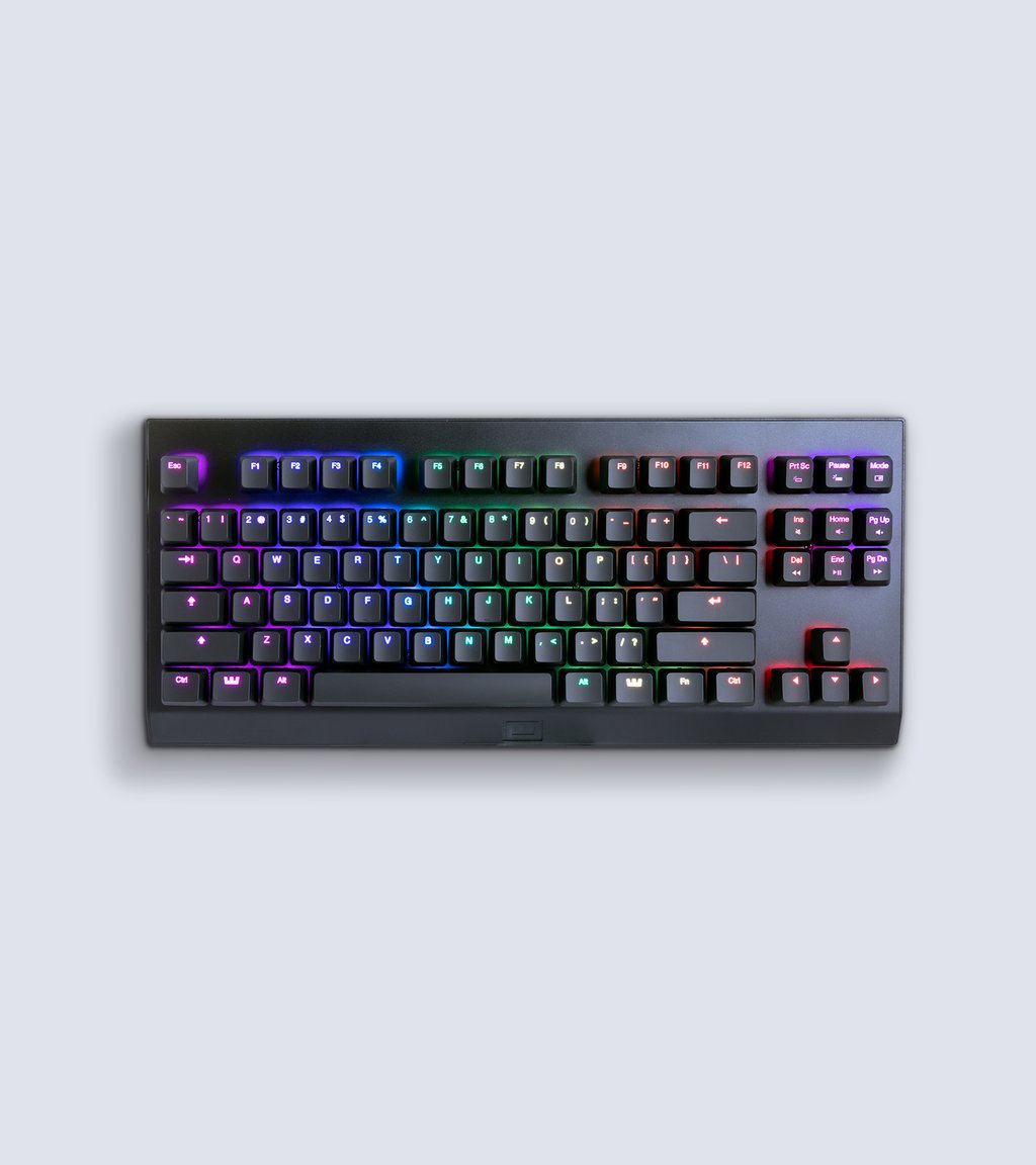

How about a Wooting? The optical switches don’t have metal pins, so you should be able to hotswap many more times. And they have ISO-De.
