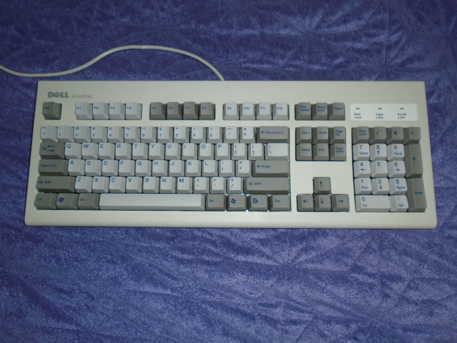

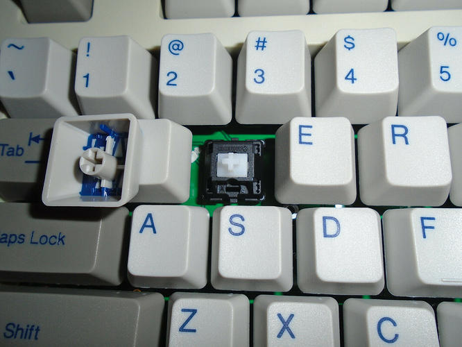

Converting Rubber Dome membrane keyboards into Mechanical thread
Interesting. Was this manufactured by Cherry?
No, Silitek. PCB manufactured by JLCPCB

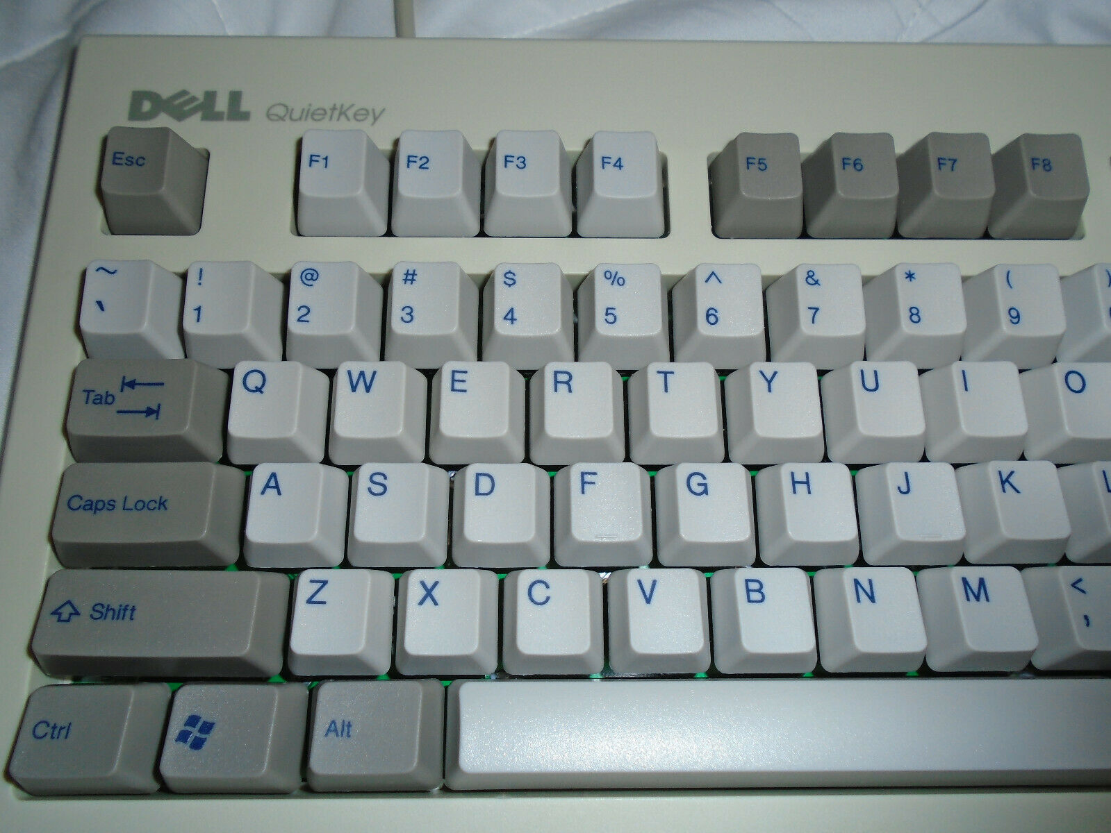

Really cool project. I own a quietkey and really like it. It’s the only rubber dome I’ve kept throughout the hobby. Did you cut the plate away from the top?

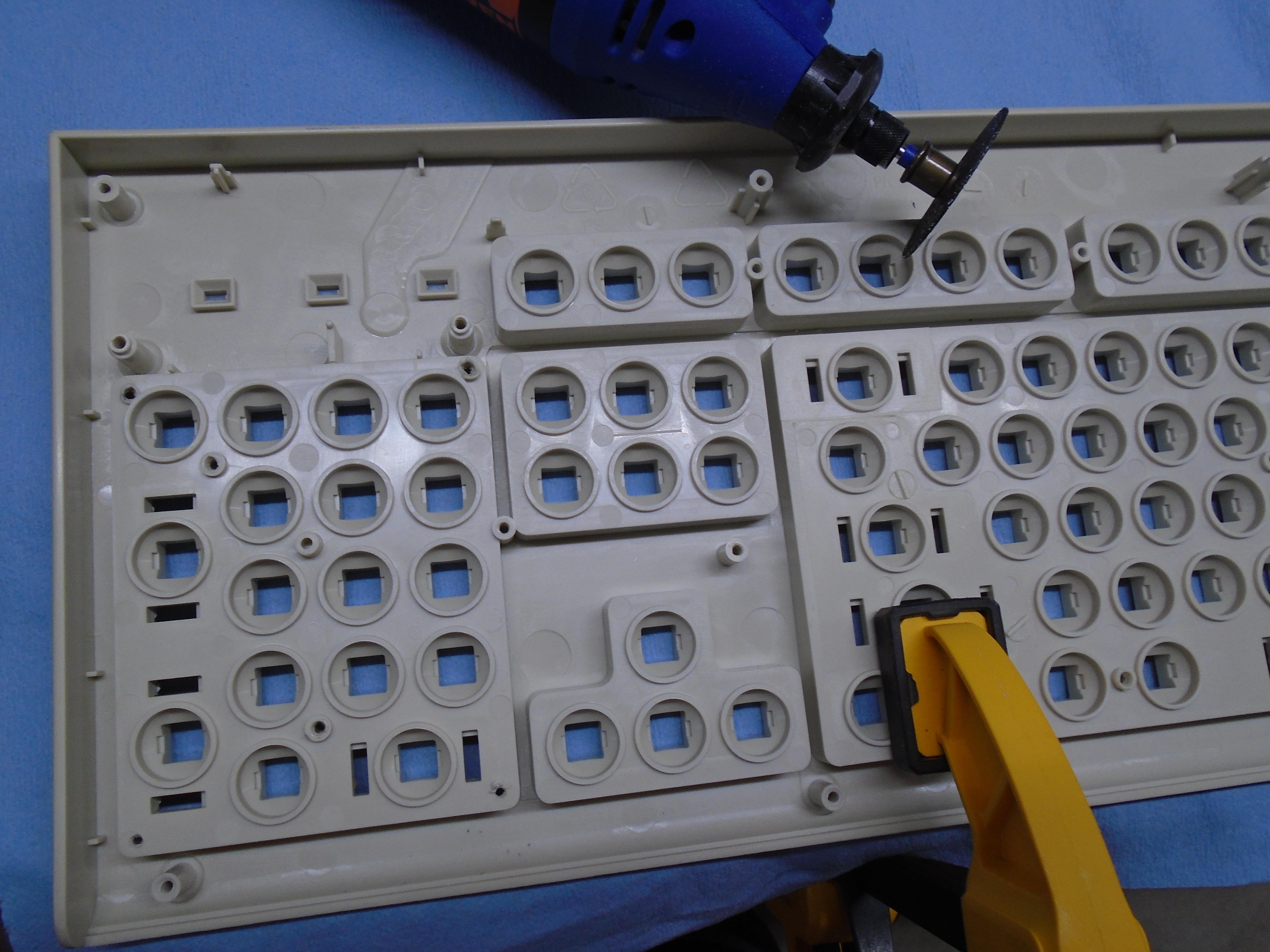

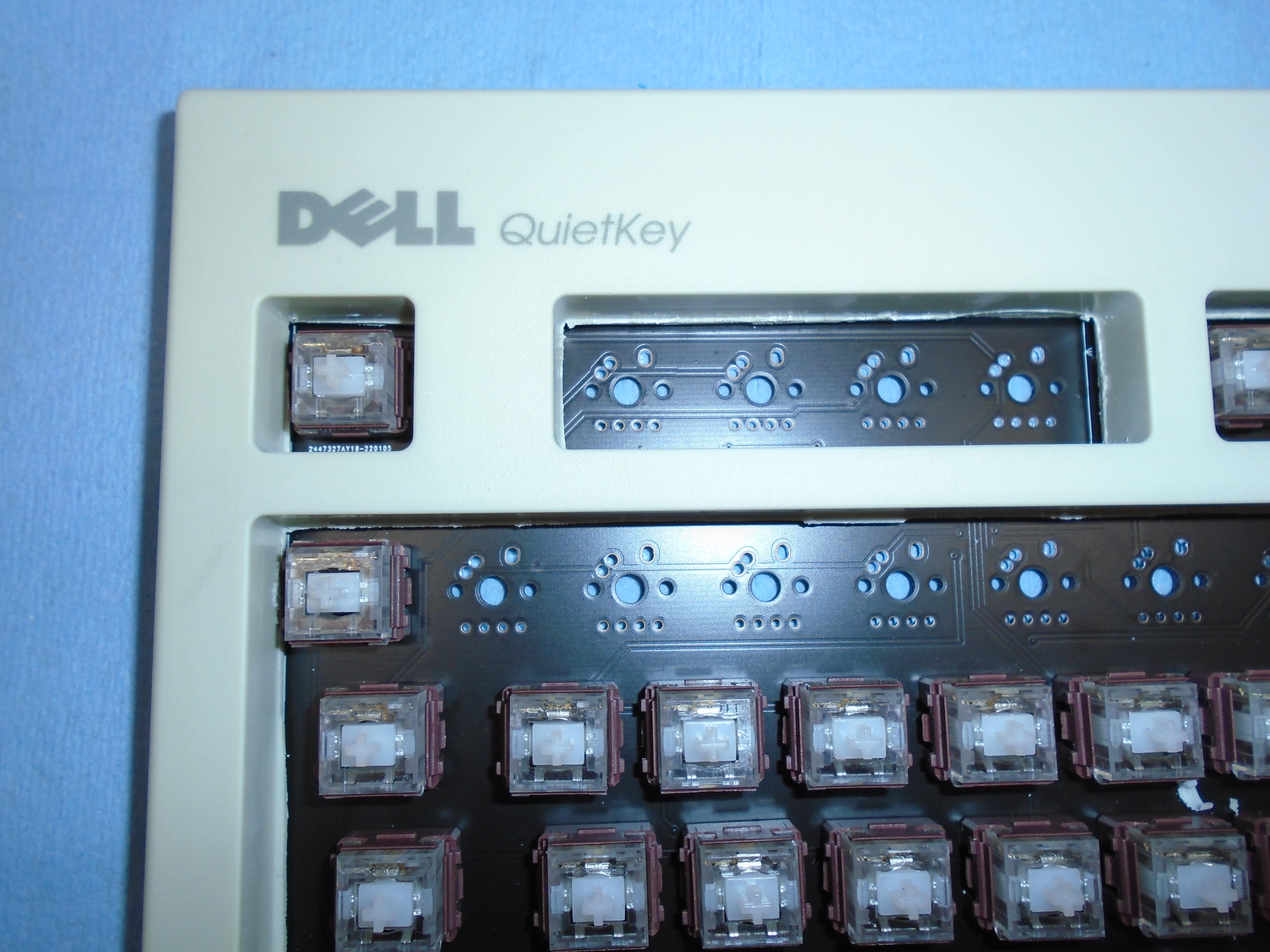

Preparation for cutting:

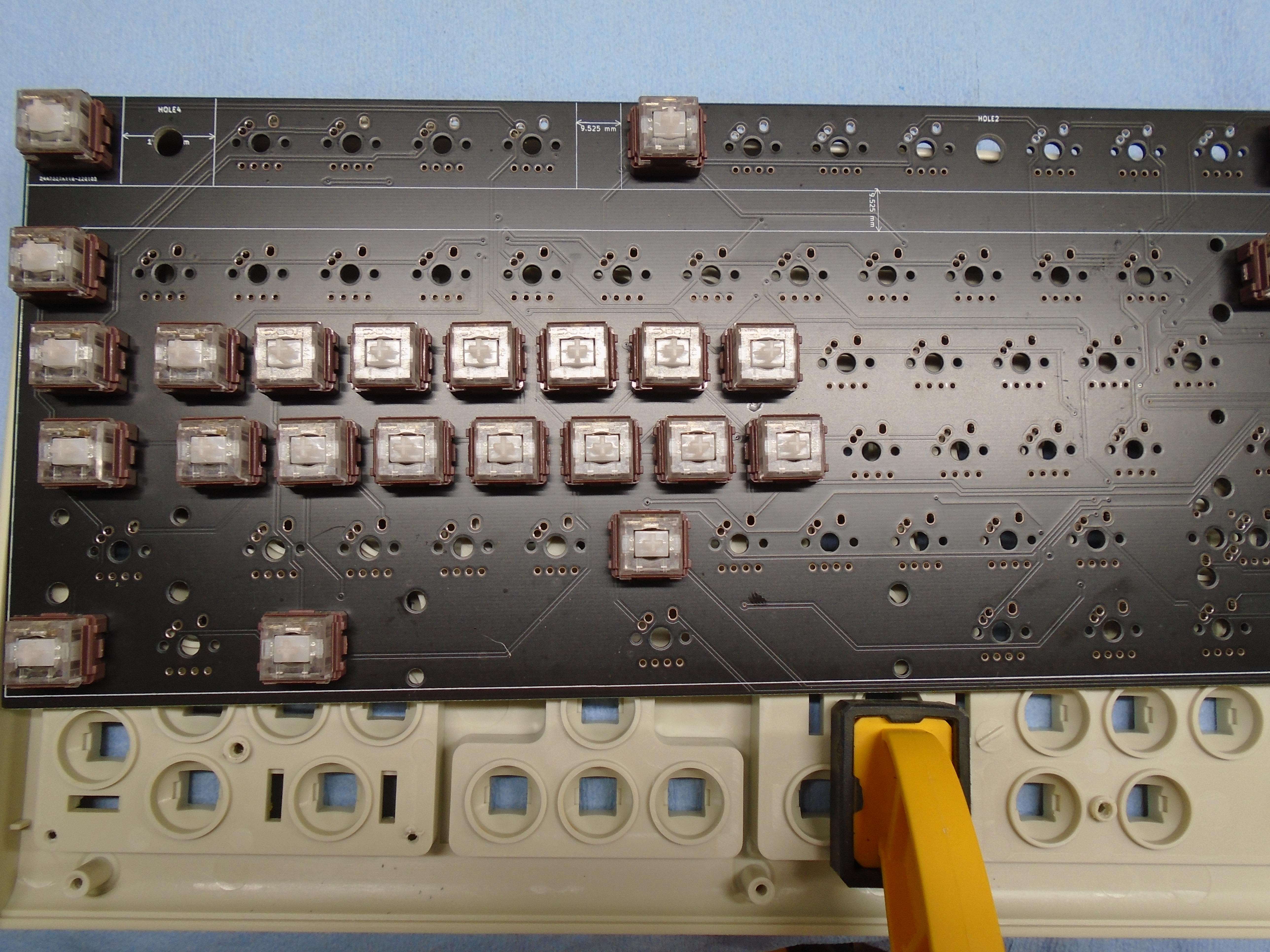

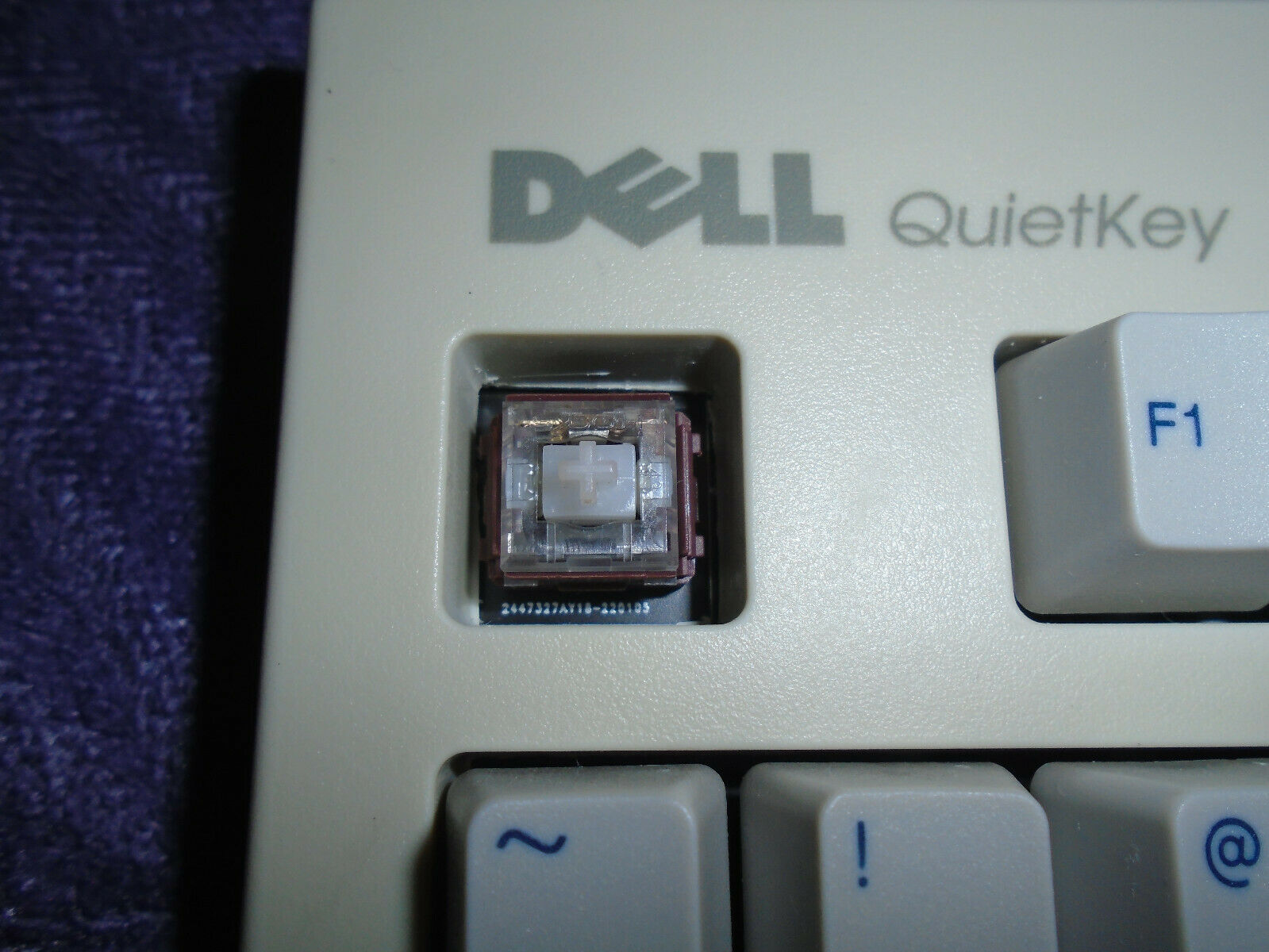

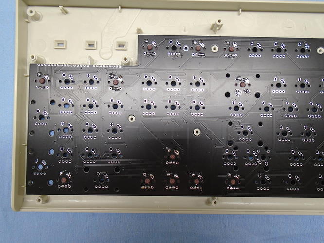

Partially assembled PCB module:
Yeah, I’m goign to want to see that cutting process. That doesn’t look fun. :grinning_face_with_smiling_eyes:
Oh, and I just realized it’s Alps compatible too. Nifty. Could do some SP Alps sets with that using cherry stabilizer. I guess the trick there would be getting the Alps switches soldered in straight without a plate. I remember someone making a jig to assist with that process at one point.
I am working on ALPS plate designs for this keyboard.
These I-Rocks ALPS-like switches have a space for a jumper or diode inside so I can PCB mount them.

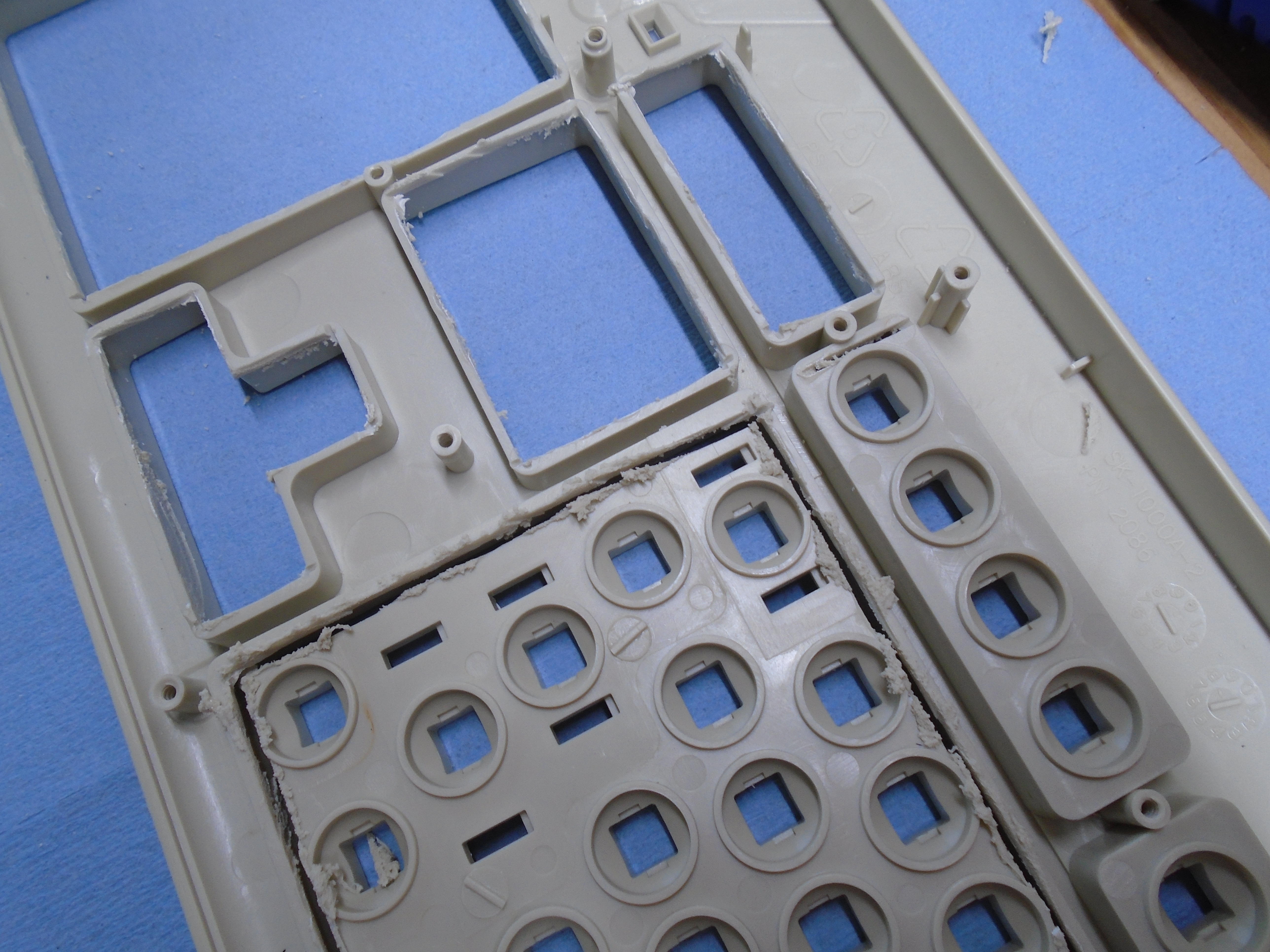

Cutting in progress:
Do the two halves perfectly sandwich the PCB or do you have to add some gasket material to keep it tight?
A plastic sheet is added which I will show later.
How PCB fits into top half:
