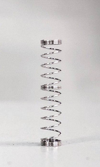

Multi stage springs are best described as 2 or 3 springs stacked on top of each other, but they are made from a single wire. The pic below is of a 2 stage spring, a 3 stage spring would have another section, & a single stage spring is just a regular spring.

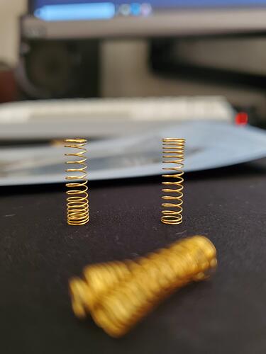

Then there is the opposite of multi stage & long springs, which is progressive & complex springs. With them they start off lighter than a normal spring of the same weighting but more rapidly increase in resistance towards the bottom of the key press. This is accomplished by having the windings tighter on one end of the spring.
