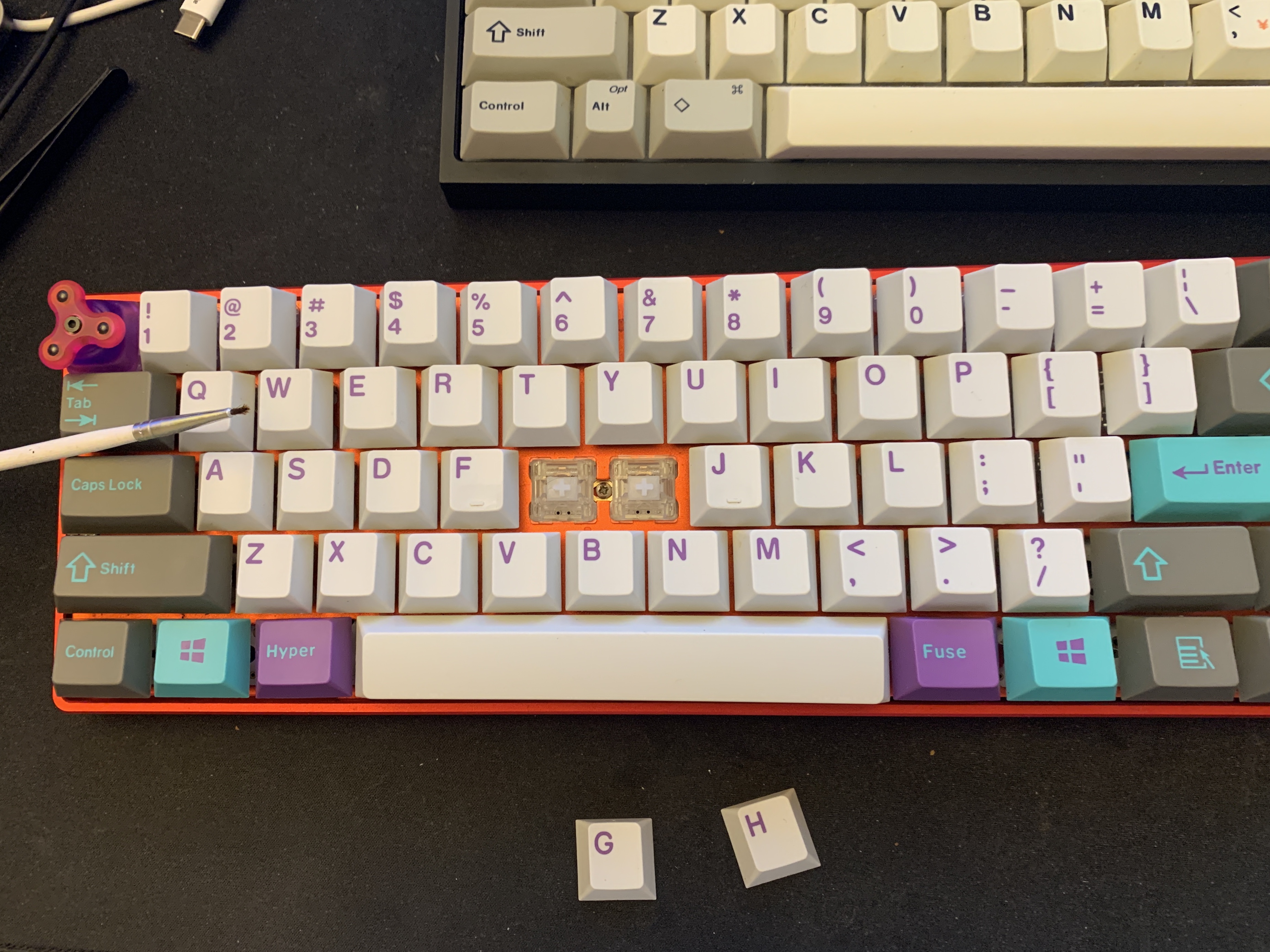

After finding 206g00 useful with UHMWPE stems, I am thinking about relubing my Cream board with it because lube seems to wear off faster for some reason. To experiment, I’ve re-lubed just the spacebar row. I’ll report back after a month or so.
UPDATE: Forgot to describe how 206g00 on filmed Cream feels like: it feels like large knobs on expensive stereo amplifiers: velvety and snug. I love the loud hollow sound of Cream but, unlike Tealios and Ink, it feels kinda cheap. Thick lubes make the switch feel more luxurious. I found that the feel of 205g0 doesn’t last as long as other switches. Hopefully, 206g00 will lasts longer. Warning: YMMV. Not everyone enjoys this expensive knob feel, instead finding it sluggish.
