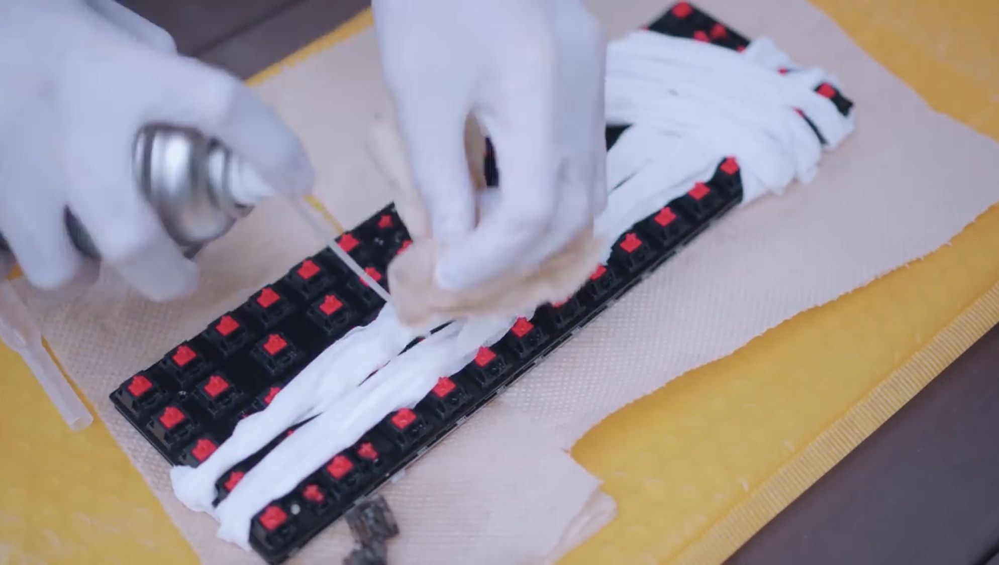

Spray lube. Great idea or is it more like hold my beer?
Hold my beer for sure, not enough portion control to control consistency, lube gets everywhere inside the switch vs the targeted areas you want, possibility of the accelerant used could react badly with the plastics, the excess lube you’ll put in each switch for it fully lube it will end up pooling at the bottom or leak out onto the PCB, etc. Seems like the board would end up being an inconsistent feeling, chattering mess not to long after doing something like this in my mind.
What switches have a open center-“pin”? I’m thinking about lubing from the other side would work better. :thinking:
Hmm, Kaihl BOX switches had the center pin open on the bottom. Not sure if that has changed with retoolings or not though. Interesting ideal that might be more plausible than spray lubing from the top. Personally I still wouldn’t do it, but if you have some BOX switches that have the center pin open & a hotswap board doing a few that way would let you know if it is viable or not.
I’m not sure where the cut-off is, but some Box switches have the ports and some don’t. More recent “mainline” ones don’t seem to, but the Hakos I have do, the Art Boxes I have do, and some of the older regular Boxes I’ve seen also have them.
