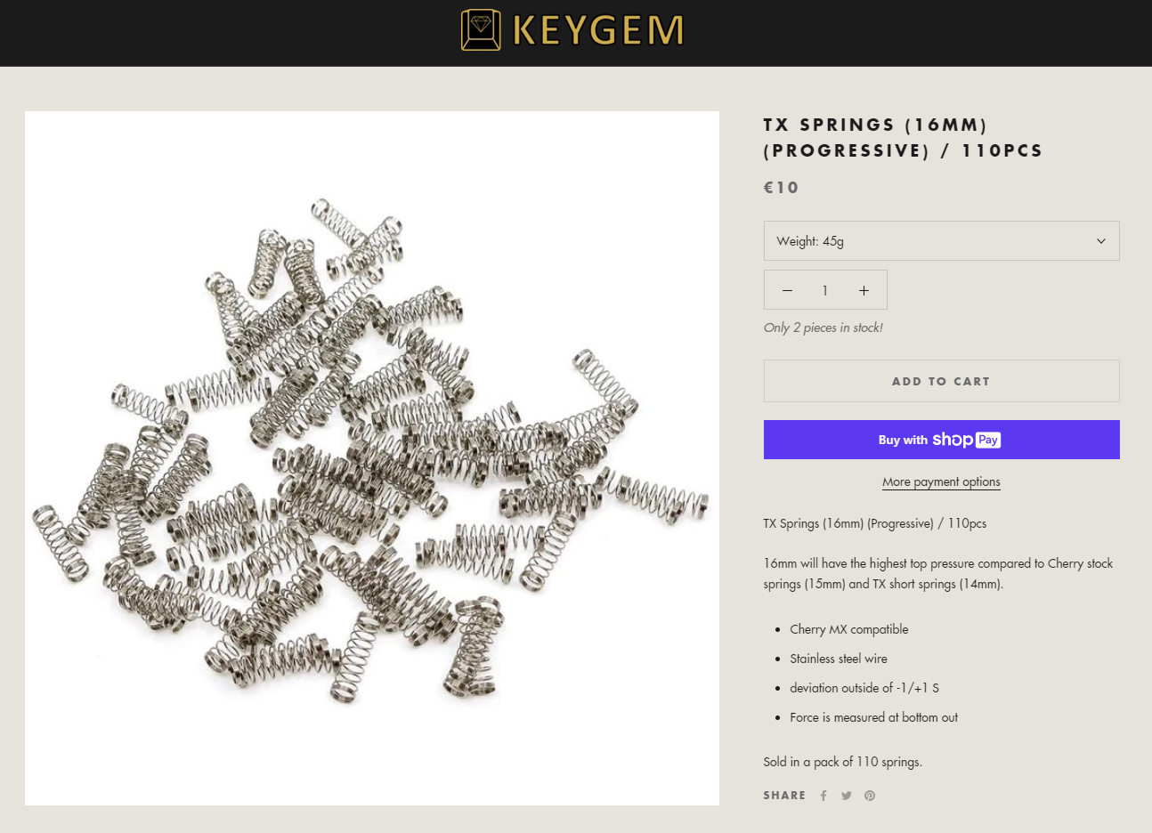

I also ordered some TX long springs, they are supposed to be “progressive” (at least are marketed as such), but I kind of doubt that…š
Can you comment on how do they compare to the regular springs with the same weight?
Also, any ping?
no, they marketed as “slow curve” springs and not progressive. as donpark said, they slightly heavier at top.
These should be marketed as slow curve and not progressive, it is a mistake of the vendor.
I ordered some of these to :upside_down_face:
no pings while testing but I’m not a pingmaster so ¯\_(ツ)_/¯
