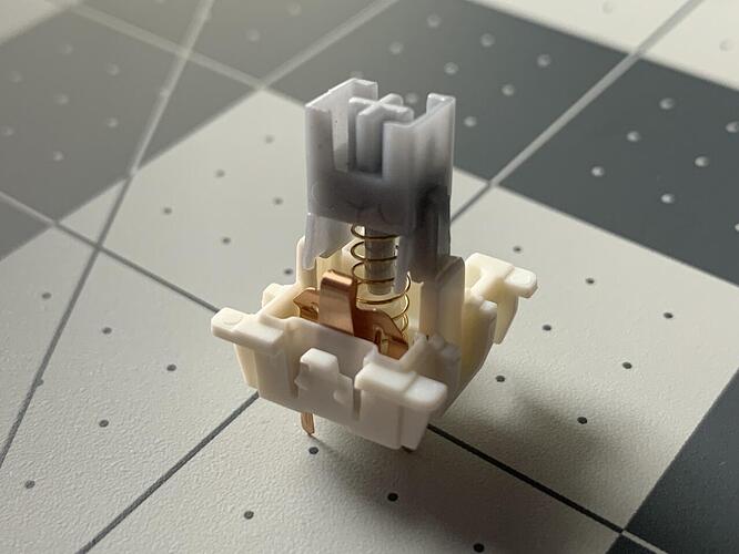

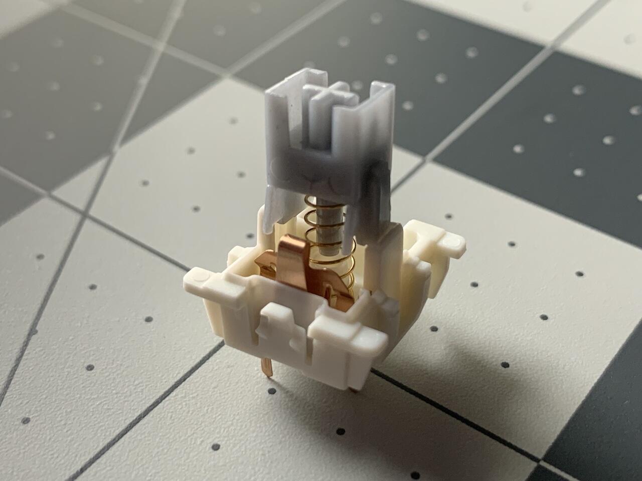

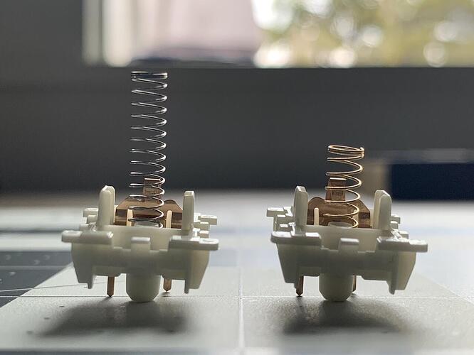

I just wanted to share a happy accident I had when messing around with some Gateron Silver Pros. When I first opened them I was a bit unsure about the use of a long spring in a speed switch. It seems like all you’d experience is spring tension with a switch having reduced travel. Not bad, but because the keypress has so much upstroke force, the top clack is a bit annoying and the keycap never really leaves your fingertip when typing – weirdly uncomfortable IMO.
I thought a stubby, slightly heavier spring with a noticeably flat actuation feel would provide some premium stiffness while still feeling extremely speedy.
These 78g I harvested from some spare H1’s did not disappoint.
With the stem basically resting within the bottom housing now, zero spring tension is felt during the downstroke and the actuation force feels flat and constant. The upstoke is way better too, and it doesn’t feel like typing on tuning forks anymore.
