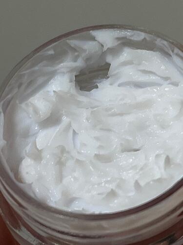

I’m lubing with a Tribosys 3204 I had for over a year and it seems like it got “dry”?

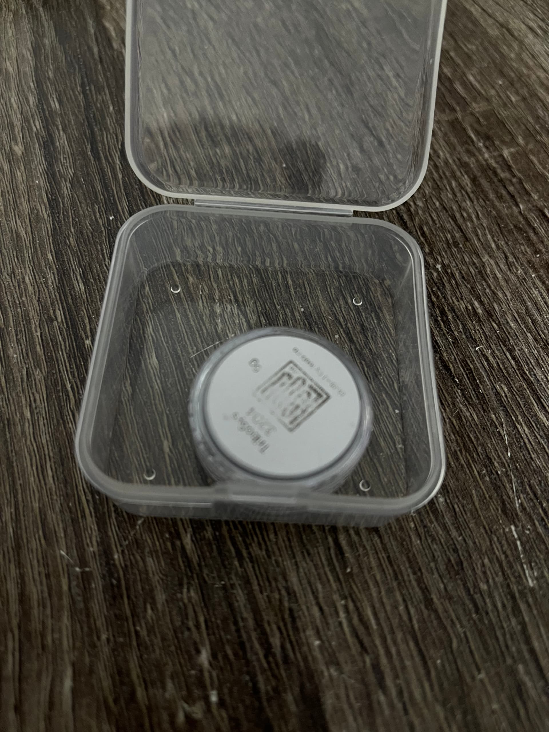

The box the container was inside had quite a bit of oil residue, container was potentially broken on the bottom but I was under the impression 3204 isn’t supposed to separate?
Box (after cleaning)
Looks really matte in person.
3203 and 3204 will separate some over time. If they’ve been sitting for a while between uses, a quick stir is all it takes to re-suspend the oil. It’s unfortunate that the oil leaked into the surrounding container.
Matches my observation as well although lube from oversea seem to separate more and faster. Without any information, I’d guess above 3204 is straight from the factory.
