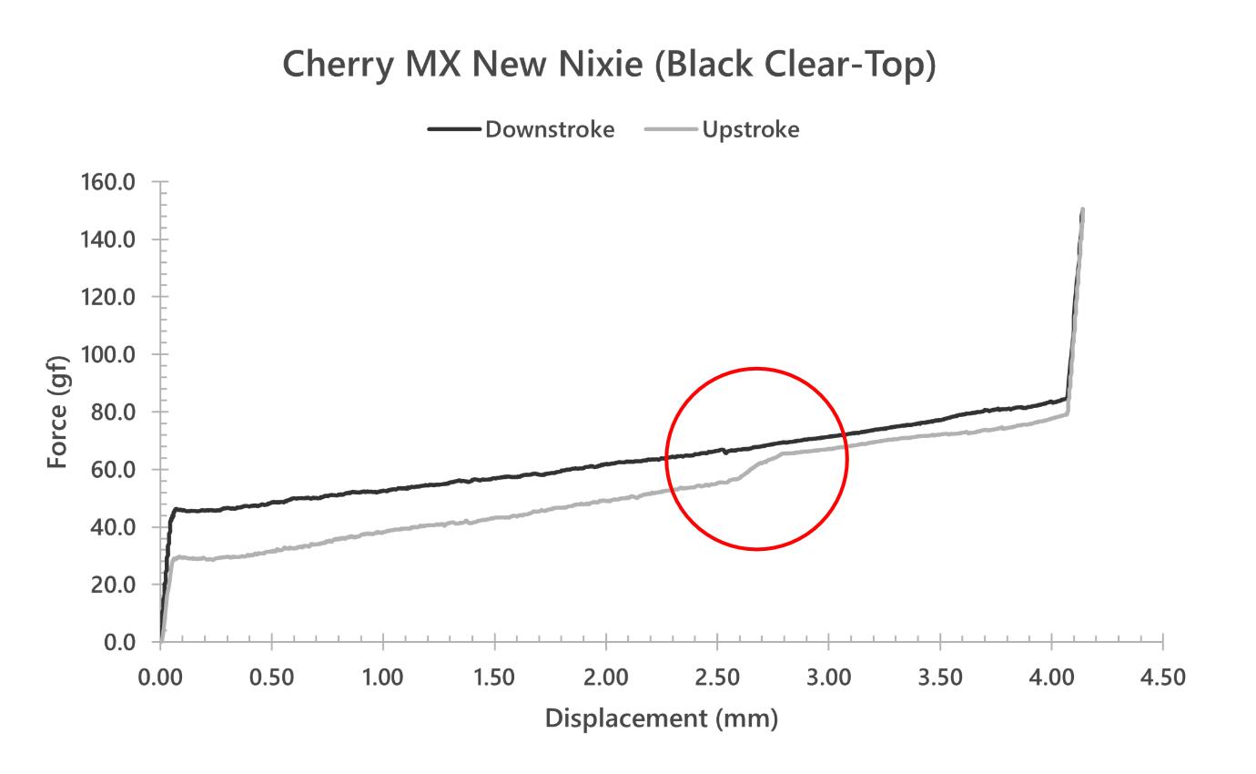

Knuckling Effect?
I think there maybe something different about Cherry linear switches, especially the New Nixies that hasn’t been noticed before.
Lately, I’ve been trying CannonKeys ‘Super Long’ 23mm springs in various switches. Usually this spring only adds extra weight at the top but, with New Nixies, I noticed a relatively sudden end of cliff like feel near the bottom. It’s similar to the knuckling feel I described before in some frankenswitches before. Similar to buckling spring feel except not as strong. The feel is strongest when top of a key surface is pressed slowly.
Cherry Black and Reds also exhibited similar feel except not as sharp and more difficult to notice.
At first I thought all switches with full key travel but all the non-Cherry linear switches I tried didn’t. If you have 23mm springs and New Nixies (don’t know about MX2A variant), please try the combo and share the result.
UPDATE: I think this circled area may be behind it except it’s happening on the downstroke with CK Super Longs and more pronounced.
UPDATE2: Now I’m thinking about ways to produce the same effect by design. Maybe adding a slope to top of the stem legs which should reduce resistance against contact leaf suddenly after activation. So the lines in the circle in the force graph would actually cross each other. Fun stuff to think about. :slight_smile:
