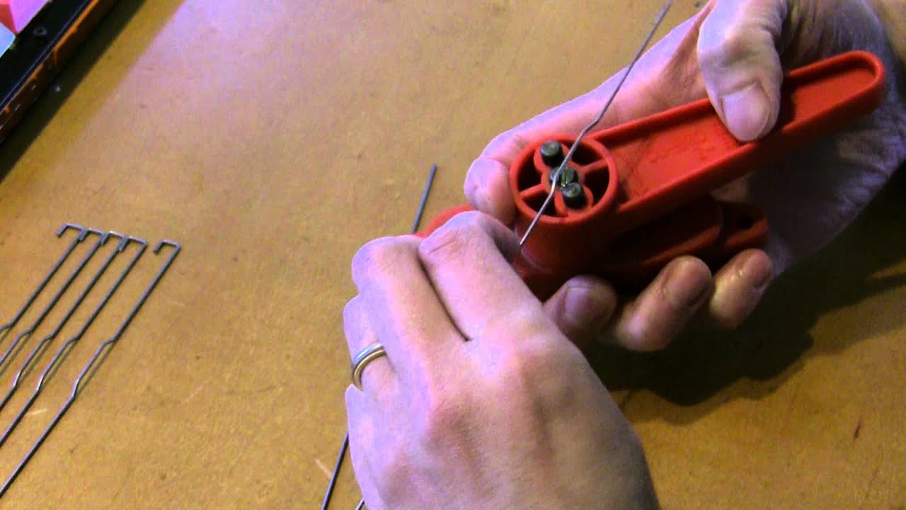

Y’all talking about receiving bent stabilizers while back in they day we were working out how exactly to bend stabilizers ![]()

So far my solution for that is digging around for a straight one - I definitely don’t have the straightening thing down yet. I plan to either get some plastic syringes like :3ildcat’s, or maybe some of those rubber-coated pliers.
Edit: @Manofinterests ha, that’s rad! I didn’t know those little wire benders existed but I guess that makes total sense. Definitely could have used one of those a time or two!
When I built my Blackheart 101, I spent two days trying to make a spacebar stabilizer wire with one of those benders. I hate it.
What was the wire that you used? Like a coat hanger?
Hobby store wire. Close in gauge to original but not perfect. I took stabilizers to the store with me to test diameter. It’s way too expensive which makes the process all that less enjoyable.
I honestly don’t remember what gauge I used. It was not a pleasant experience and I’ve tried to forget it. Ha.
