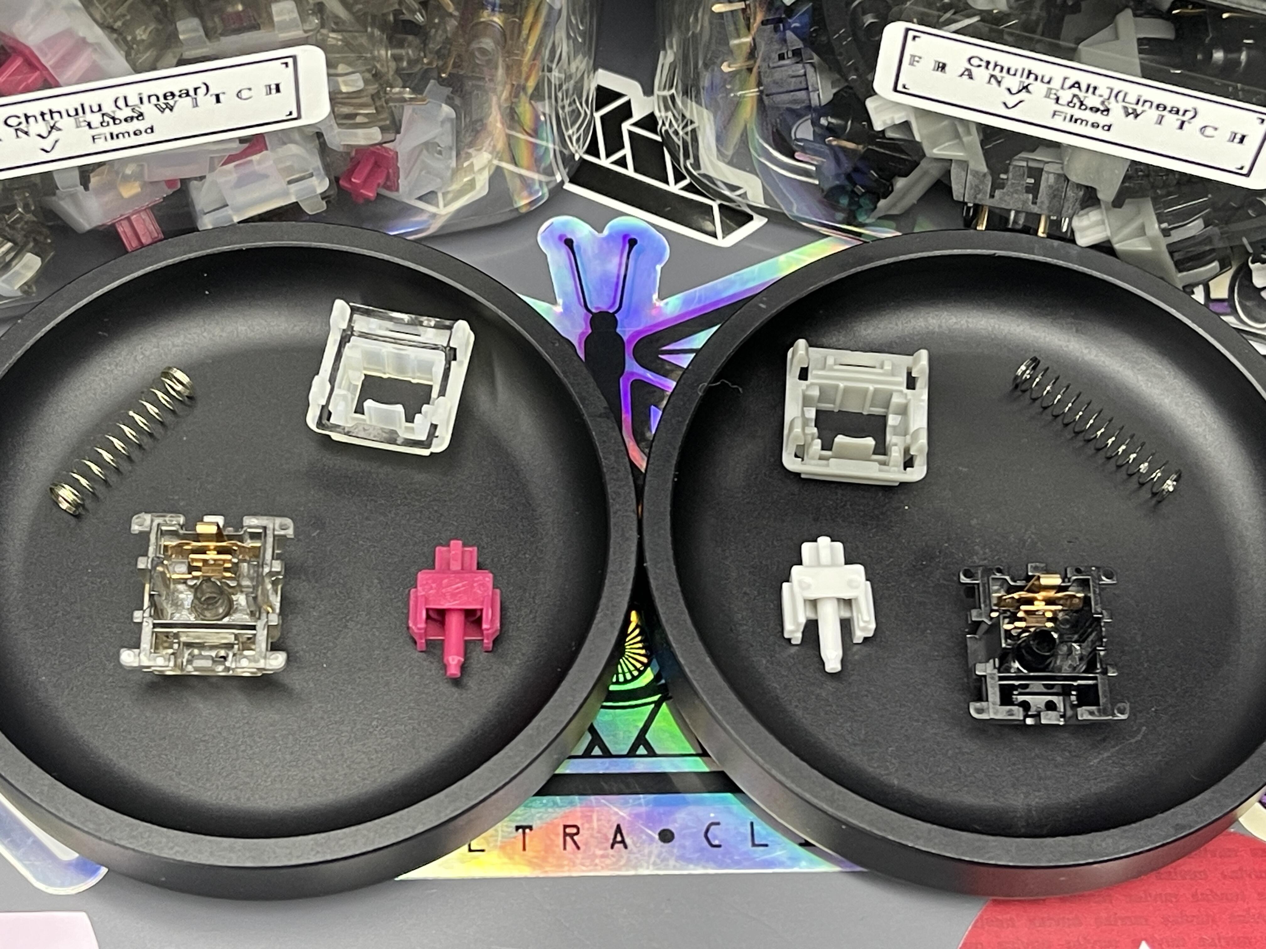

I picked some up, but immediately ended up turning them into Frankenswitches by just pulling the UHMWPE stem and tossed in som Geon Cloud long-pole POM stems.
I couldn’t even tell you how the stem wobble compared to other UHMWPE stems.

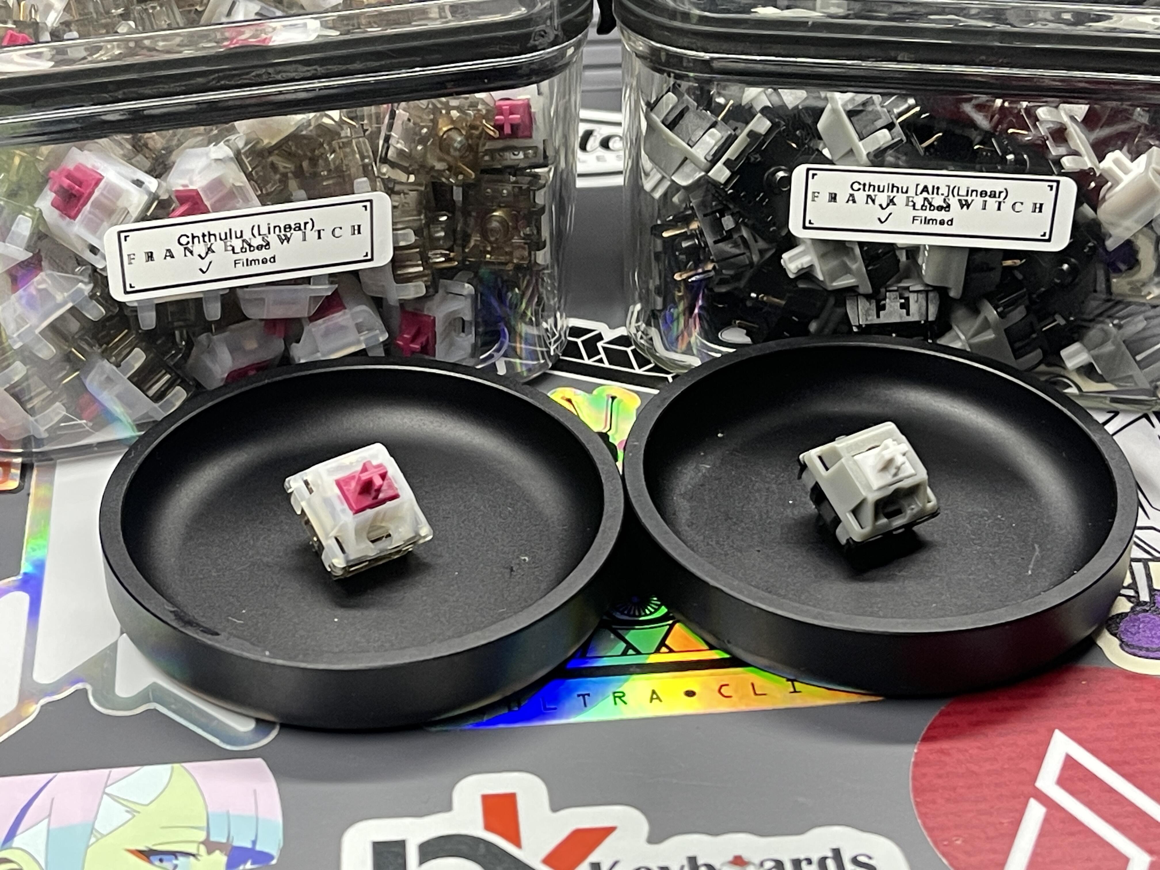

(Side-by-side with my Cthulhus)
P.S. - This photo taken before the new switches were lubed and filmed
How does the UHMknown Chthulu-ish frankenswitch sound compared to presumably Black Ink-based Chthulu?
I’ll have to check when I am home, but if I recall, it was closer to my Gateron Cream Sodas than it was to the Kailh Burgundy stemmed Cthulhus. That is to say it was a little higher pitched, but not as loud as the bottom out on the Kailh-stemmed Cthulhus. With the Geon Cloud sliders, they also didn’t require long-pole stabilizers like the Kailh Cthulhus do either.

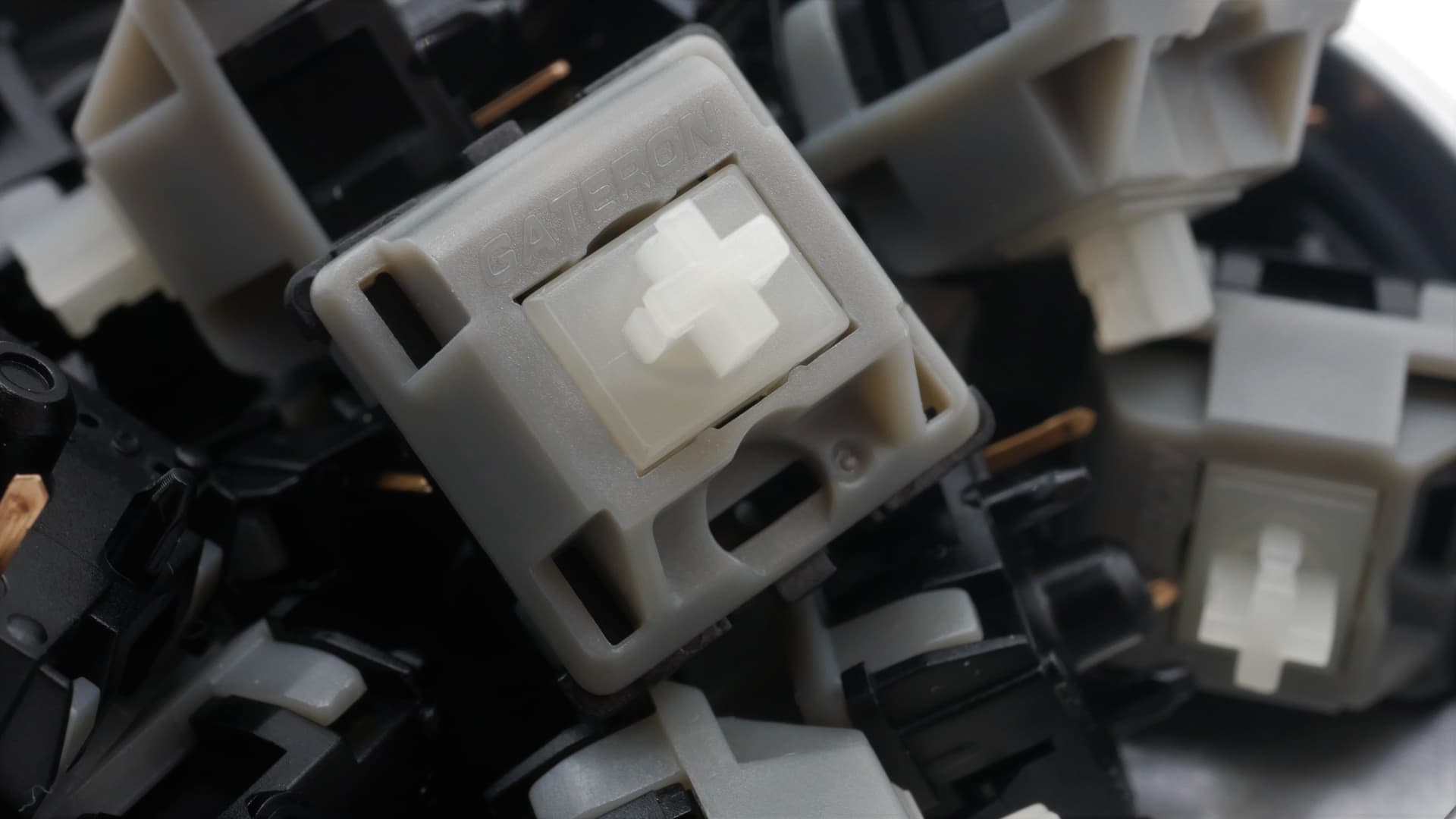

The UHMknowns have an Ink bottom and an “opaque” nylon PA66 top housing which is what is used on their milky top switches as well.
Not translucent like the milky tops, but definitely pass some light as seen from @ThereminGoat’s pic from his review.

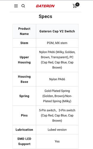

Gateron states on their site that nylon PA66 is the same material that is used in making their Cap V2 switches, so I am rolling with that assumption that they have Gateron Milky(-ish) tops, Ink bottoms, and long-pole POM stems (sliders).
