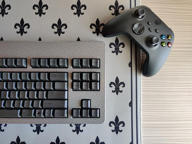

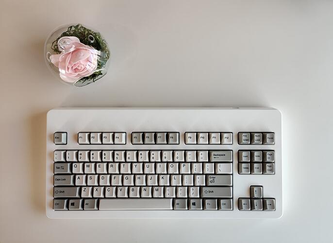

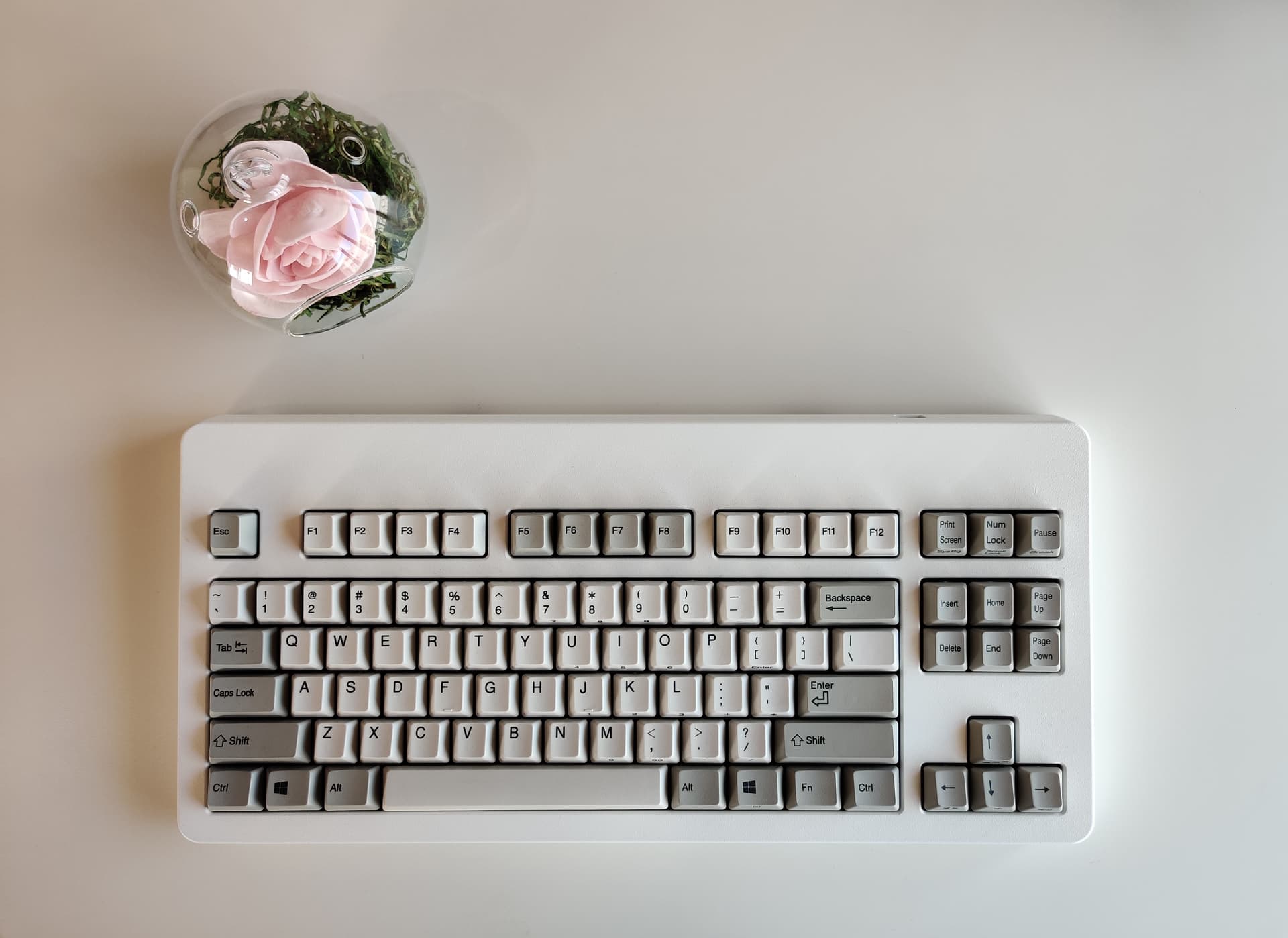

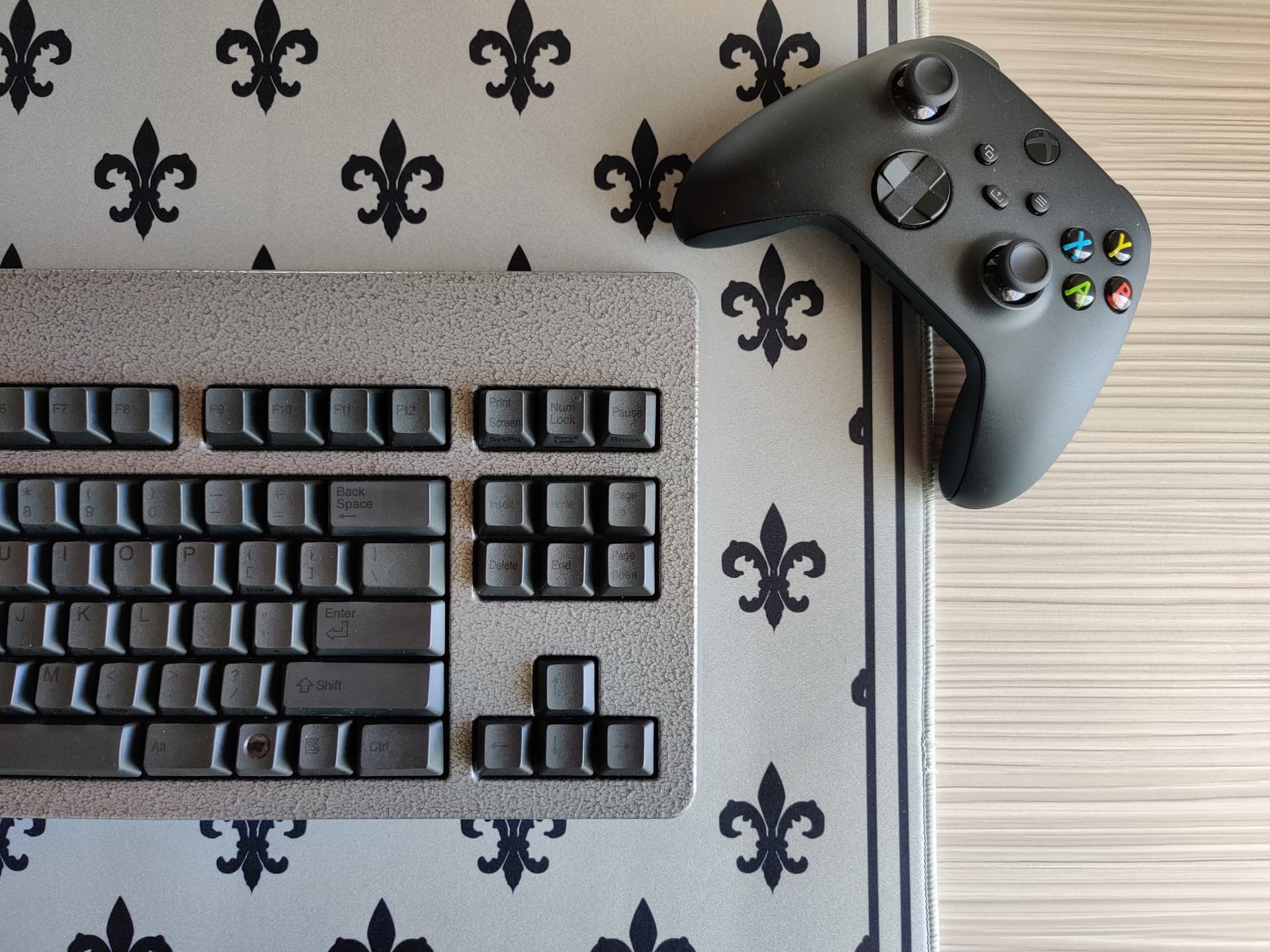

I was in a photo shooting mood yesterday.
Reimagine of the “Designs in time, future and past.” video in Ryan’s YT channel:
Work and fun together:

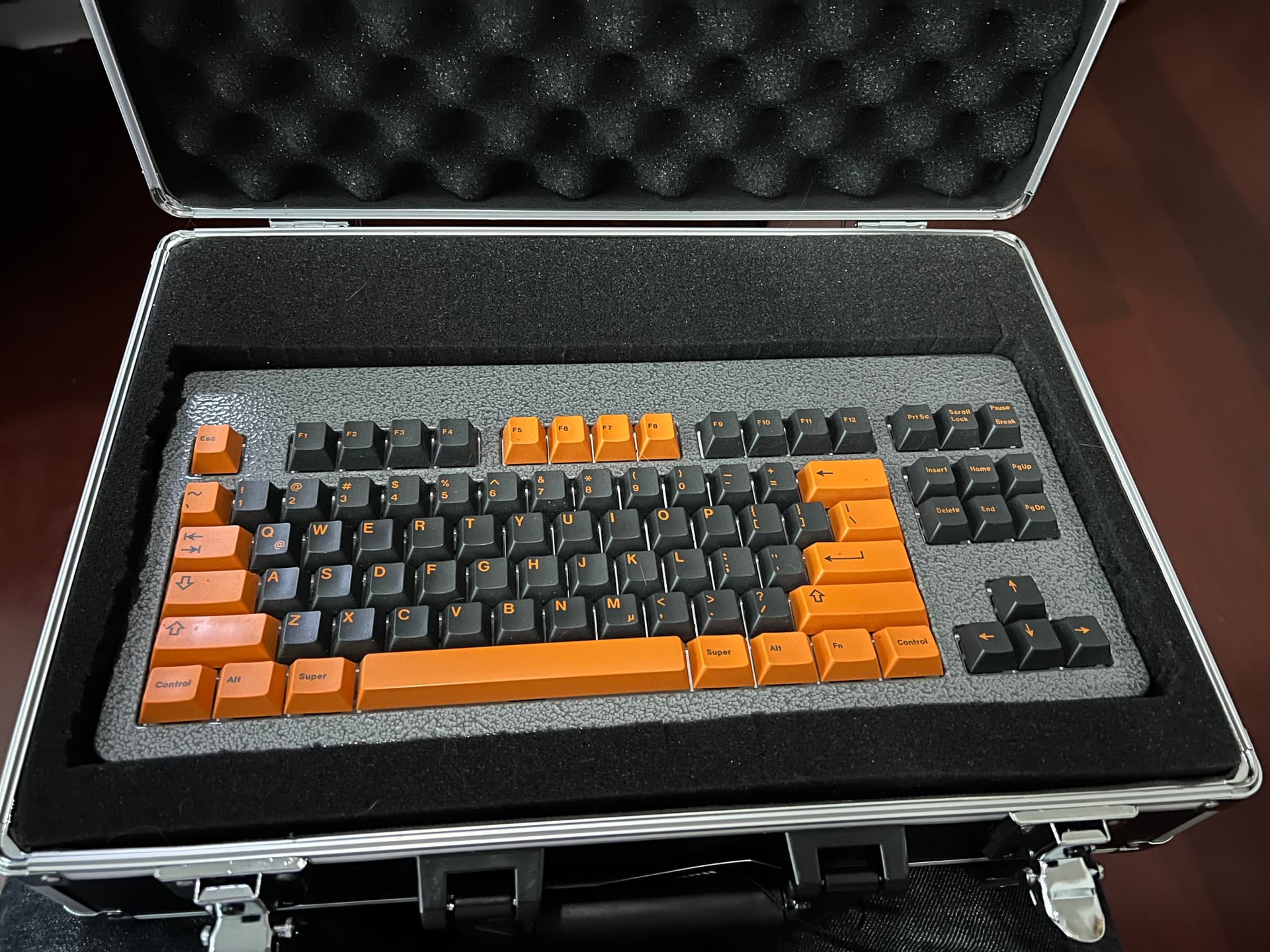

Anybody know any hard travel cases that the Norbaforce II fits into?
I tried cannon keys’ case. It barely fit by deforming the case a bit. Hoping to find something better. Too big of a case is not a problem - got a lot of foam left over from the cannon keys case.
let me know if you find something. I just tried and I can fit it in my TX-large bag with only 1 foam ring around the top/bottom edges. It’s tight, but it works. But I haven’t seen a large TX bag in stock in years.
More than I wanted to spend, but this aluminum case works. Had to cut away a little extra pluck foam on the sides. I’m sure most of y’all can cut more neatly than I.
