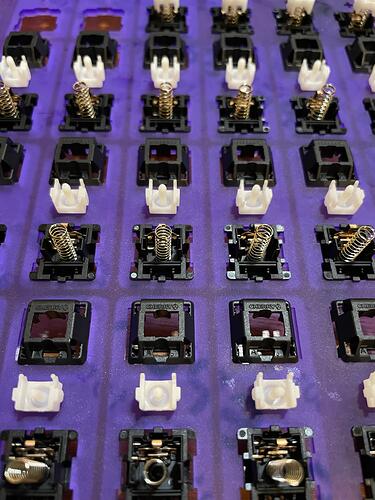

Technically the only other early switch that has been forgotten about were the original “panda” switch, which was a mx black spring inside a mx clear switch. This would lead to early switch experimentation that had people using mx blue/red springs in mx clears. They would quickly realize that many of the switches wouldn’t return due to the leaf of the mx clear. This was resolved with
A - switch lubing and using it
B - getting customized spring weight
and then the rest is history as we know it

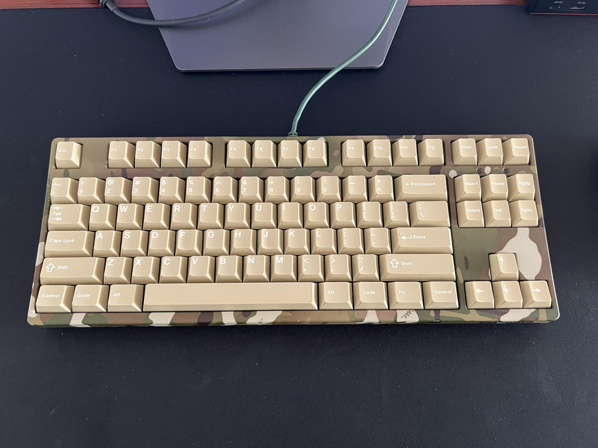

Finally completed my “classic” camo Filco. Upgraded switches to HG Cherry Blacks, lubed/filmed with 70g long TX springs. Also managed to find a Pegasus controller and GMK Sandstorm. Credit to LightningXI for the inspiration.
