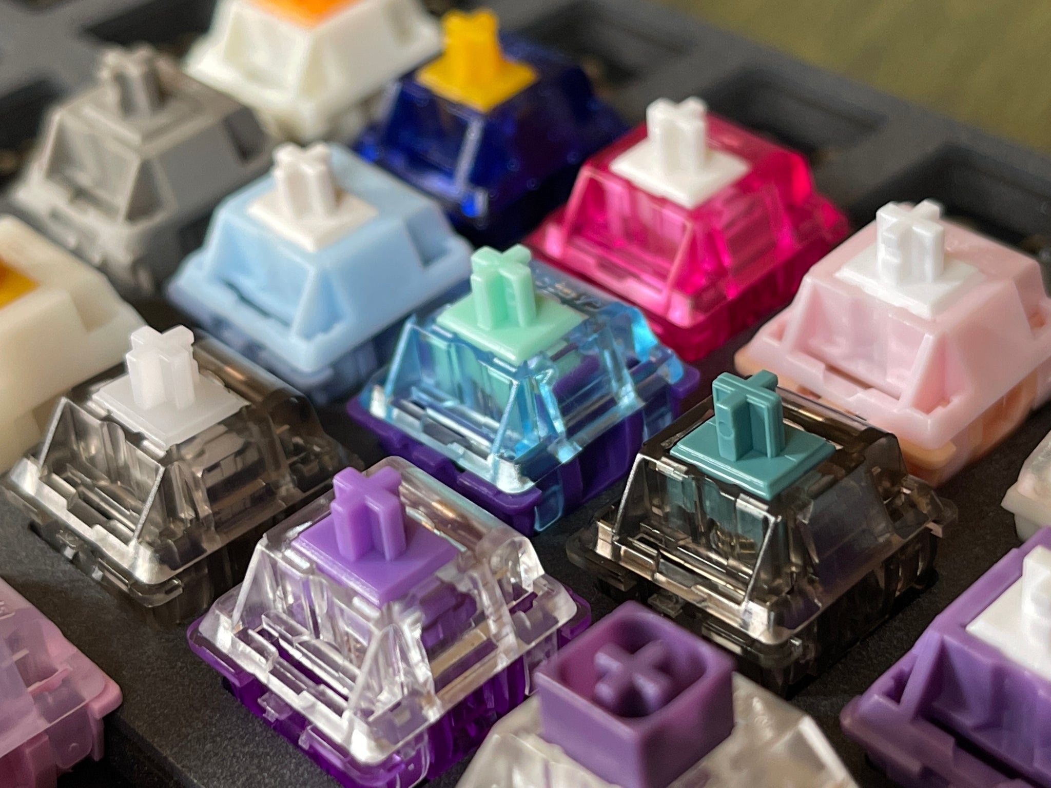

Tactile switches do give varying levels of feedback, which is ergonomic. Not all tactiles are created equal, and that includes sound. Some of the quieter regular tactiles might be Durock Medium Tactile, SP Star Magic Girl (Dark), KTT Mallo, Gateron G Pro Brown 3.0, maybe Zealio V1R.
Most of those require some level of hand-lube for optimum sound.
You’ll want to avoid long-pole switches, if you’re trying to reduce distracting noise. The Aflion tactiles, like Blueberry Chiffon V2 and Aflion Melody are less offensive in that regard. In fact, you might want to sample a few, as the factory-lubed variants are pretty-much ready-to-go.
From what I’ve read, the Monsgeek boards are good for modders. The M-series may require more assembly than Keychrons. But they are tunable in terms of sound and such. I find their full-size to be very appealing.
You might also be interested in semi-dampened switches like Kailh BOX Mute Jade, TTC Bluish White, and Boba U4Tx. They have some dampening to reduce certain loud noises, but not completely. So they are quieter than non-silenced, but not as mushy as full-silenced.
In terms of keycaps, I find thick Cherry-profile PBT [even the cheapest] to produce less-distracting sounds. Another good option [with light-tactiles] might be DCS-profile, if you can get it. It is a deeper-sounding Cherry ABS. However, I find GMK and some other Cherry-profile ABS to be high-pitched and distracting.
Anyway, sounds like you’re doing the right thing, testing. You can pick up an M5 later. Maybe a simpler keyboard like the Alpha 108 is better for your needs, right now. It seems to come already-assembled. And replacing those stabilizers is not that difficult.
Perhaps the smart move is to pick up the M5, if you can get a discount price on it, and build it later. And use any other keyboard, including the Alpha 108, in the interim.
You may wish to pick up some SP Star switches [any kind], as they tend to be non-outrageous. Cannonkeys and Hippokeys offer switch sample packs:

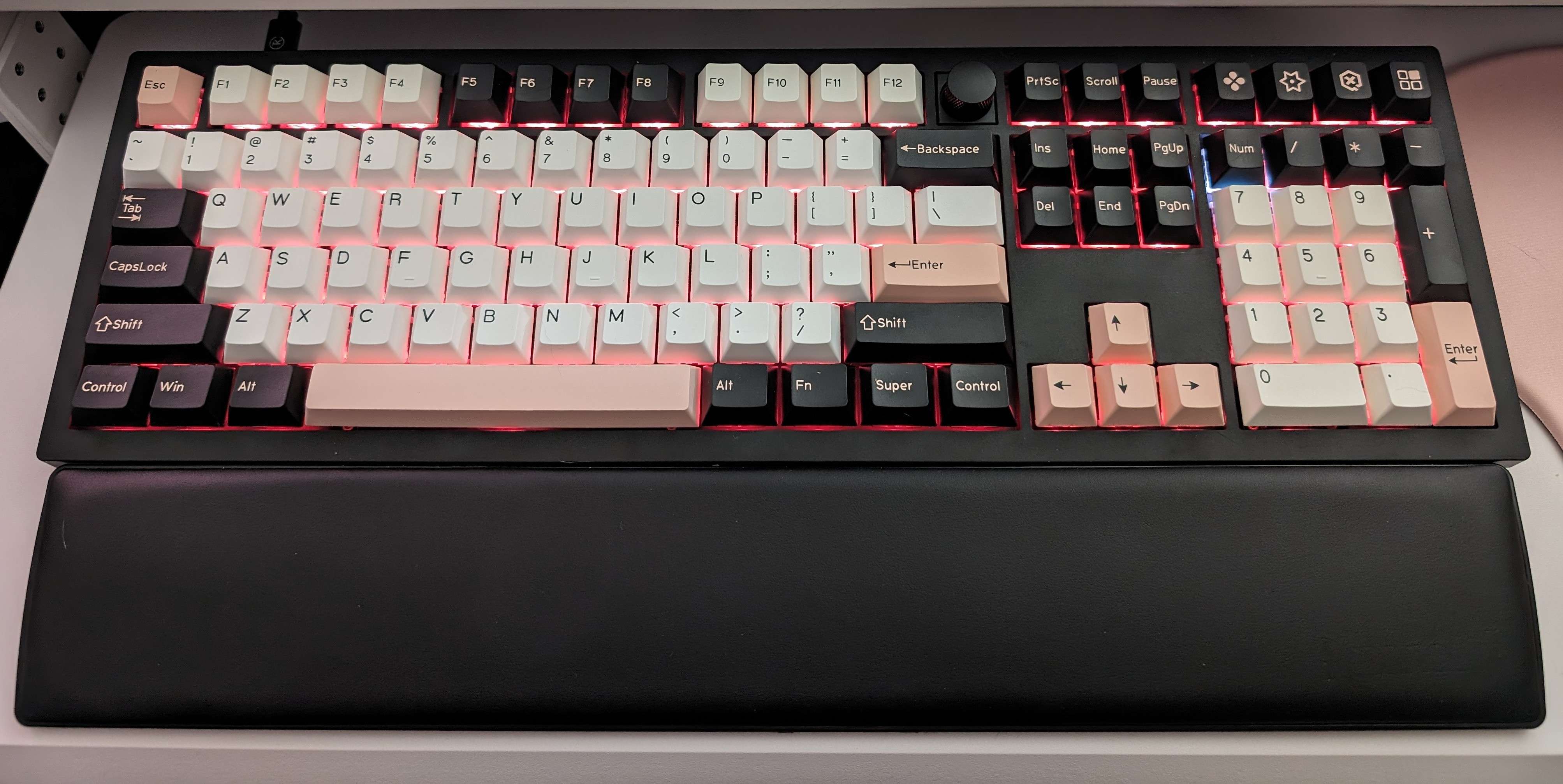

The Keychron V6 came today. I took out all the stock switches and keycaps and put in the Gateron G Silver Pros I’ve been playing with (I have the browns as I thought that’s what I’d really like, but I think the silvers are quieter). I also have a set of Double-Shot PBT keycaps (MSA profile) on and it seems decent.
1 small issue: I don’t think I like the southern LED. I have a set of pudding keycaps I thought I really liked, but the shine through legend is top oriented. So now I can’t read the letters at all. So - that’s a problem, especially since both keychrons and the M5 are all southern LED.
I def need the full size, I’m already happier and returning the 96% boards. The Q6 should be here this weekend. Now I’m really considering the Alpha 108 since it has northern LED, the light shining through the bottom row on the V6 is stupid bright.
I ordered the Kailh BOX Mute Jade (thanks @HungerMechanic for the rec).
It’s less universal now, but Cherry profile keycaps don’t fit well on many switch housings when they’re installed north-facing. Since Cherry profile is well liked in the hobby, and shine-through keycaps less so, south-facing is the default for many enthusiast boards. You’ll need new keycaps to fully take advantage of shine-through, and there was a thread on here just the other about how limited the options are for getting good results with south-facing LEDs.
Yes, it’s true. Pudding keycaps don’t do so great with south-facing LEDs.
But, as wjrii said, south-facing LEDs are more compatible with Cherry-profile keycaps.
The quality of most pudding keycaps is seen as lacking, in any case, usually being not as thick or having a good texture as compared with other keycaps.
On forums like this one, they’re just not prioritized, for better or for worse.
Glad that you found the Mute Jade interesting enough to order. They are not actually as tactile as the unmuted Jades, but that’s probably a good thing. They’re a more restrained switch, all-in-all.
It might be best to use the pudding keycaps with the Alpha 108, and anything else with the V6 / Q6. That might be the best of all worlds.

On the subject of keyboards, it’s very interesting that you like the V6 better.
I keep considering it, because it is light [and affordable.] I don’t like the idea of an alum. plate that it allegedly ships with. But I can make do, I guess.
If you already have a V6, I see no need at this time to go for the Alpha 108 [except for better RGB with transparent keycaps].
With light tactiles, an aluminium plate gives a sound that is an acquired taste. I prefer polycarb/POM, as they are deeper and less clangy. Hopefully yours came with some plates.
In terms of switches that are crisp like clickies, but not as loud, there are many options that are less-loud that BOX Jades.
Even the BOX Whites are a little quieter, the V1 were great. Basically the ‘MX Brown’ of clickies, without the overpowered click bar of the Jades and Navies.
But you’ll want something quieter than a pure clicky switch.
For crisp switches that are quieter than a clicky, the classic option was a Kailh Speed Copper. These are very controversial switches. Because they are basically an MX Brown, except the bump is right at the top and is crisp. So once it is depressed, it is a short linear journey towards bottom-out.
But if you could type on such light switches, they were very fast. But barely quieter than a clicky.
So you might look at something dampened or semi-dampened.
One of the closest tactiles to a clicky switch is the TTC Bluish White. I think it is dampened on the (down)stroke? A silicone-muted bottom, I think? It is very punchy, authoritative switch and is semi-quiet. There is something called the Silent Bluish White, that should be dampened on both upstroke and downstroke, that is still relatively crisp for a silent switch.
Another strong contender in that category are the U4Tx. They are U4T thock Boba, but partially-dampened. So they will give a crisp, loud bottom-out, but are muted on the upstroke. So they should be quieter than regular U4T, at least.
Then there are the actually-dampened switches that aren’t totally mushy. Like the Kailh Midnight Pro (tactile) and Kailh Deep Sea Whale. They are office-quiet, kind of snappy, but not completely mushy. The Whale is more tactile. (TTC Silent Brown V2 is a fairly-crisp top-mounted silent tactile, but is more relaxed and easygoing than those Kailh switches.)
The WS Silent Tactile and Zilent V2 are very snappy, even if they are somewhat mushy on the bottom. They are office-quiet and are generally pretty punchy.
Then there are the snappy, unsilenced light-tactiles. For example, the newer Gateron oil Mini I is barely more tactile than MX Brown. But it produces a very snappy and clean sound, and is very crisp, because it is a long-pole with smooth molds. The new WS Light Tactile is similar, but almost a medium-tactile.
If Gateron made a semi-silenced Baby Kangaroo, that would also fit your needs.
So it is best to maybe start with the TTC Blush White / Silent Bluish White, and maybe some U4Tx if you can pick up samples. Just about everything I mentioned above will give you a different experience from a regular Cherry tactile, and should be varying degrees of crispness and quietness.
Incidentally, I am typing on Zealio V1R with 14mm TX springs. If you use 60-62 G 14mm springs with these, they are like crisper, somewhat heavier MX Browns, these are almost ‘clicky’ in feel, and quieter than BOX Jades. They’re not nearly as quiet as the aforementioned Kailh and TTC dampened switches, however.

I’ve landed on the V6, with Gateron silvers (very quiet and creamy, just the spacebar has a bit of a thud) with a solid cherry profile PBT double shot keycap. The shine through/pudding keycaps ended up being too hard to read in lower level light regardless of light choice.
The cherry profile keycap is easier to type on than some of the thicker round tops and without the tactile click it helps me know when I leave a key.
