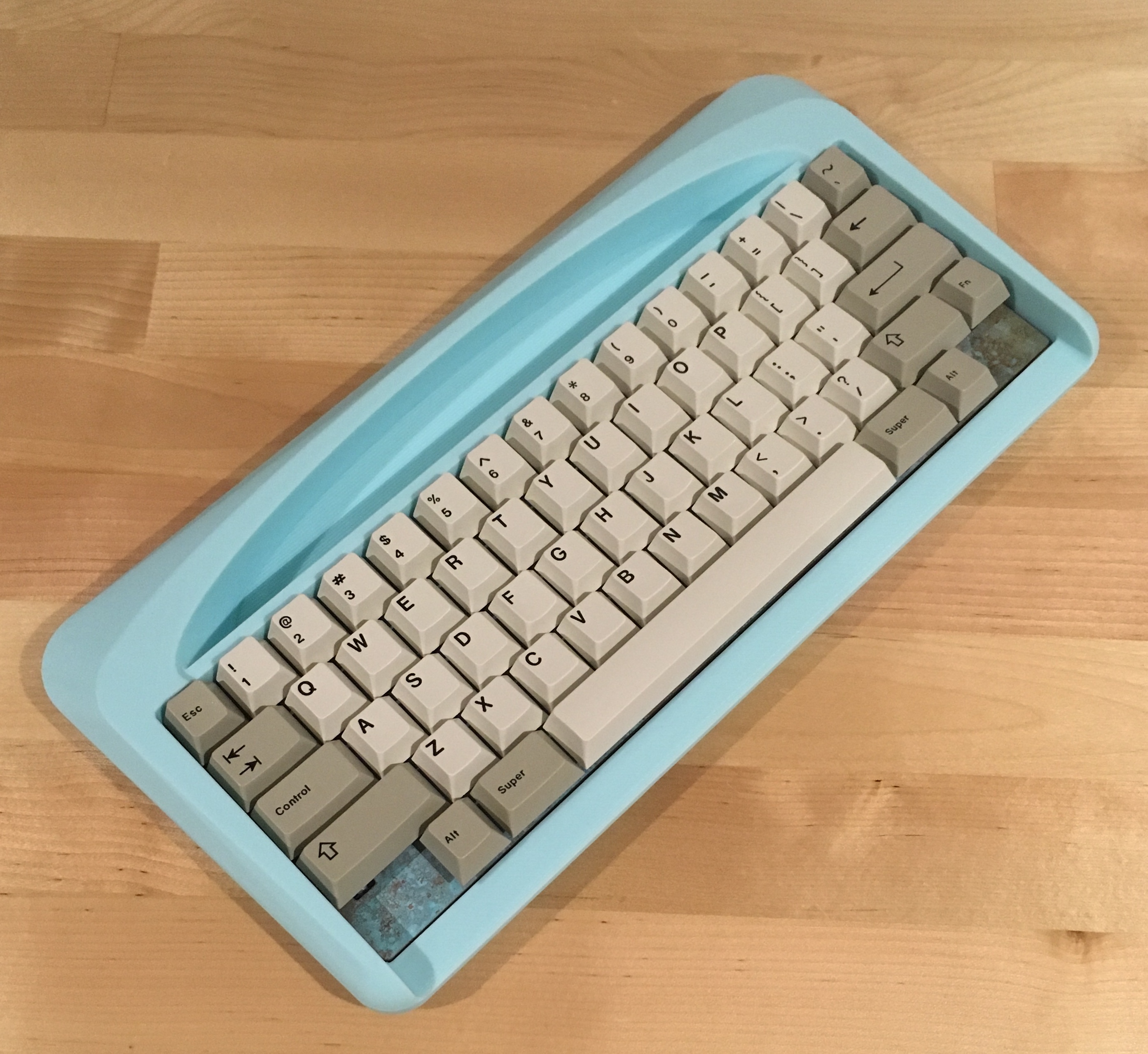

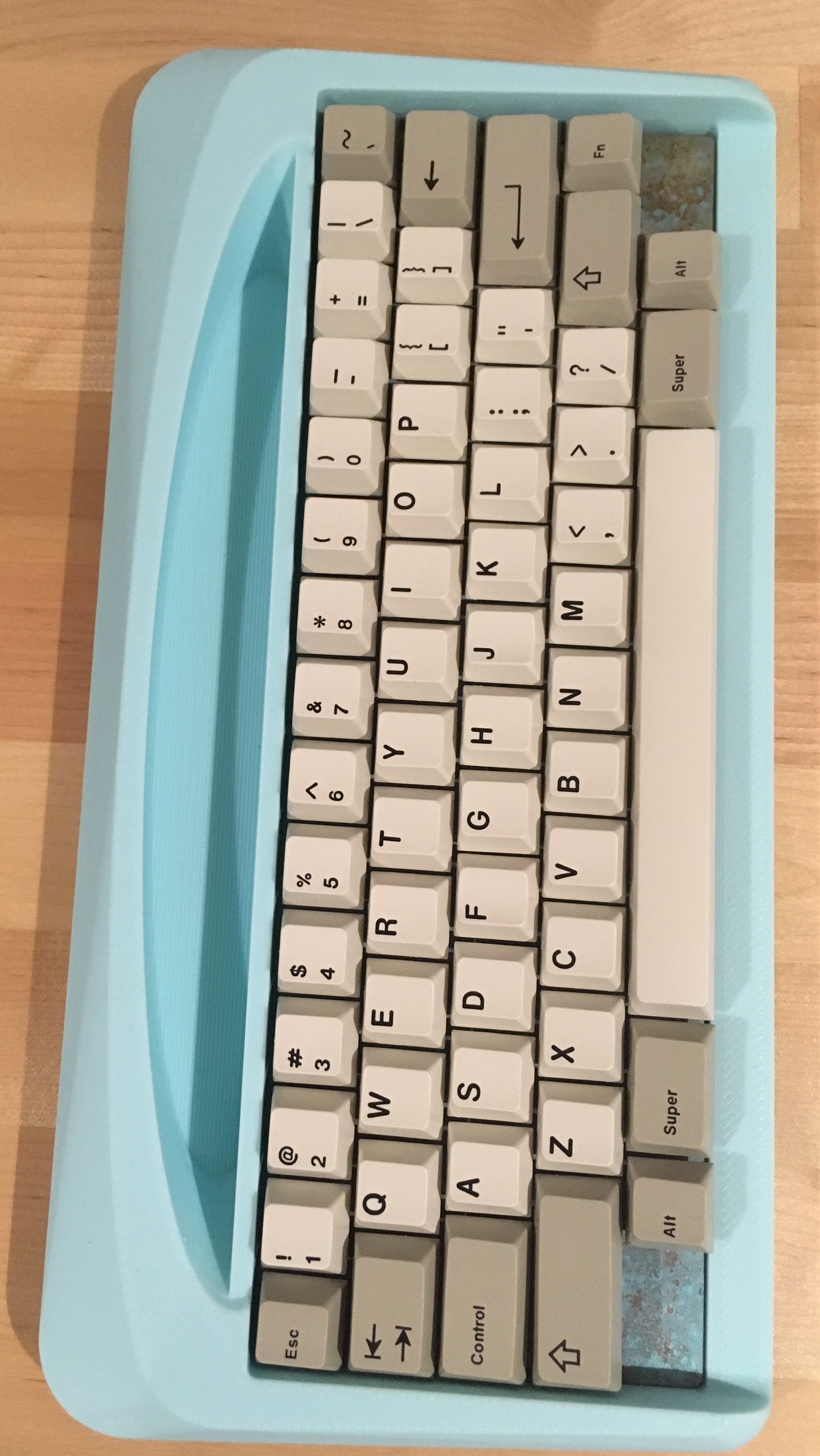

Mint Corona Case with GMK 9009 in a HHKB layout with a verdigris patina brass plate and Hako Royal Trues.
This case is actually 27mm tall - the final version will be either 23mm or 24mm tall.

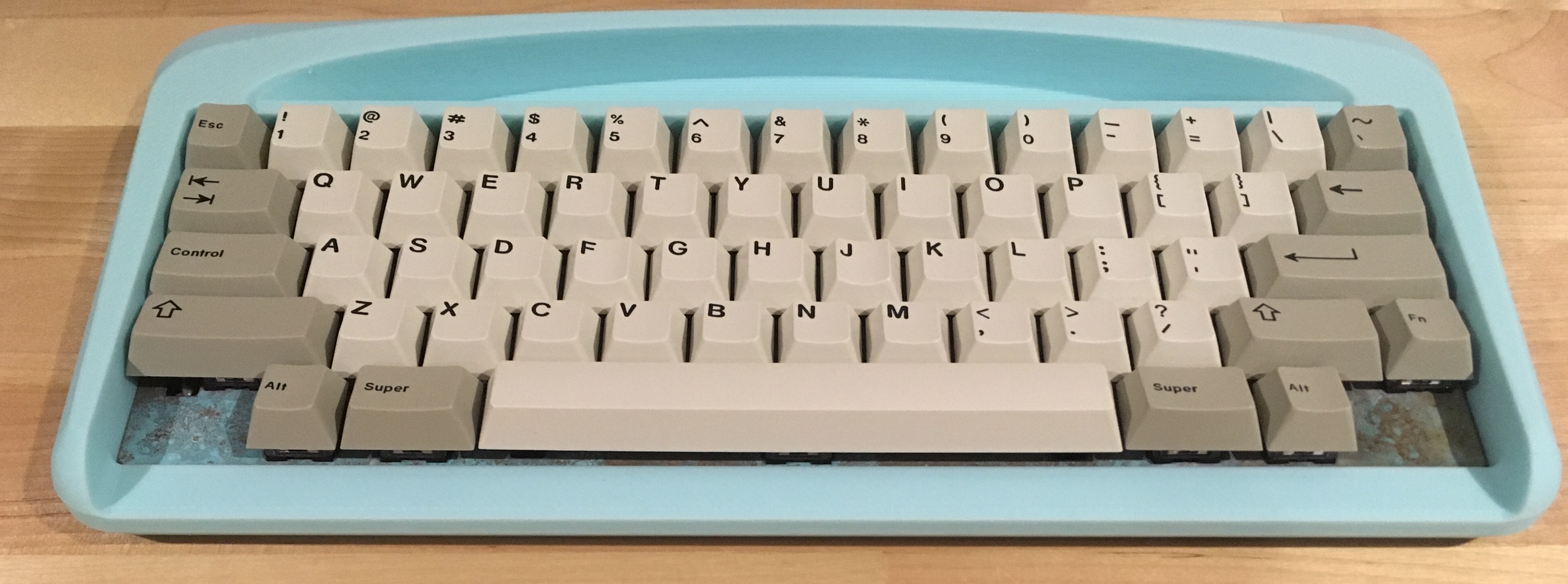

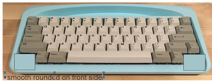

I like the curves on this!. I’m not sure how it would look, but maybe having the HHKB blockers integrated with the case would look a bit more… filled out?
I don’t actually know how to draw my intentions well. But the nice rounded corners in the front right at you? If those extended intwards to cover the HHKB blocked portion. I hope I’m making some sense
That is so weird. I love it!
always impressed with your 3d printed cases, keep it up!

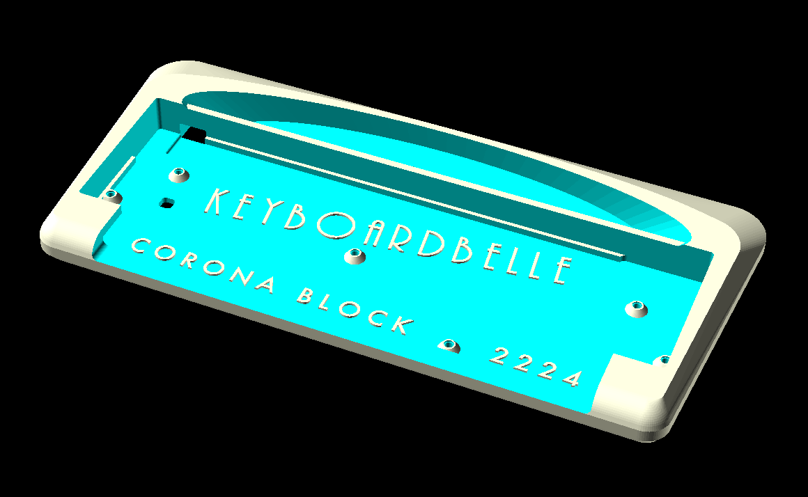

I’ll definitely make a version of that. I made a few HHKB style Iconic cases (basically Apple M0110s), so it’s a bit of support material underneath and you can wedge the PCB and plate under the blocks to hide it.
I also already had the plate patina done, so I was trying to find a place to use it where you could easily see the corners. I probably should’ve gone with SA keycaps for more of a typewriter look, but I don’t have an SA sets with a 7u spacebar.
One gripe I have about HHKB layout, is I wish it would take 1.25u from each side of the PCB so it would work with more of a standard 60% layout - so perhaps I’ll get a GH60 and prototype a 1.25u block case out of this. It would also make it a bit easier to buy keycaps for.

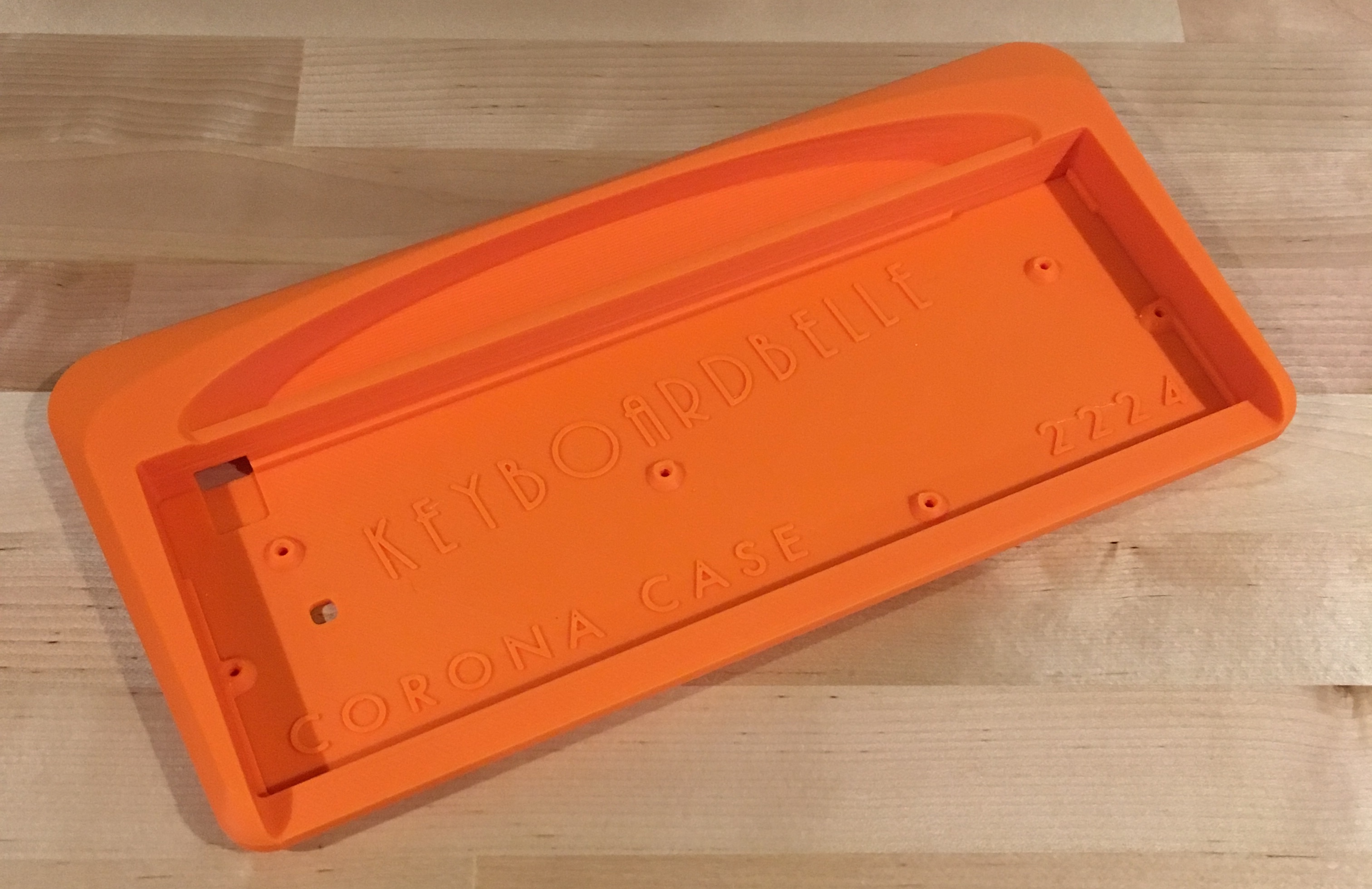

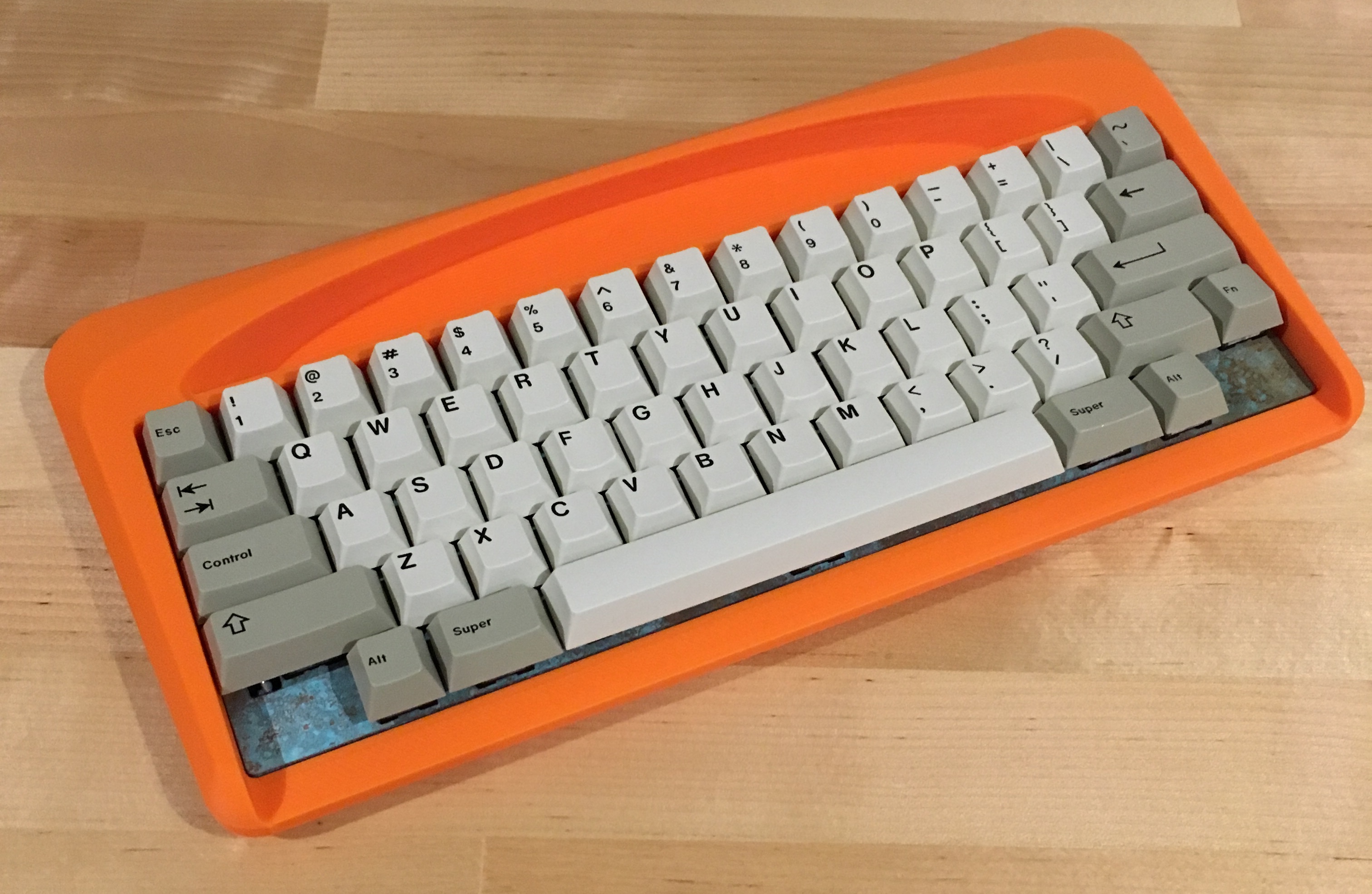

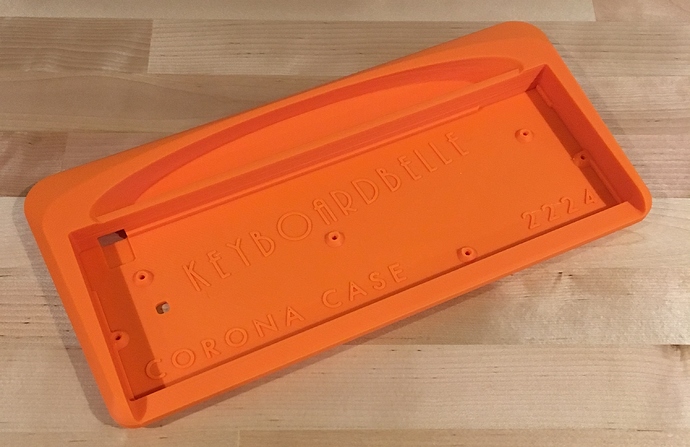

Edit Here’s an orange in 2224 style (so 24mm instead of 27mm) with the same PCB and keycaps - the verdigris plate patina has a nice contrast to the orange plastic.

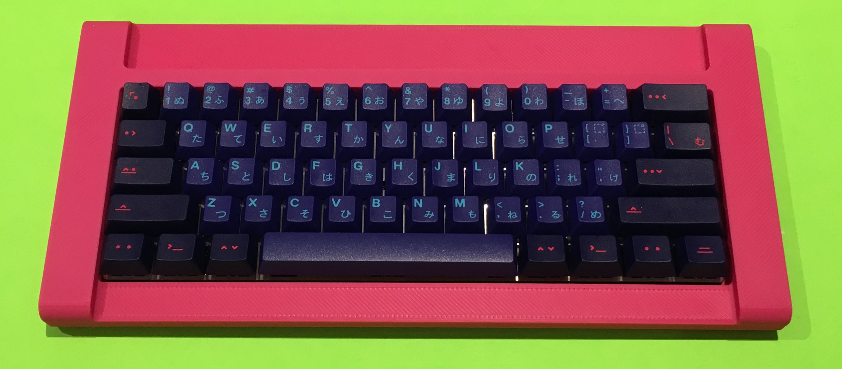

Also, entirely unrelated, the last photo is Cassette Futura in hot pink with GMK Laser
Standard 60%, just skip the 1.25u outer edge keys and you should be able to slide the PCB and plate right under these two side blocks. I still need to put a small radius on the block corners though. 3D printed supports tend to mar the surface underneath, but are hidden under the blocks, so it looks clean when assembled.
