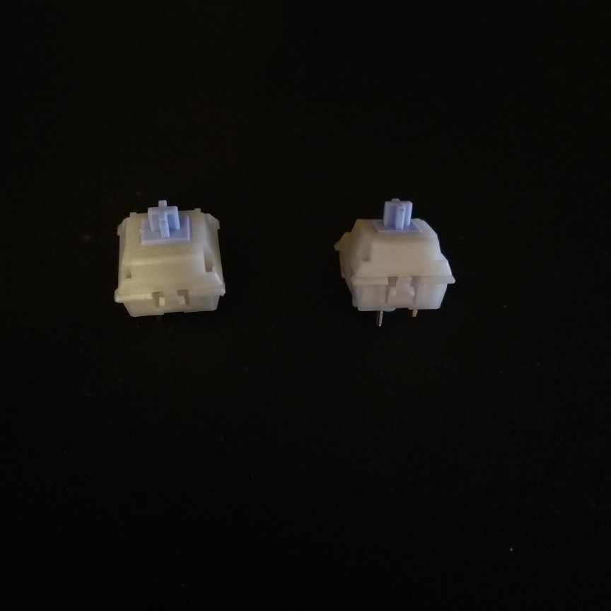

Can confirm that Polias can be used to make ordinary Holy Blue Bobas:
These are 68 G Progressive. More tactile than I need, but it’s good to know I can make them. Seem to be regular Holy Bobas, as far as I understand them.
The leftover Polia housings I used to make two 63.5 G [Spirit] Silent Sky Polias. Testing them against 60 G Silent Sky stems in TTC Gold Brown V2 housings, the Golden Skies seemed to be a little smoother, quieter, and lower-pitched.
I think TTC Gold Brown V2 may be a better basis for building Silent Sky stems than Halo True / Polia. The latter just seem to be a little scratchier and seem to have more stuff going on inside them. Maybe it’s just the Spirit springs. The TTC housings are using TX 14mm.
