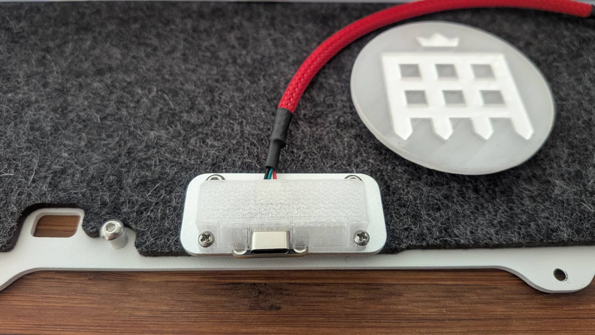

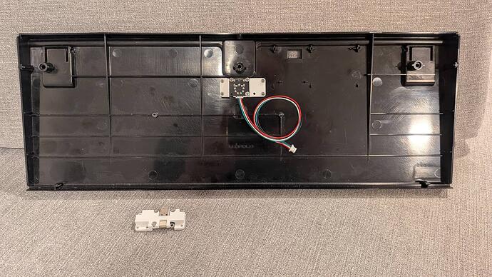

3d printed brackets to support the Unified Daughterboard (c series) in Leopold fc980, Norbauer Heavy 9 or Sho S98.
While I have enough USB-C daughterboards of my own type, and the EC980 pcb comes with one, incase parts break in the future these parts are more widely available.
Note it is a different bracket depending on the keyboard.
Leopold case
Heavy 9
