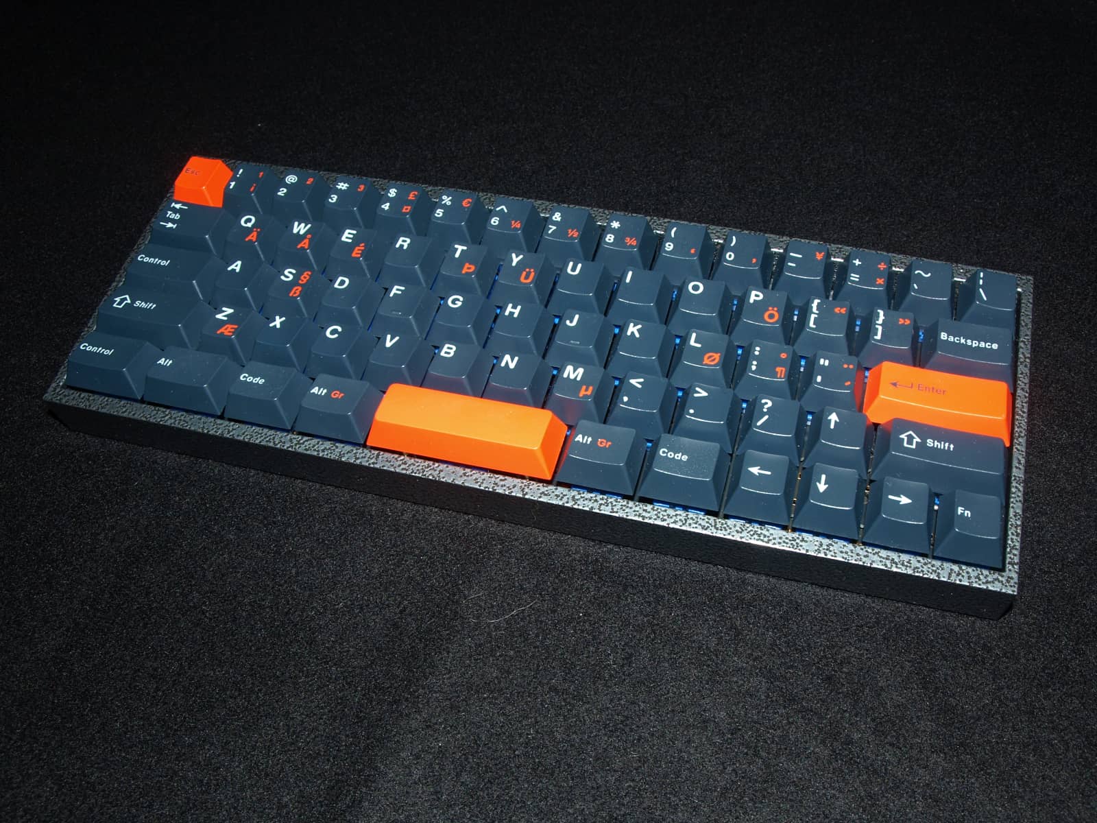

I used the PCB @wjrii linked to many times, and can recommend it.
Regrettably there are not that many minila-type PCBs available as they used to be a couple of years ago.
This picture of one of my boards uses the YMDK-PCB from the aforementioned link.
