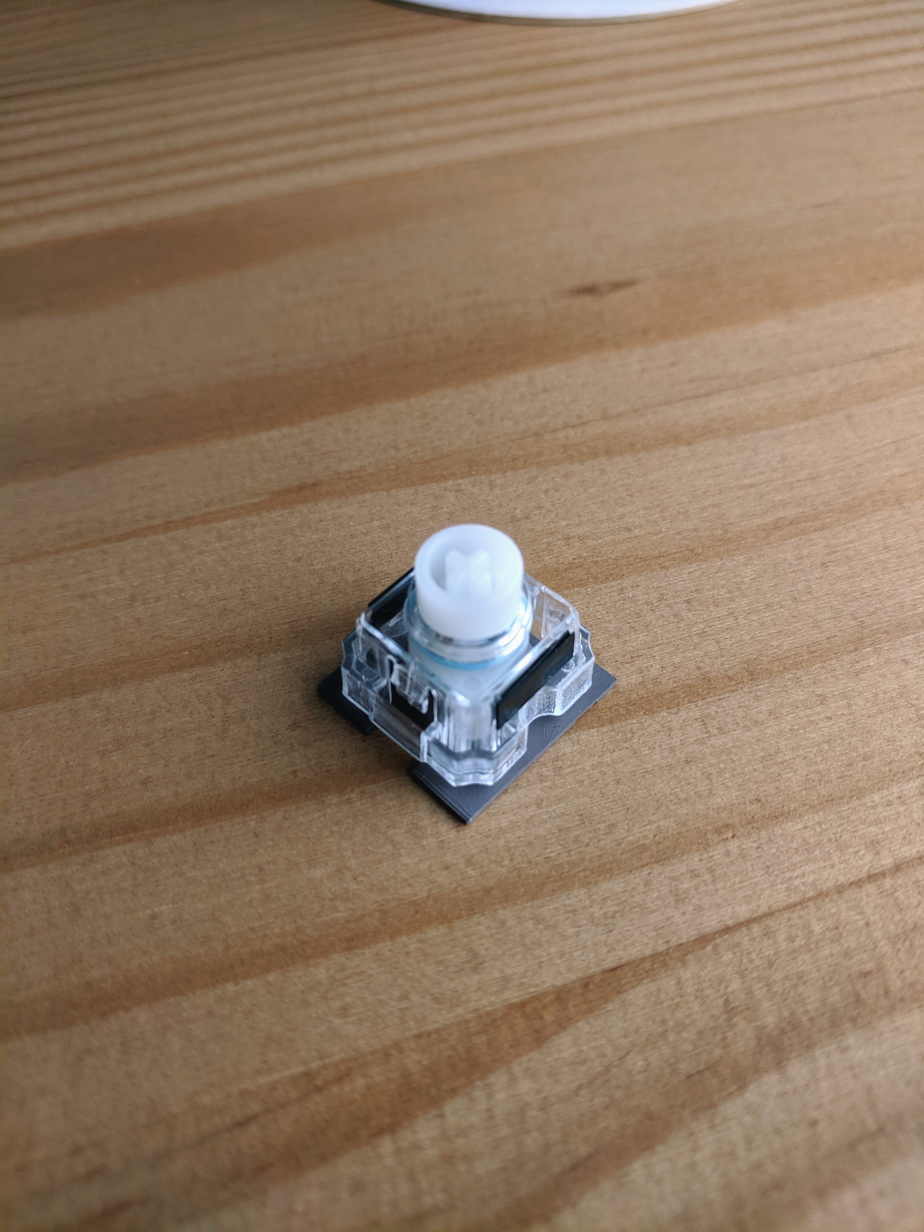

Just adding some additional notes to the conversation after Nebulant pointed me to this post.
The board above is mounted with the NIZ housings and NIZ sliders on all the 1u keys. I don’t seem to have a noticeable wobble or alignment issues when using the NIZ housing and stem combo. I stuck two pieces of electrical tape to both sides of the housings before mounting them to lock them in place, so now there’s no horizontal play at all.
I had some NT mounted too to test. Honestly, compared to NT sliders in stock housings, I think these NIZ MX sliders and housings feel really good if not better but only when you use them together.
I definitly agree that the total Niz package feels very good, even compared to stock.
I would love to see some pictures of your solution for the housing movement if possible. I haven’t pulled the trigger on these yet, but I’m really tempted to do so before I move my Realforce into a Norbaforce housing.
I’m also curious what sort of effect those silencing rings have on tactility. They look a bit thick.
For me, they reduced tactility slight due to starting just into the bump.
When I get my housings back I am going to install them in a full sized realforce without padding the sides, I feel as if the pressure on the plate from the PCB should keep things from moving around without laterally pushing on them quite hard.
I stuck two layers of electrical tape to both sides of the housing just to test the fit. And that added just enough padding that I could still slide the housing back into the plate without any problems and the housings are locked in place and centred so I didn’t bother with anything fancier. Probably one of the easiest mods you can do, it’ll just take a bit of time (I did about 70 housings while watching Netflix for two hours).
