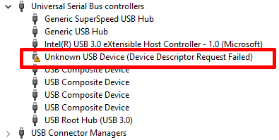

Hello!
I need help about flashing ps2avrGB board.
after finish flashing, there is no sound of usb unplug/plug.
if I physically unplug/plug the board, the usb is not recognized:
if I reflash with default firmware (from winkeyless.kr) the board works.
I have no problems with other 4 (same) boards I have.
have anyone encountered this problem before? :thinking:
maybe this specific board is faulty? :cry:
