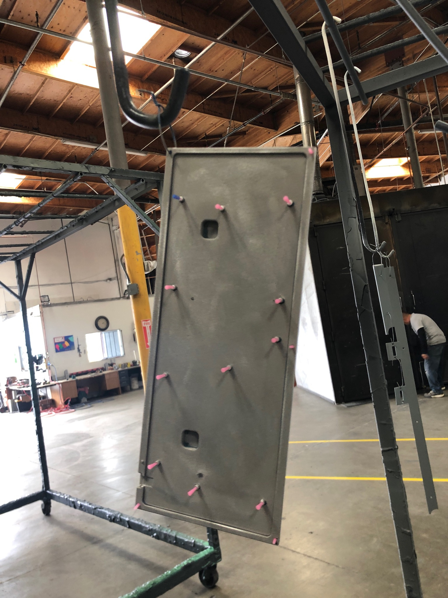

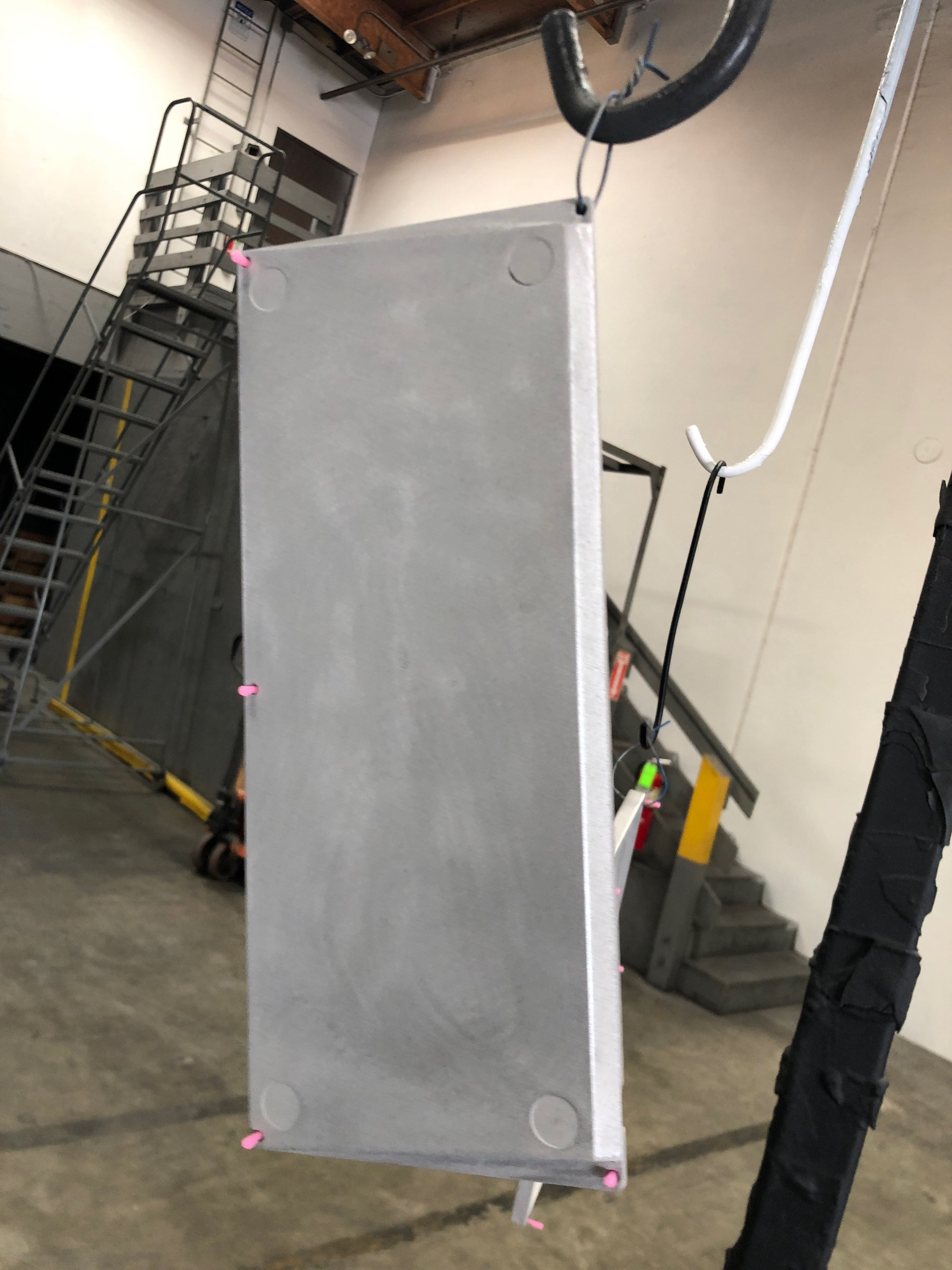

Curious, how do y’all handle complex geometries like USB port holes without getting excess powder build up? I know that could be a possible worry for some cases. Would there simply be a less consistent coating in those areas? Just wondering.
For any holes, they get plugged with silicone plugs similar to these:
Here is an example of the board being plugged:

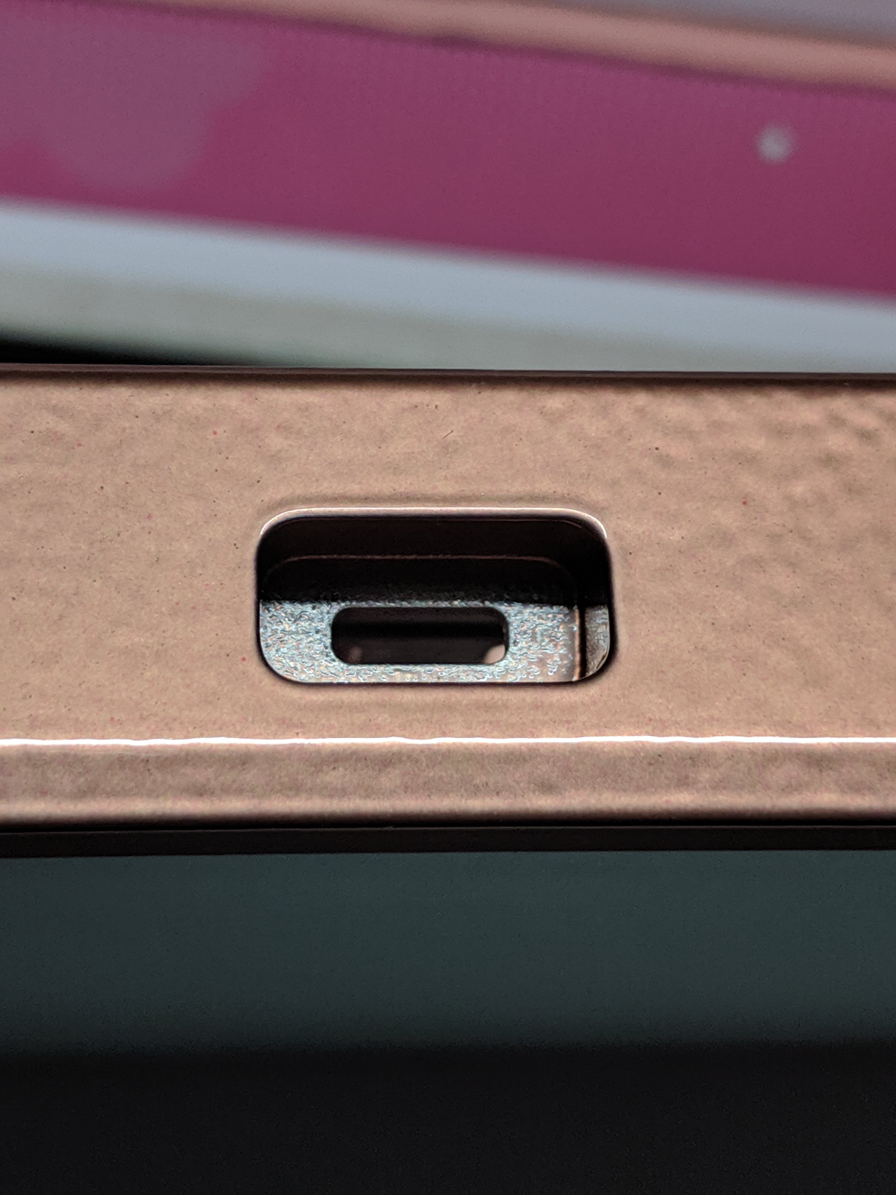

Sorry I should have been more clear. I mean holes and tight areas for the USB port and possible reset holes. I know @norbauer said some powder coaters have issues with this in tight areas.
I forwarded the image to the shop and they said that they have silicone plugs that will fit those areas to cover them.
So that interior area would be completely non coated?

The boards I had coated are pretty even but they do have trouble around port holes like that. Mine are covered enough that you can’t see the finish underneath but you can definitely tell it’s a lot thinner. The overspray seems to do a good enough job I guess.

The interior area will be coated evenly however the actual hole will be plugged. Sorry about the confusion.
While cerakote is thin and about the same thickness as anodizing, I have talked to the shop about tolerances and they have agreed to make the coat as thin as possible without losing the characteristics of the powder. However, like you said, for boards with tight tolerances there is always the risk of powder coat being too thick even at the thin coat the shop will do.
Yes, you really should have a case that was intentionally designed with powder coat tolerances in mind from the beginning, especially if you plan on using textured coats. That or at least have a thoughtful look over all the mating surfaces on your parts and see if adding some bulk in those areas might cause problems. For many housings, I think it wouldn’t be an issue at all, but it’s something to bear in mind because there are definitely cases where it can cause issues. I have experienced it myself in early prototypes where I had to tweak some clearances to make sure the textured powder coats would fit without being abraded by a mating surface, or even preventing a clearance fit.
