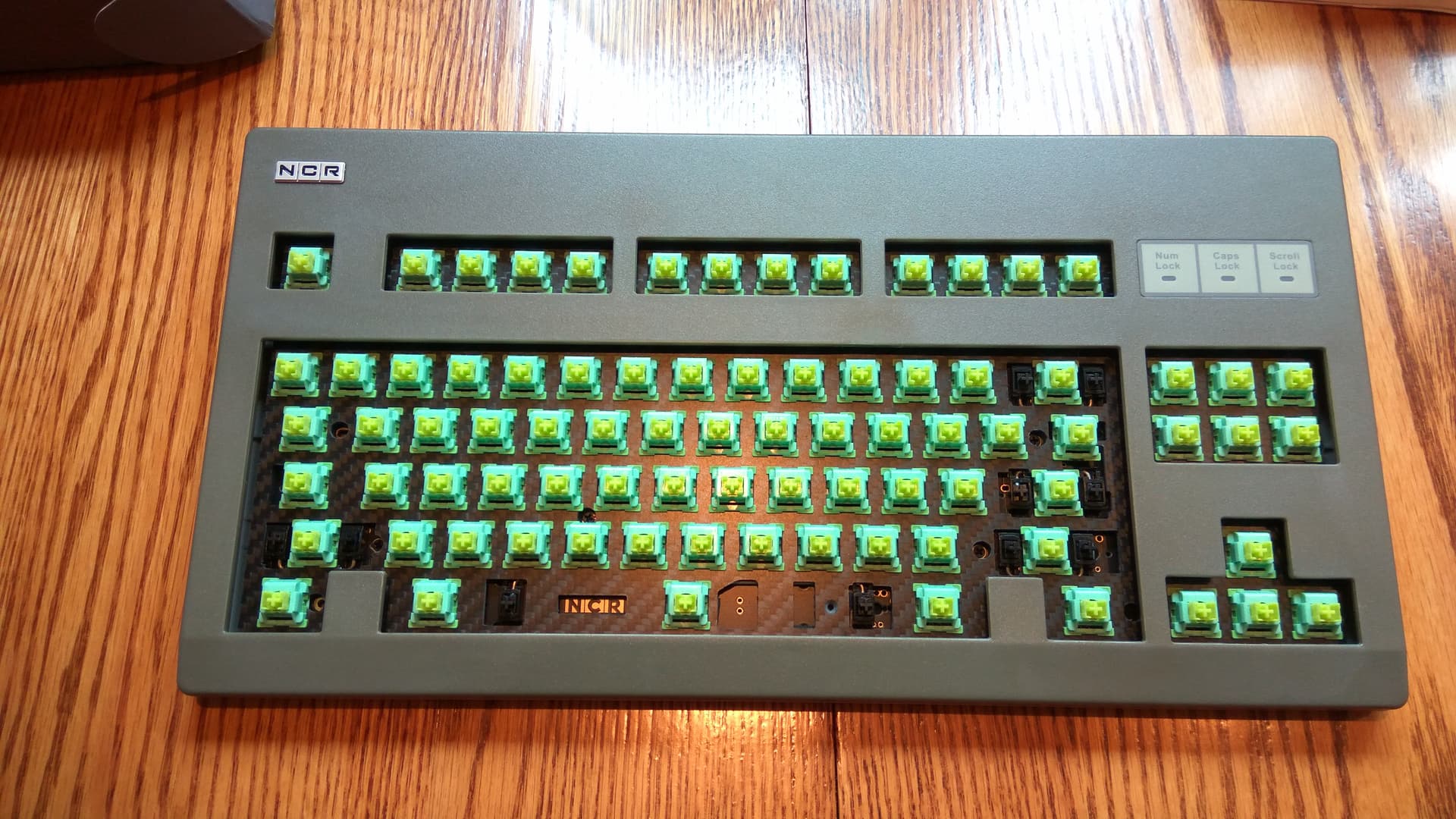

I’d emphasize here, you have to lube the Silent Lemon/Limes for best results. I helped with an NCR-80 for a relative using Silent Limes.
The lubed Silent Limes were quieter and deeper-sounding than unlubed. Very superior if going for a silent build. You just need to use a normal amount of 3204, no special technique. Lube springs, of course. It’s very worth it to lube Silent Limes.
