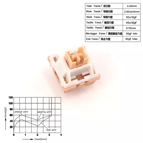

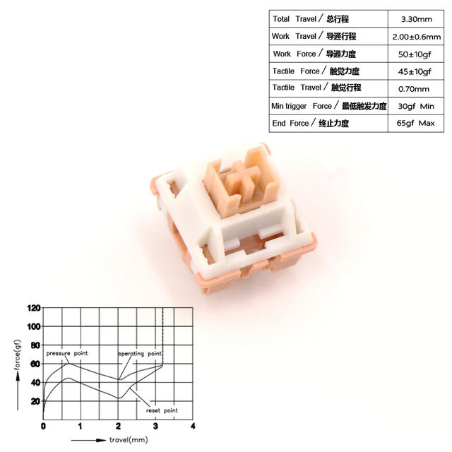

Cleanest stock silent tactile I know is the TTC Silent Bluish White

With tactile silents, there’s always going to be at least a tiny bit of that scratch - depending on the build and use environment you might not hear it, but get close enough and you will. I think so far the least swishy / scratchy stock silent tactile I know is the TTC Silent Bluish White. (Oddly enough this does not hold true at all for the TTC Silent Brown V2 which is ostensibly similar; it needs a full tuning to sound as clean as the SBWs do from the bag.)
It’s as you said - there’s little else to compete with the movement sound when top and bottom-out are silenced - and with dampened tactiles, it’s often the case that the friction of the stem against the leaf is the loudest part of the action. You can lube the leaf and stem legs which will reduce this sound, but that will also reduce the tactility of the switch. (As you may have picked-up on by now, it’s more about finding your preferred balance of factors than identifying the “best” product or tuning technique.)
