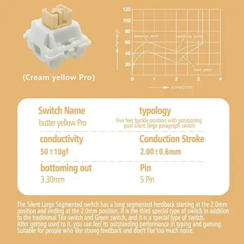

  1. Silent Cream Yellow Pro
My question is: Is the Silent Cream Yellow V2 the same as the “Pro” and the “Butter Yellow?”
This link would say “Yes.” It lists the “butter yellow Pro” as being also the “(Cream Yellow Pro).”
So the Cream Yellow V2 / Cream Yellow Pro / Butter Yellow Pro are all the same switch? Basically, OUTEMU’s Version 2 of their silent Panda/Halo/U4 tactile.

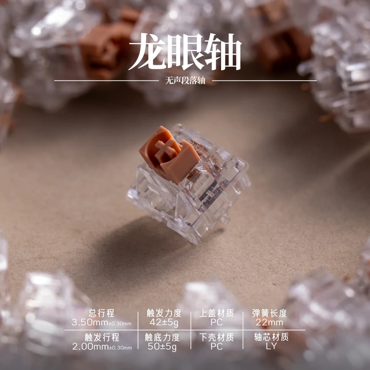

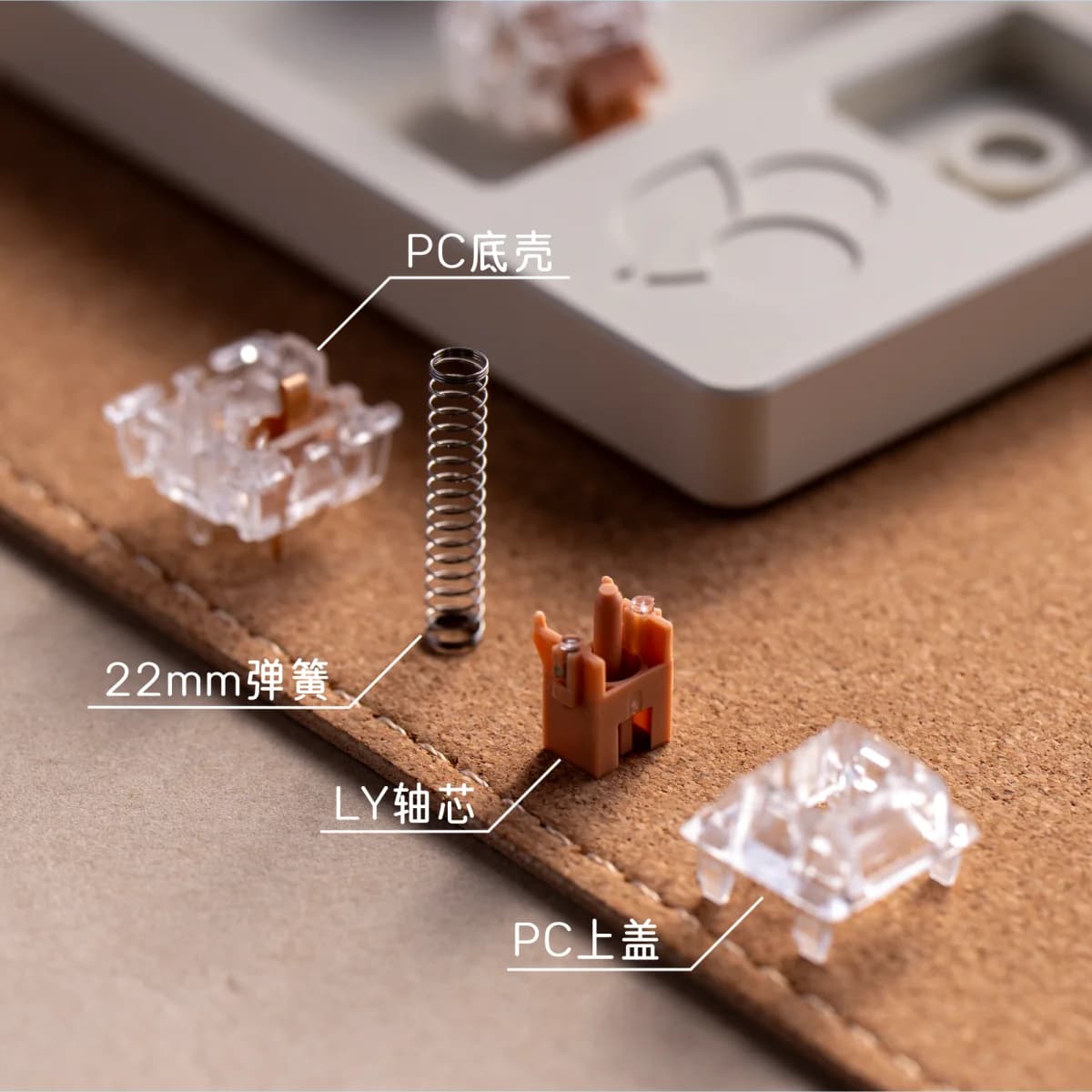

Speaking of AE, I found an actually new silent tactile switch (!!): SPM Longan / “Lychee”
Seems to be a large bump/”Holy Panda” style tactile. The silencing mechanism is still silicone on the stem, but it looks more like the stem for the DangKeebs Red Velvet than the usual Outemu mechanism (so, cylindrical stoppers instead of rectangular ones).
Here are some pictures from the AE listing, which match what I have on hand.
