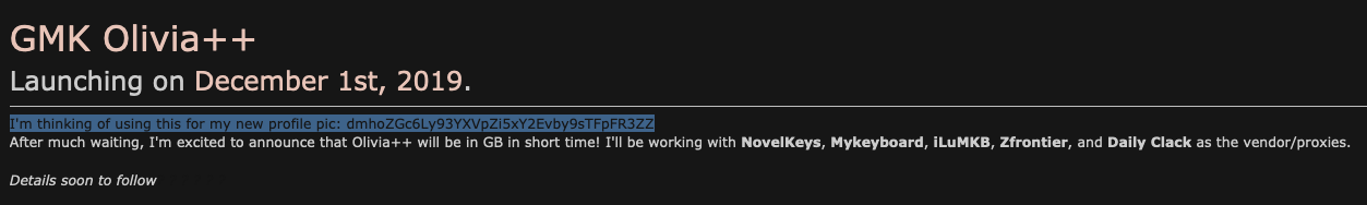

Olivia posted the Olivia++ IC on Geehack with the text in the screenshot set to black. I happened to be using the Tapatalk app on my phone and it doesn’t care about text color properties and so it was immediately visible.
The important bit is this string
dmhoZGc6Ly93YXVpZi5xY2Evby9sTFpFR3ZZ
If you run that string through a Base64 decoder you get: vhhdg://wauif.qca/o/lLZEGvY
Immediately this is recognizable as a URL but it’s clearly encrypted. It appears to be fairly simple but I wasn’t familiar with the pattern so I started trying to line up what I could clearly make out like so:
https://_ _ _ _ _.com/
abcdefghijklmnopqrstuvwxyz
m op  st        c    h
You can see the pattern pretty quickly here and I later found out it’s called ROT12 or “Rotate by 12 places”
Once solved, we get the decrypted URL:
https://imgur.com/a/xXLQShK
This Imgur album has a single image with another Base64 string caption V2UgbXVzdCBnbyBkZWVwZXIuLi4= that decodes to “We must go deeper…”

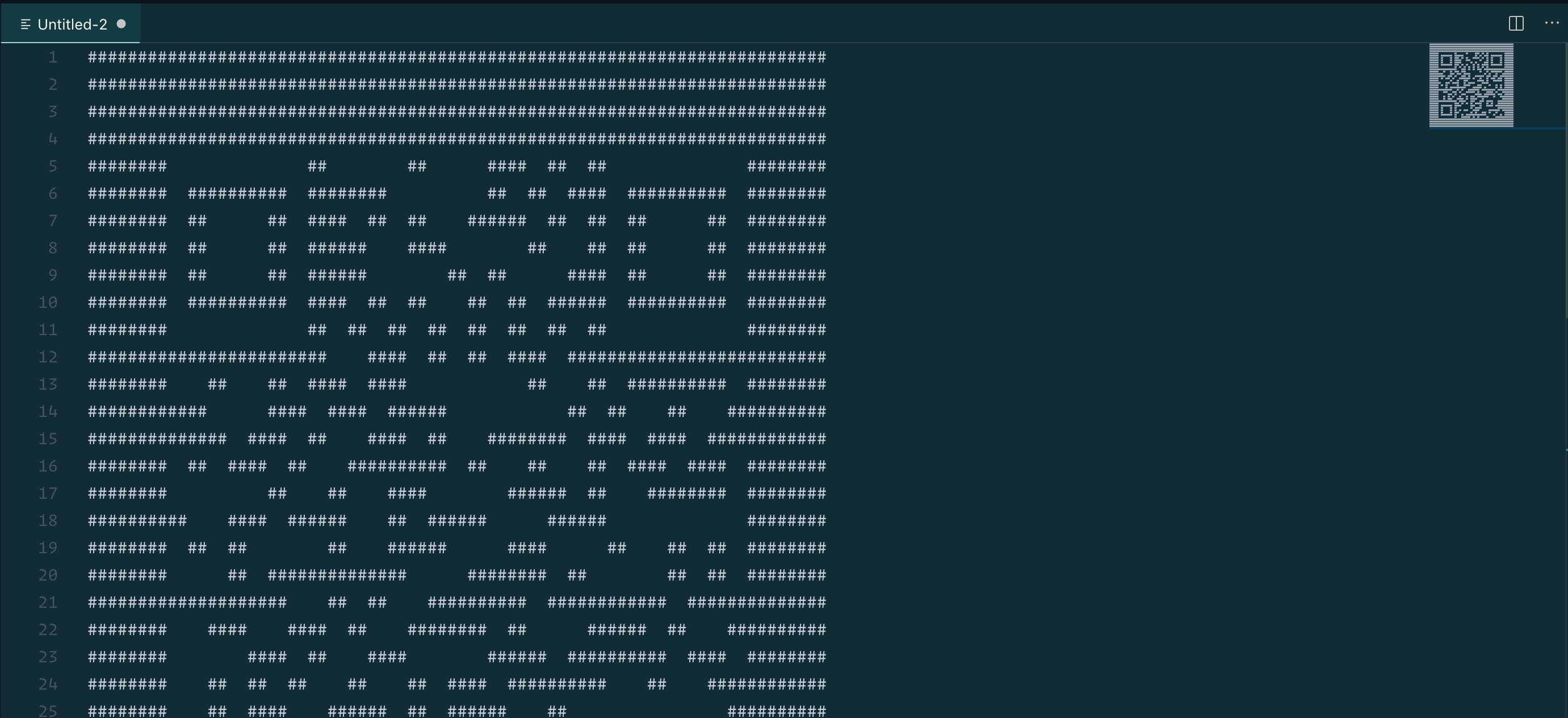

Once again I ran the string through a Base64 decoder to get:
It looked kind of like ASCII art from the output I saw in the web browser so I brought it into VS Code which was pretty lucky because I have the mini-map open which gives you a zoomed out view of your code and I was able to make out a QR code.
I scanned the QR code which took me here:
Countdown Clock and thus solving the mystery.
