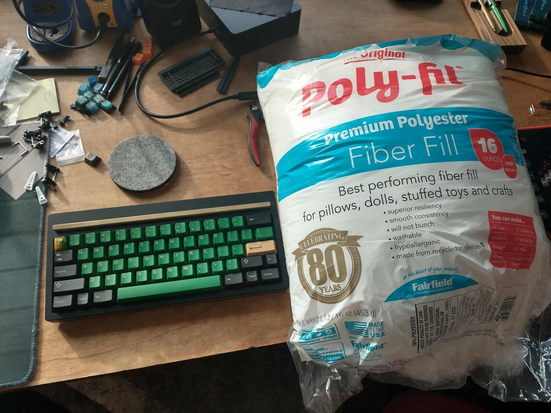

This may just be considered another kind of foam, but poly-fil might be worth a try. It’s stuffed-animal / pillow stuffing; a bag less than $5 should cover lots of keebs. Doesn’t really need to be dense in there, either, from what I understand - just stick in some fluff and you’re good.
At least in some keebs, poly-fil can put a hush on hollowness - if it doesn’t improve your Bakeneko, chances are it can improve some other keeb you come across.
I actually just bought a bag of polyfill to try out in a few boards, here’s a keyboard next to an $8 (16oz) bag for scale:
Pardon my messy desk lol. I’d guess this would be enough for around 30 boards.
Extra angle for extra context:
