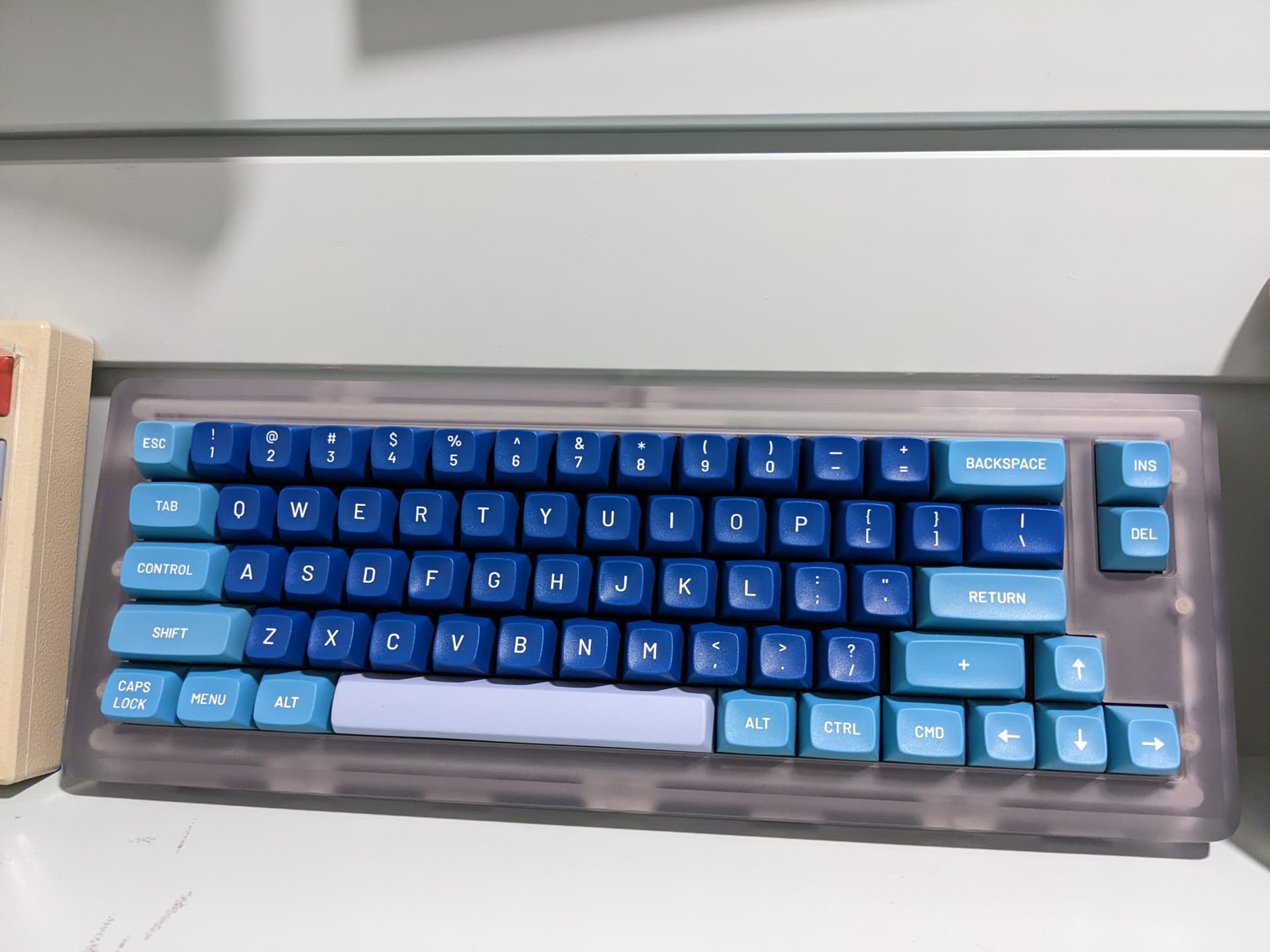

The Heavy-6 and Yang 660C controller does not work very well out of the box, connection wise, and due to the rear cover plate not having a cutout for the button. The only solution I found to this is to laser cut out an acrylic rear cover plate with a cutout
Thanks! This project has been plagued by an improbable confluence of setbacks (I paid to get the housings re-made twice because I wasn’t happy with the finish) but we’re pushing through on it and nearing the end of the tunnel. Fortunately rear cover plates are easy and fast to re-make, so we have a rush order in for those and hope to get them in within the next few weeks.

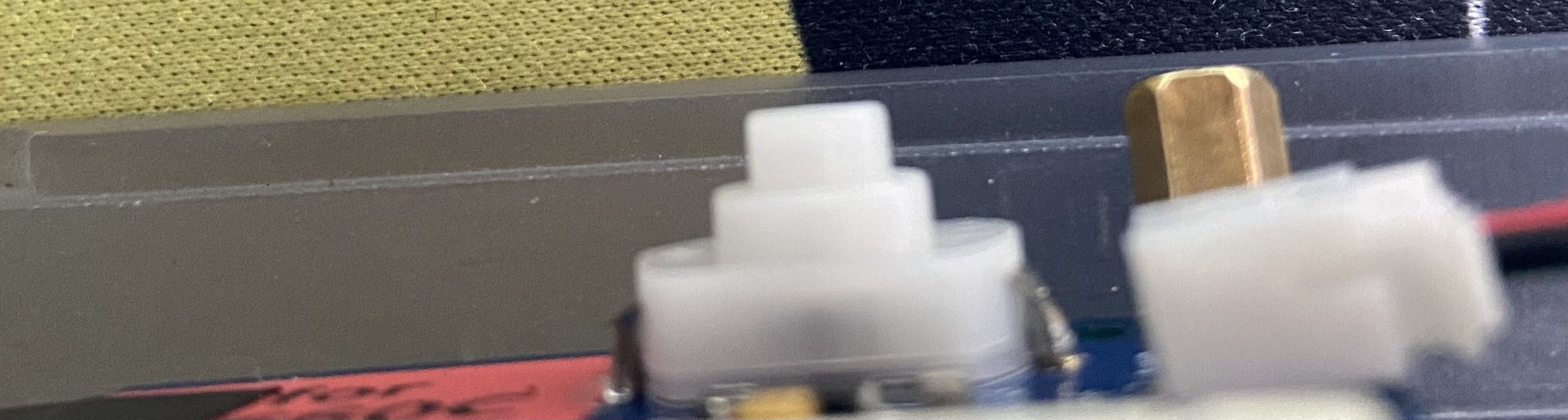

As for the cutout, you’ll probably need to figure something out as the design of the YDKB controller has it so when the button is pressed down, BlueTooth is disabled and when it isn’t pressed down its enabled.

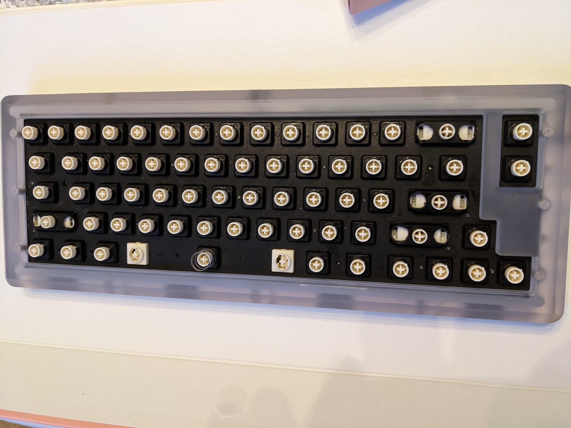

In this picture, the button is just tall enough to where if I were to put the rear plate flush to the case it would press the button thus disabling BlueTooth. However, Rooski gave me a solution that worked for him but not for me which was to short the pins in which the button was soldered on while it was pressed down but that didn’t work for me
Even after messing about and getting it so that the button wouldn’t be pressed down when I had the rear plate flush and screwed onto the case I experienced connectivity issues in which the Heavy-6 would disconnect and disappear from the “searching for wireless devices” list on Windows, and it was only when removing the rear plate, it would reappear and reconnect. I then quite literally placed the back of my Heavy-6 straight onto the wireless adapter on my PC for it to work but was very delayed and laggy.
So far, I’m assuming the problem has less to do with the steel backplate and more to do with the fact that the YDKB controller is sandwiched between the FC660C steel plate and the steel backplate unlike an HHKB or Heavy Grail which is a ABS plate, and replacing either one would allow connectivity to go through.

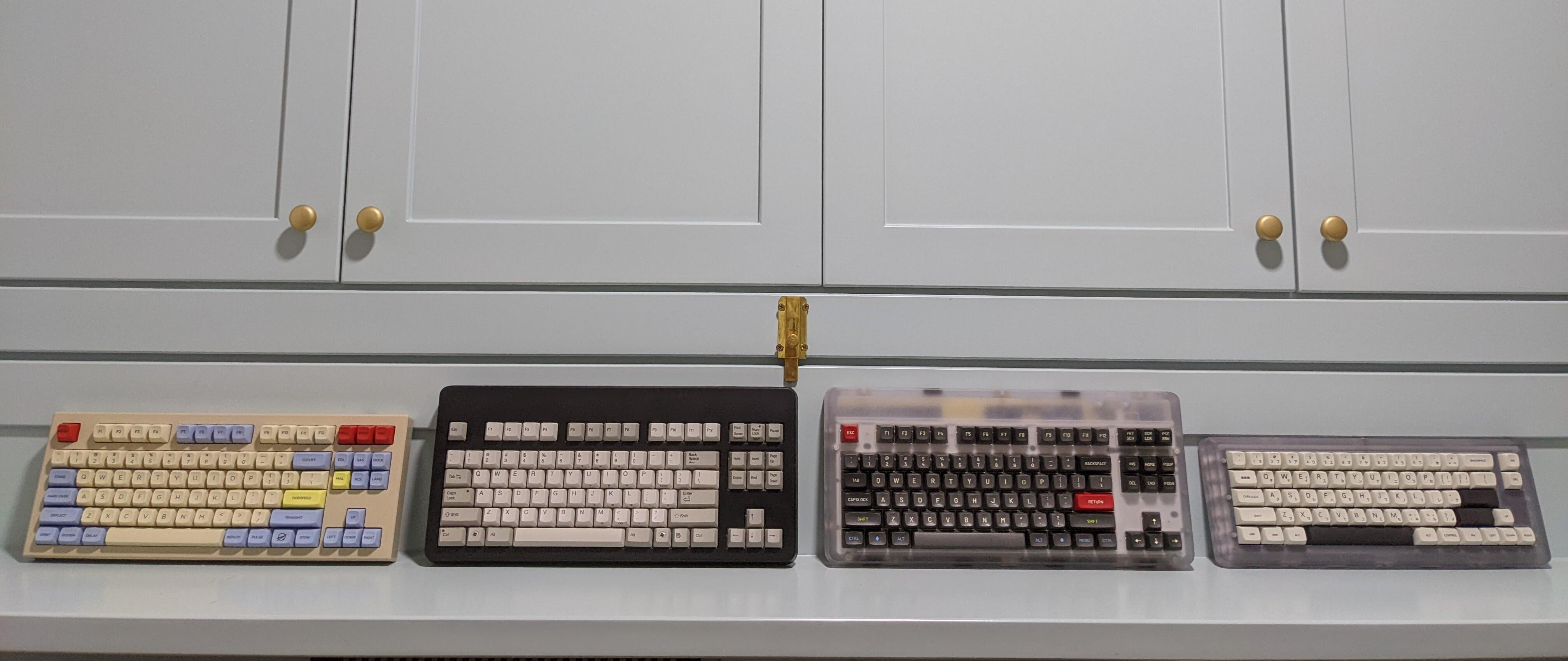

Finally got time to assemble the case. The box itself is huge, even larger than my Norbaforce boxes. The magnetic lid is such a nice touch. The evolution is clear just by lining up the boxes together.

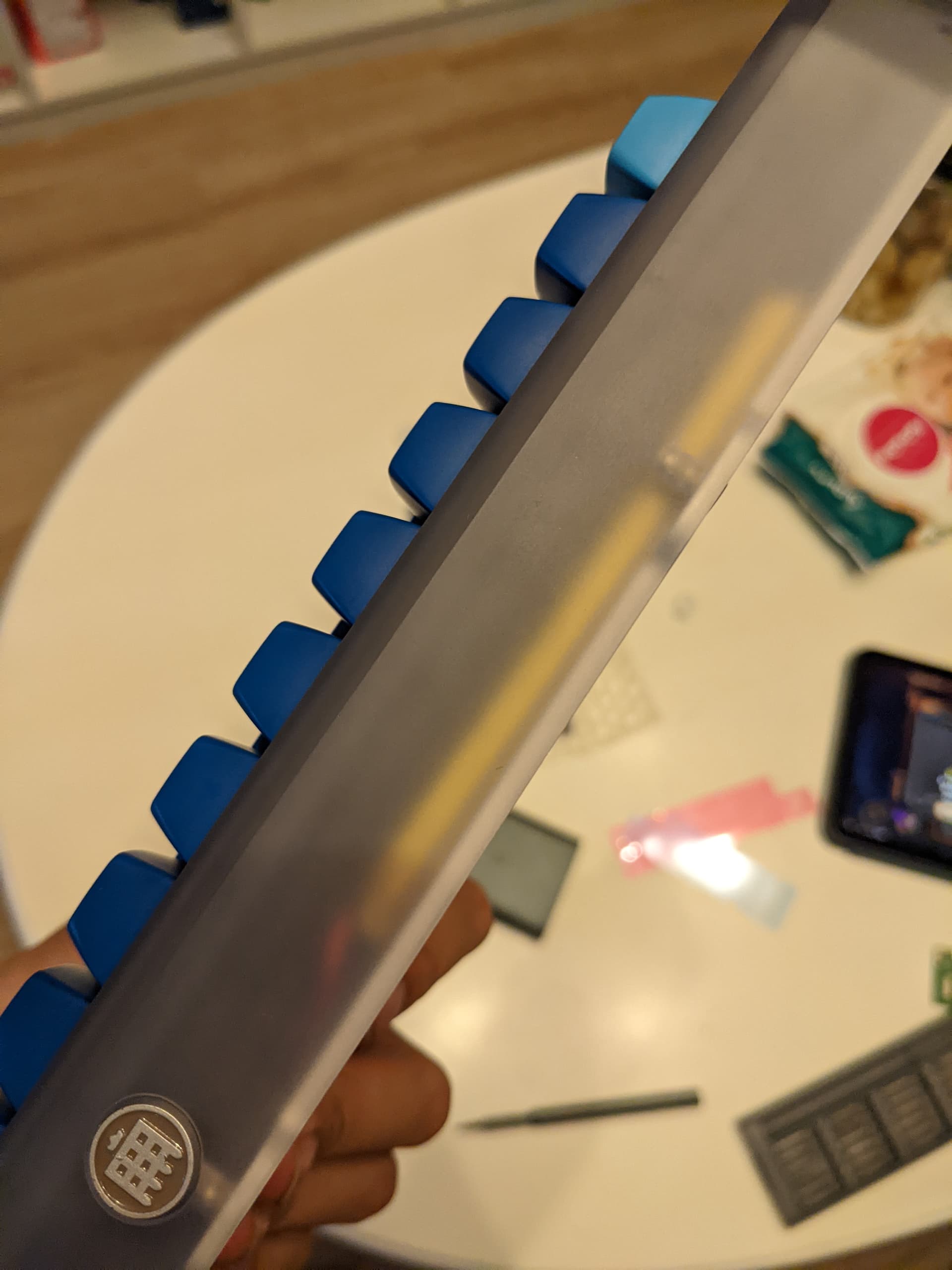

The case itself is B-stock with white steel rear plate, solid as its namesake and can easily pass as A-stock if you’re not looking for the blemishes.

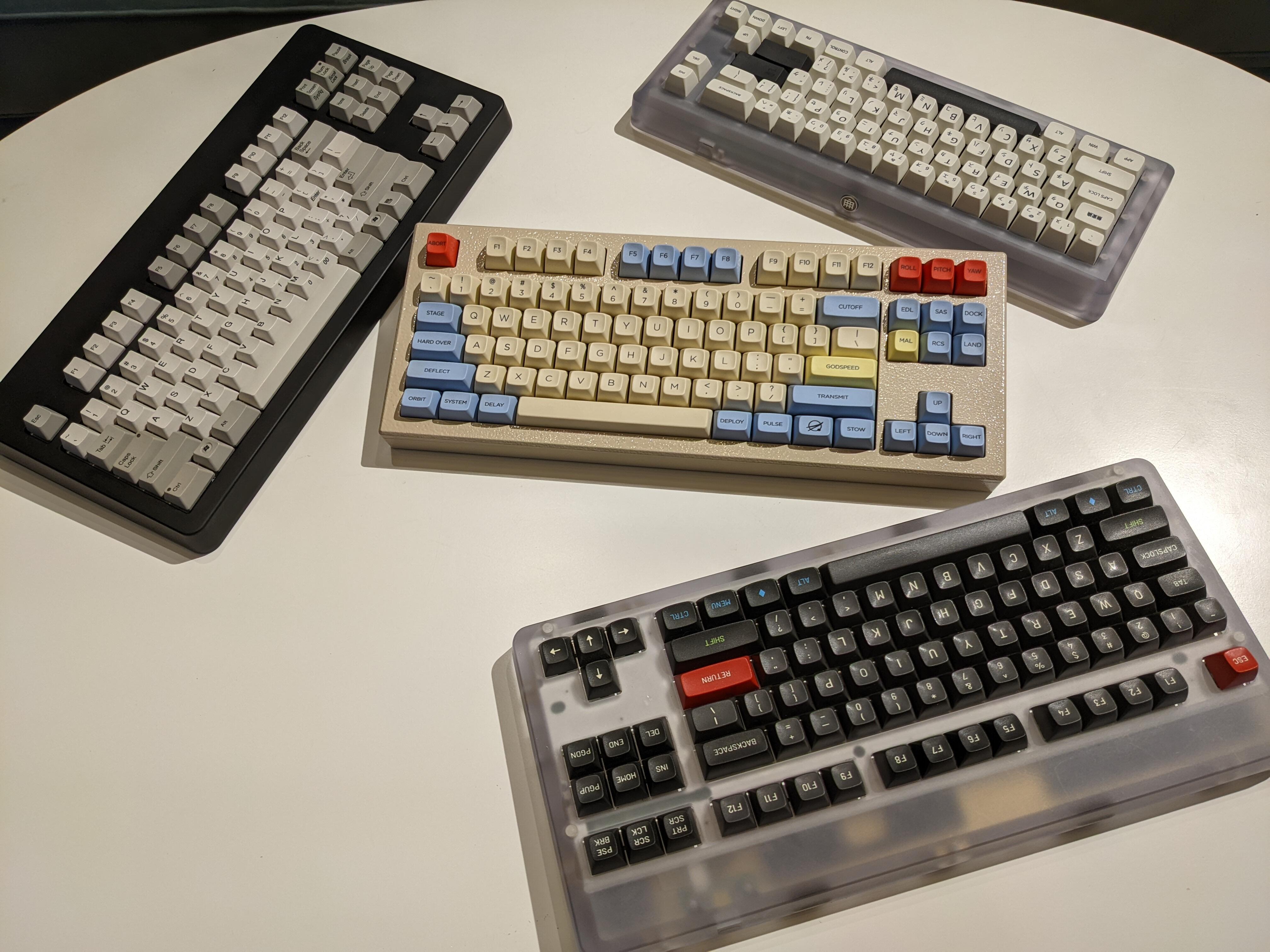

Here are some pics of the welcome-to-the-family party. And we’re expecting a few more!

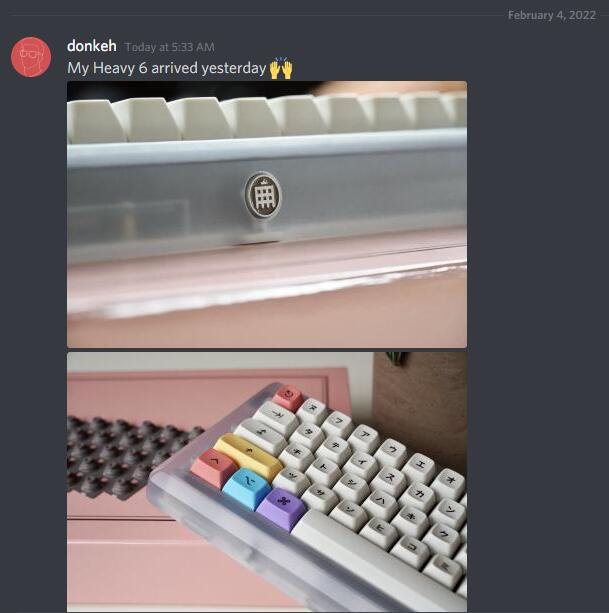

Looks like folks who ordered their Heavy-6’s this year are already receiving them. That’s very odd because I ordered mine in May of last year (2021) and haven’t heard a word about when I’ll be getting it.
When asked when it was ordered…
That is a b-stock housing, which you can tell from the gray badge on polycarb. Those went out earlier (of course) because they arrived in the first batch that we rejected.

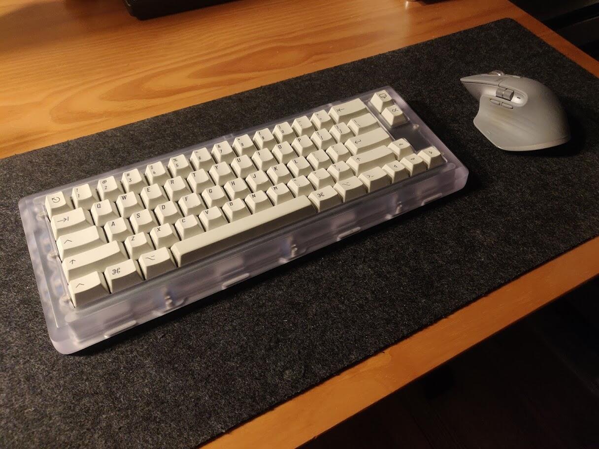

Finally gave my PC H6 the full Deskey treatment and the MT3 spacebar it deserves. This is the first batch of spacebar slider without the fixed stem, luckily no cracking on the keycap at all - but it’s super tight and a bloody pain to remove the keycap.

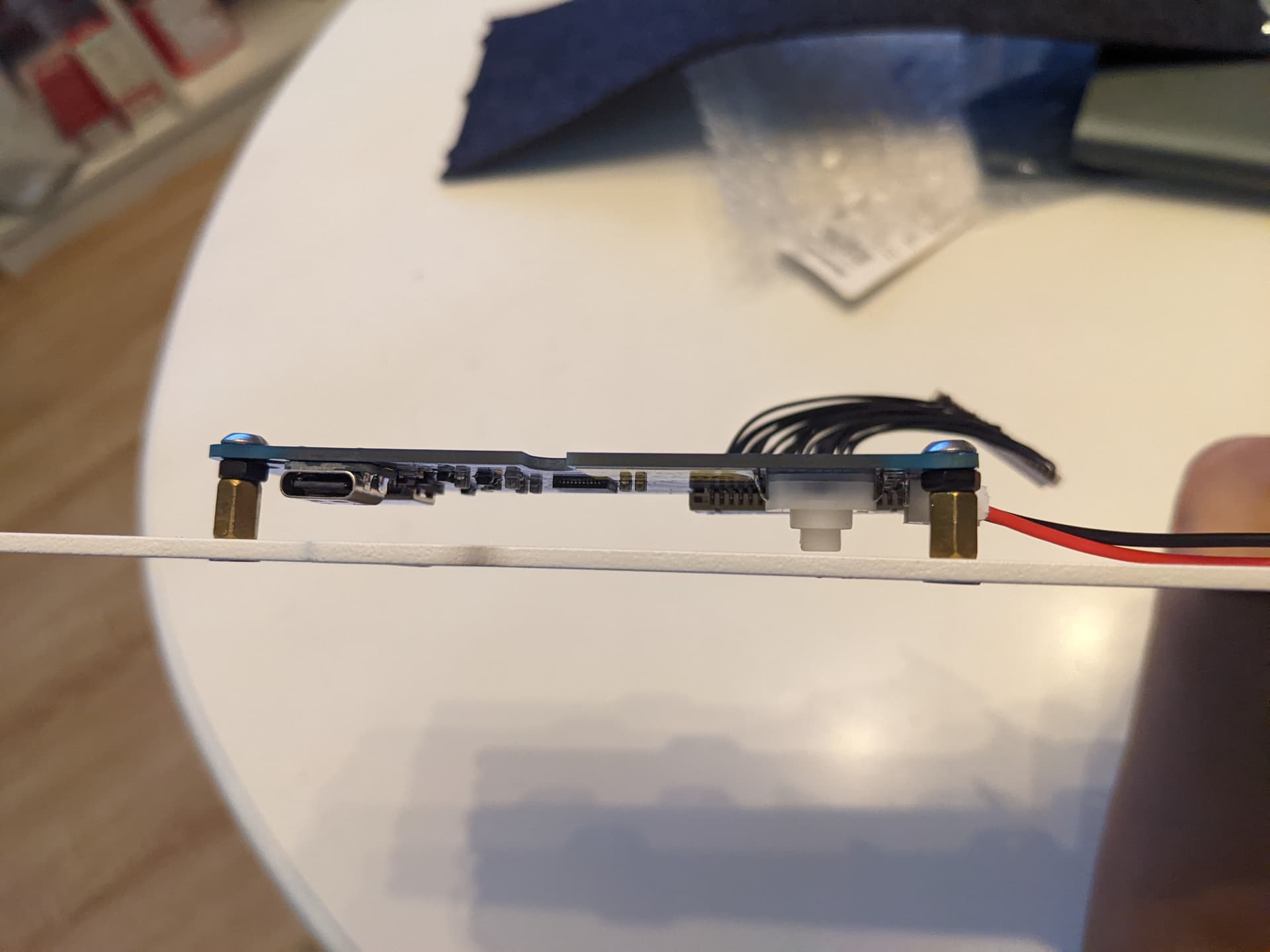

I made the Yang BLE x Heavy-6 PC works guys! Bluetooth signal is very good, no disruption at all.
The how: 2mm spacers do the trick, now the BLE switch is completely cleared off the backplate. I leave it permanently on because there’s no point in turning them on/off to save battery. Yang controller is already great at that and I can go for a month at work without needing to plug in charging cable
Bonus pic: cool side-view showing the battery - it’s a 2500mAh champ!
So some more info on this, the standoffs included with the case is 7mm M3 female-female. My washers were 2mm thick.
Basic math tells me to get 9mm standoffs to streamline it. And it works perfectly, clearance between the button and the backplate is <1mm so you’ll need a thin metal part to actuate it.
