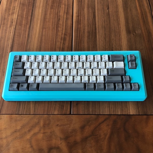

Nice pictures, the first one looks almost rendered :slight_smile:
How’s the typing feel compared to stock case?
There is definitely a difference to the stock case, the Heavy 6 not surprisingly feels more ‘solid’ than the plastic case. I prefer a slightly more angled typing experience so after those photos were taken, added some 10mm bumpers I had to the Aperture case and it is perfect for me.
With the retro case I need to do a little more work on the MX conversion. I have some binding on the right shift due to holes that need to be drilled in the housing for the stabilizers shafts on the MX keycaps, and need to adjust the space bar slightly, so reserving opinions on that one, though very happy with how well the color of the keycaps goes with the case so will persist in making it work.

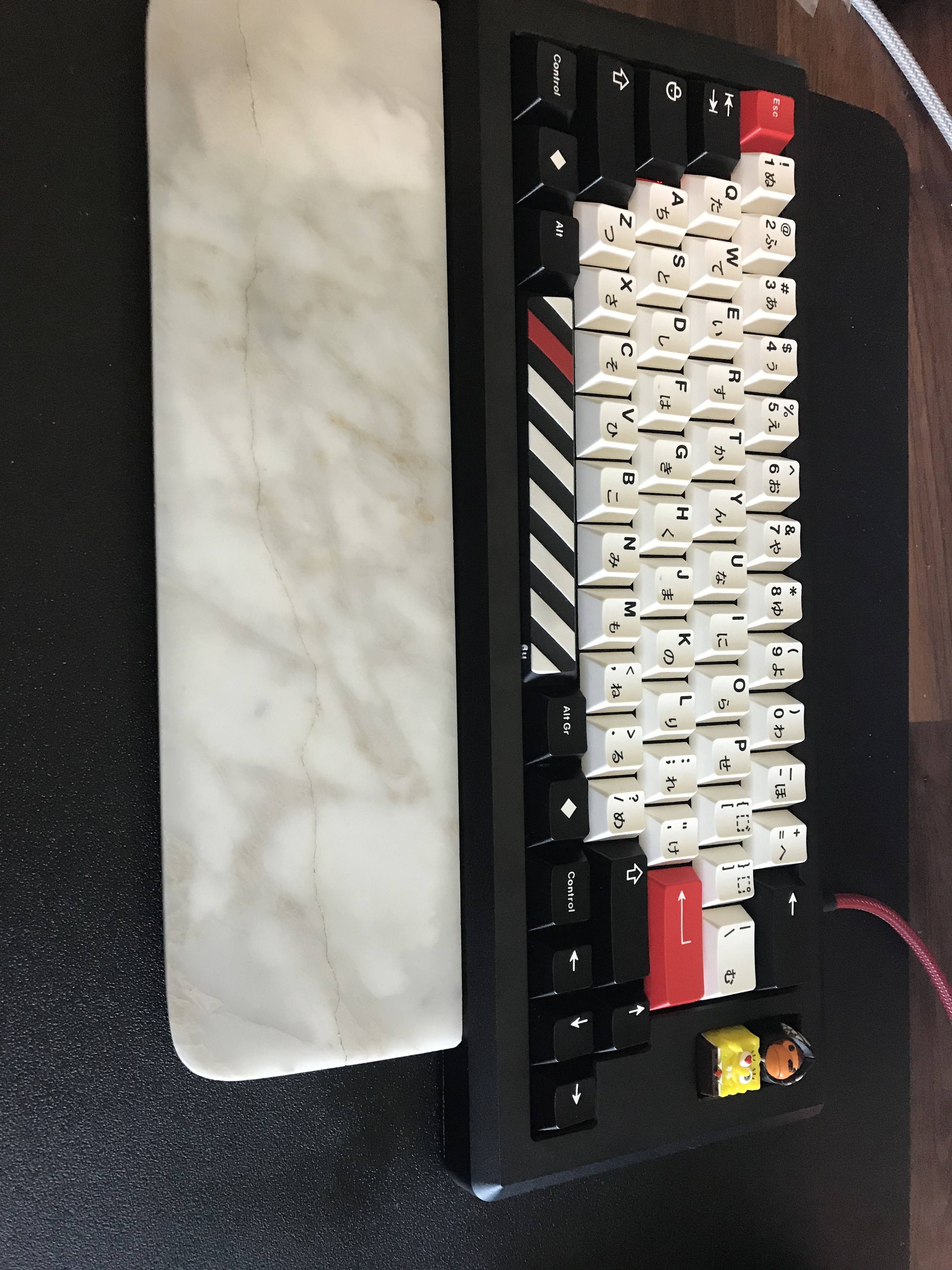

It’s beautiful :heart::heart_eyes: it’s not done yet but almost there

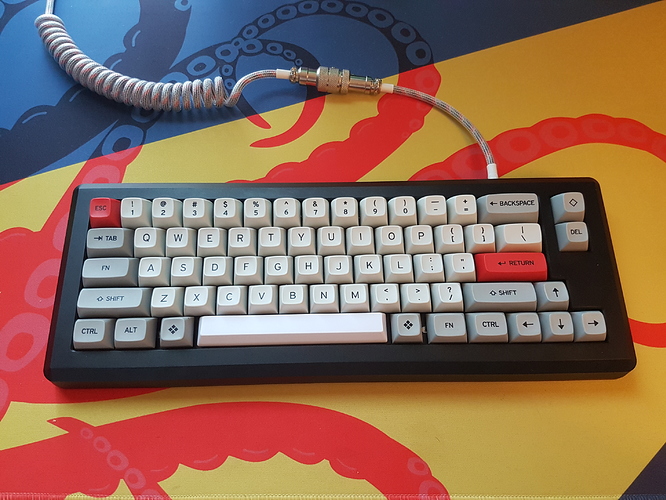

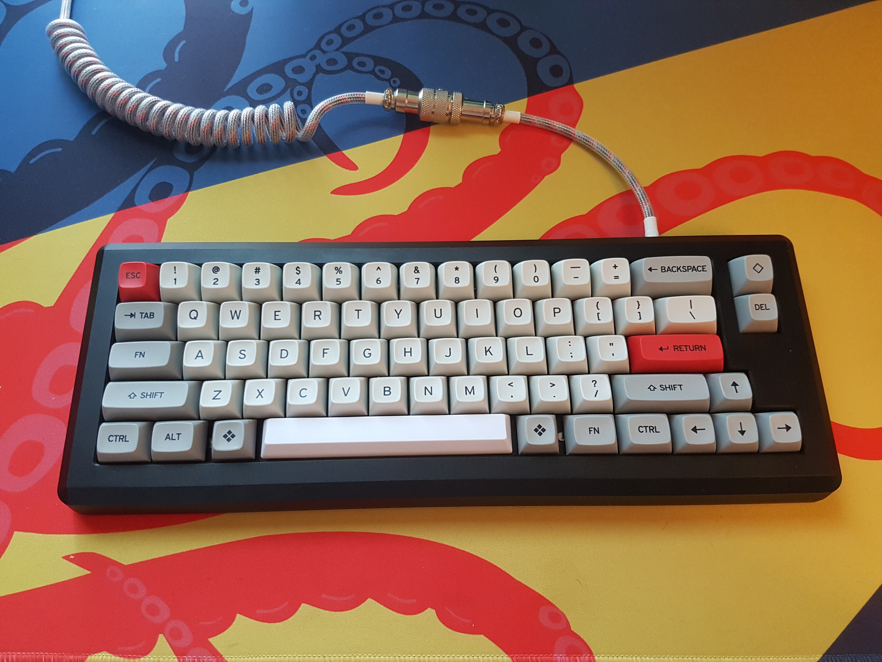

Where did you get the caps!?
They’re MT3 profile /dev/tty caps. I got them during the 2nd run about a year ago, but it looks like Massdrop has been doing further production runs: Drop Keycap Re-Cap | Mechanical Keyboards | Keycaps | Custom Keycaps
They’re MX-compatible caps so I’m using Topre-to-MX sliders, and that’s mostly fine but that’s why the spacebar doesn’t match. I’m still struggling to find a way to get one of my /dev/tty spacebars to fit but none of the solutions I’ve found have worked thus far. Sooner or later I’ll crack it!
I have /dev/tty with the teal modifiers on my Retro Heavy 6 and am using these 3d printed stabilizers for the space bar. Not super cheap when you print up the set, but they work (though I am thinking of fiddling with them a bit e.g. lubing to improve the feel)
Oh neat. Which sliders are you using? Any noise/smoothness issues?
I also tried these spacebar stabilizers but they’re just so delicate and as they are when they arrive they’re extremely rough and scratchy. I managed to break the set I ordered when I took them off to sand the rough edges down. This is mostly my own fault. I didn’t understand just how fragile they are.
Maybe I’ll try them again at some point… But now I have to get fragments of stabilizer stems out of the connector slots on my spacebar… :sweat_smile:
I’m using kbdfans sliders. They’re a little wobblier than the stock Leopold sliders but it’s not really noticeable during day-to-day use. They sound a bit more clattery due to the looser fit but I don’t mind. Makes them sound a bit like IBM buckling springs. I use a thicker lube on my sliders so smoothness isn’t really an issue.
