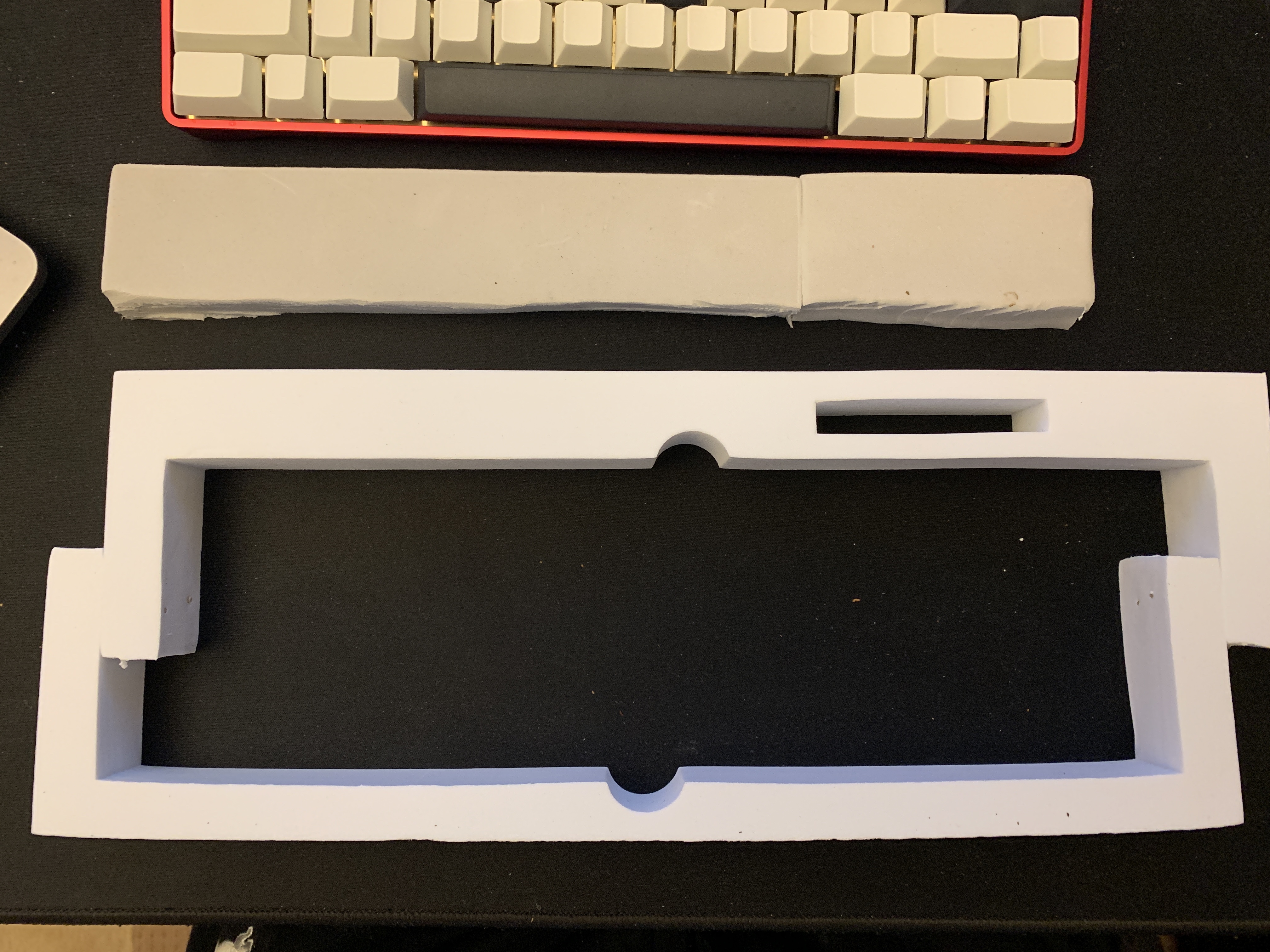

Reassembling Topre keyboard can be difficult without a rig to hold the keyboard upside down while placing and aligning domes and springs. I had one made out of a stiff cardboard box but, without much sidewall support, it was too flimsy.
I made a better rig out of thick foams that come with heavy keyboard cases. All it takes is something to cut the foam, toothpicks, and ~5 min.
As you can see, I cut the sides (using a scissor) then used a pair of thick wooden toothpicks (round kind) on each-side to stitched them back together to fit my HHKB.
My HHKB on the rig. Best part is that these foams are not slippery.
