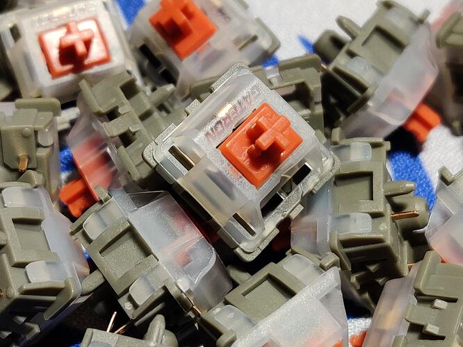

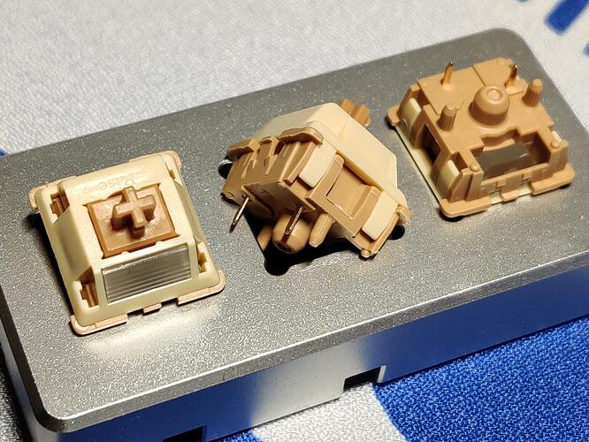

GATERON Pro Glory Red Switch
Glory Red Switch
• Type: Linear
• Operation Force: 45gf
• Pre-Travel: 2.0mm
• Total Travel: 3.6mm
• Stem: POK
• Top Housing: Nylon
• Bottom Housing: Nylon
• Spring: 22mm
• LED Support:SMD​
• Pre-lubed: Yes
• Pins: 5-Pin

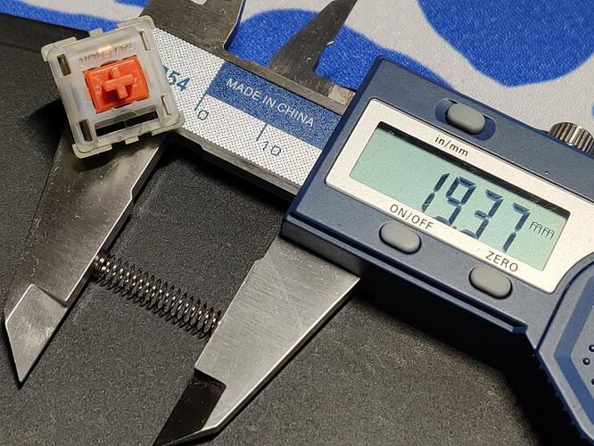

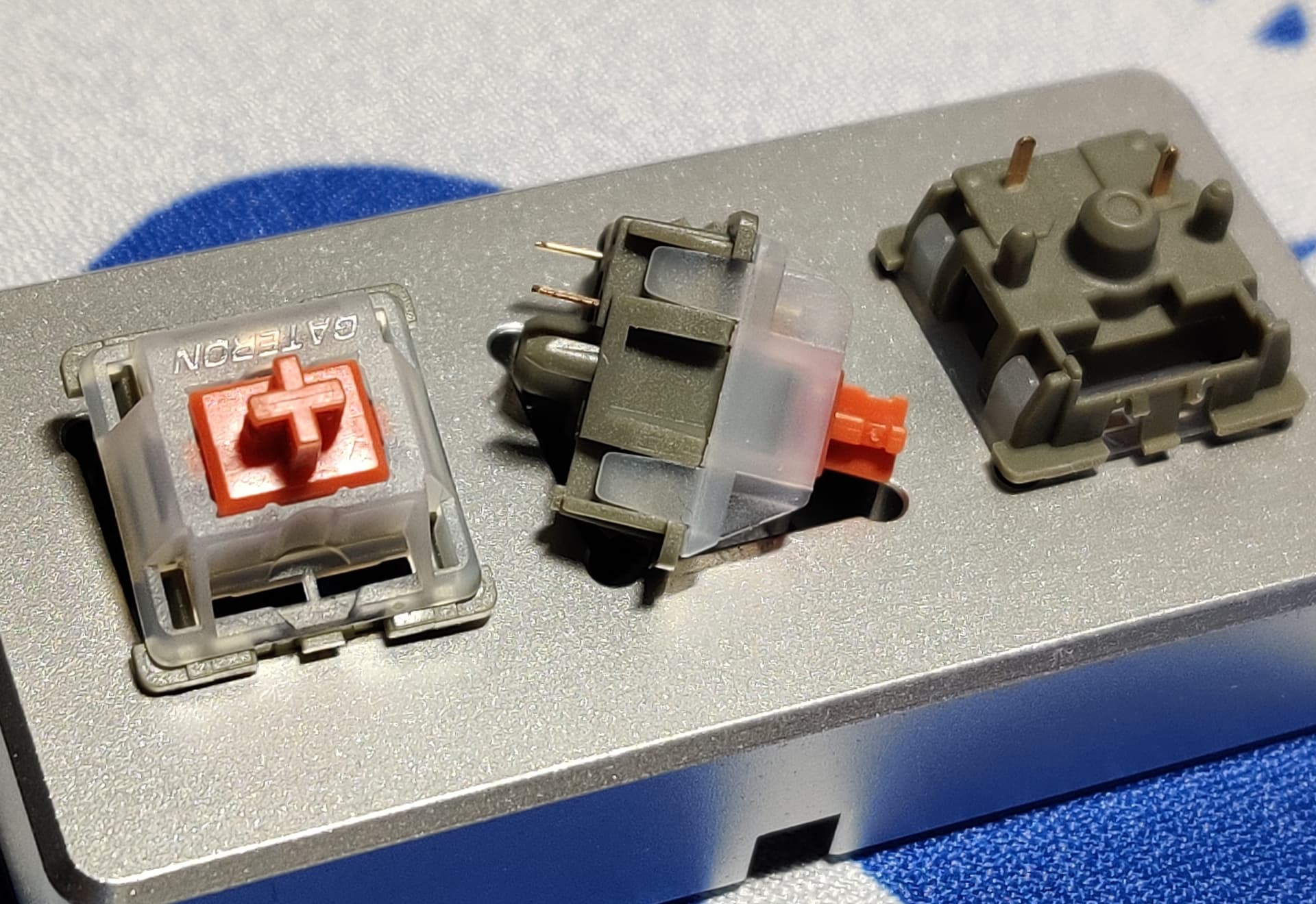

Do you like the switch? The spring seems like it would be too light for my taste but the rest looks good.

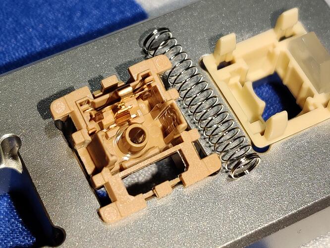

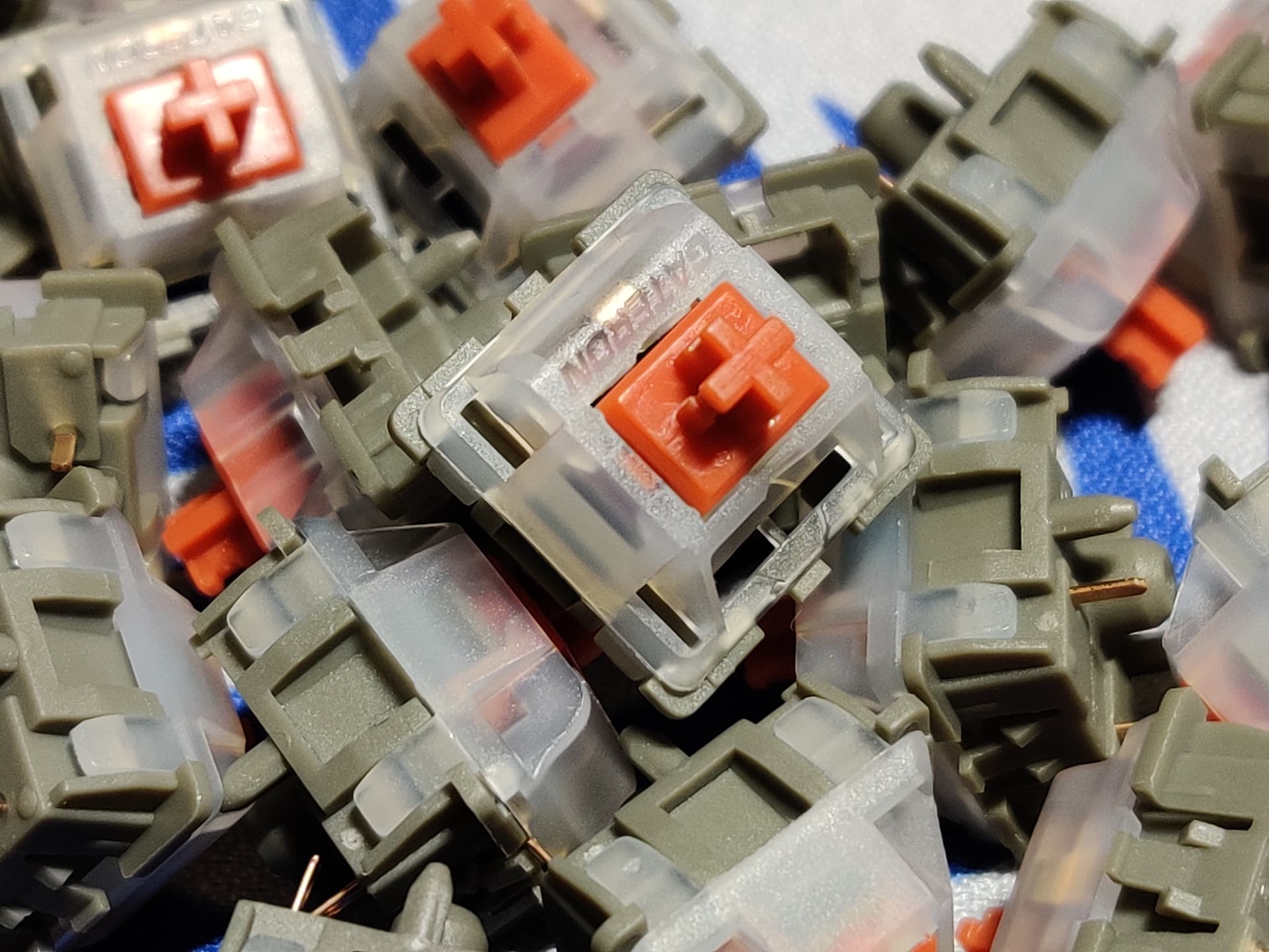

This looks like their Cream Soda switch with three changes:
  • Stem is made of POK instead of Nylon
  • Bottom housing is made of Nylon instead of Ink material
  • Spring weight reduced to 45g from 63g[1] and increased length to 22mm from 18mm
[1] I’m using Cream Soda with stock spring bc it feels like 58g than 63g long spring.

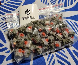

Not today but got these in last week. Silver from GEON and green from mechmarket.

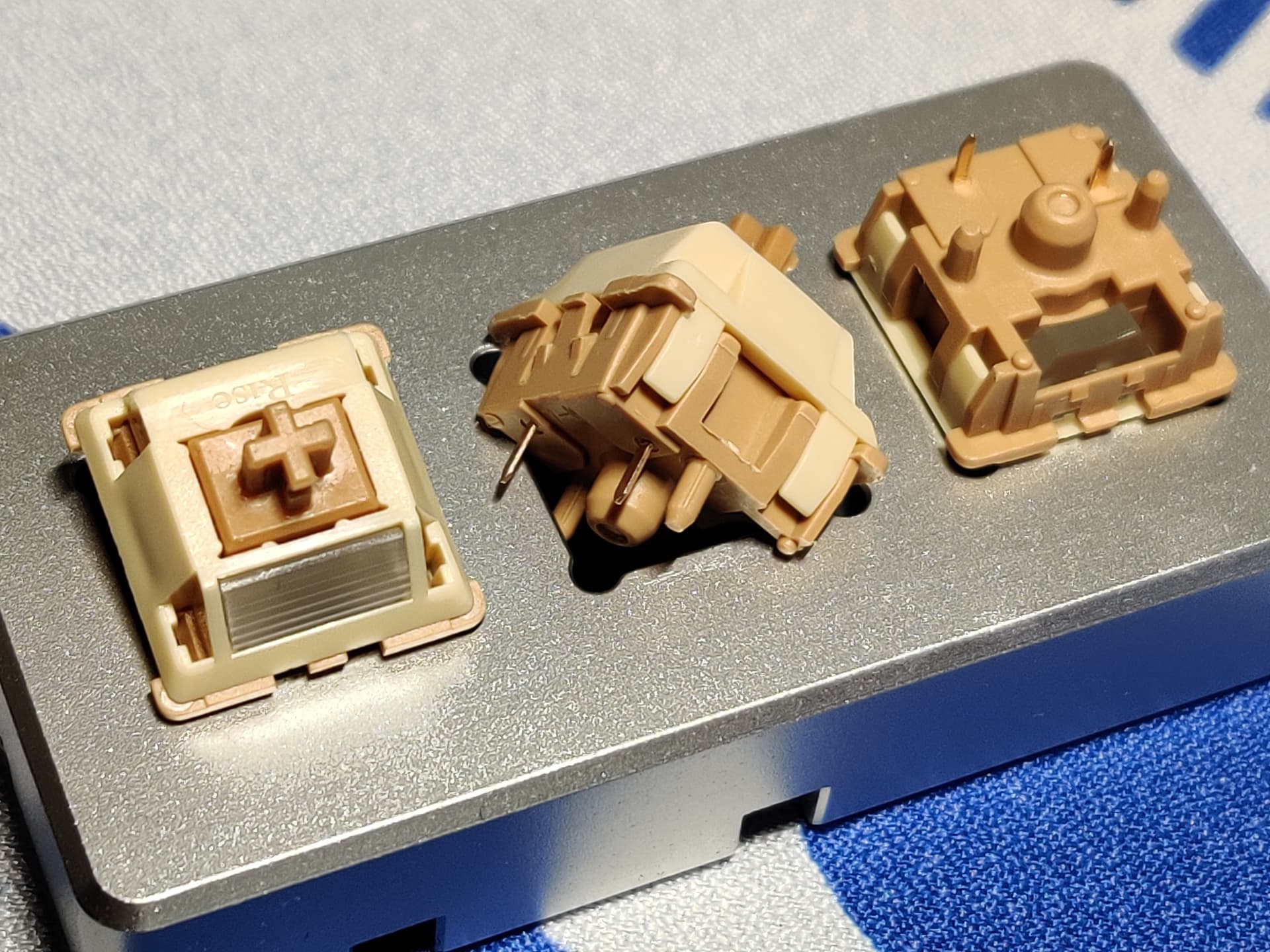

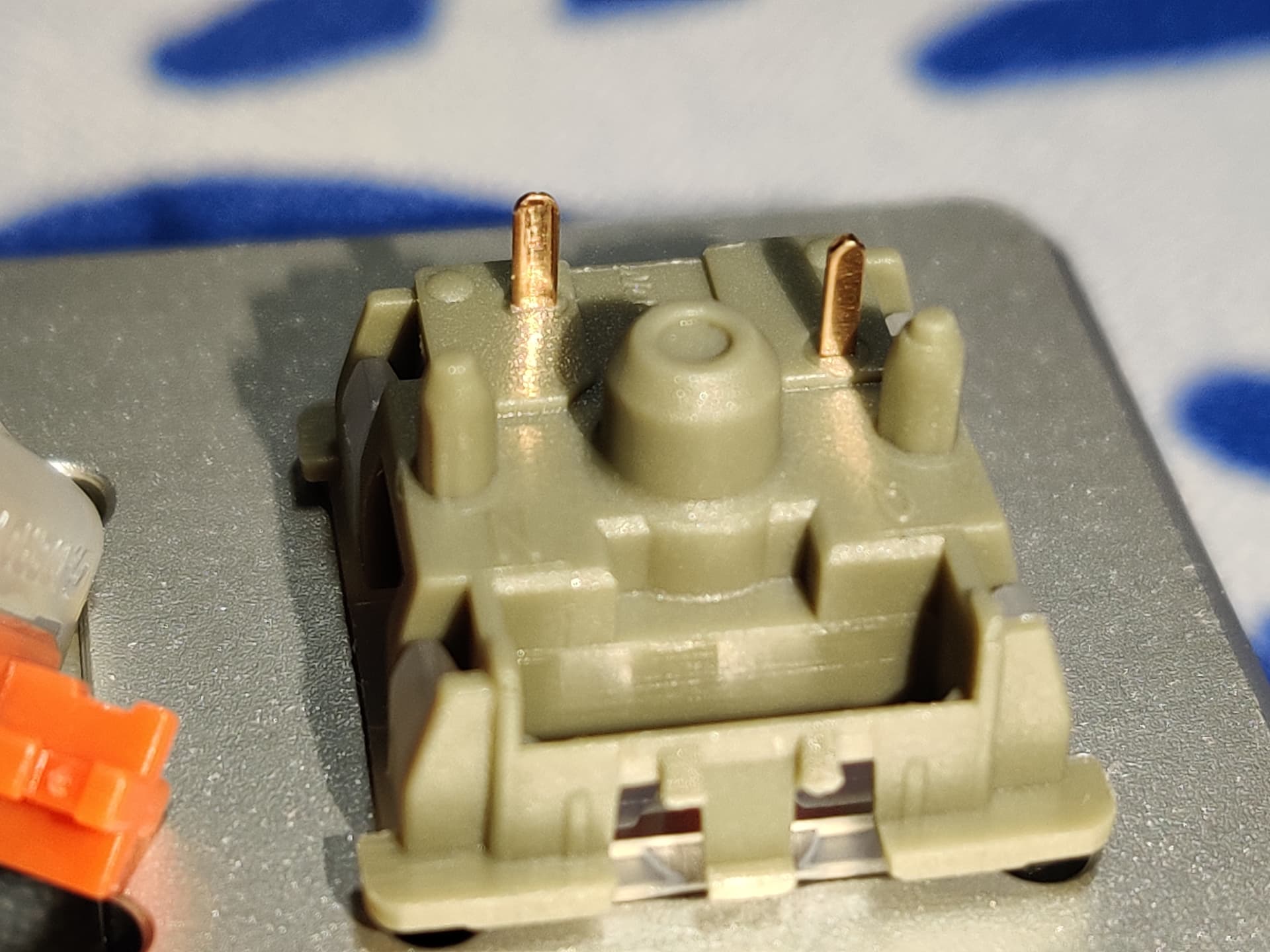

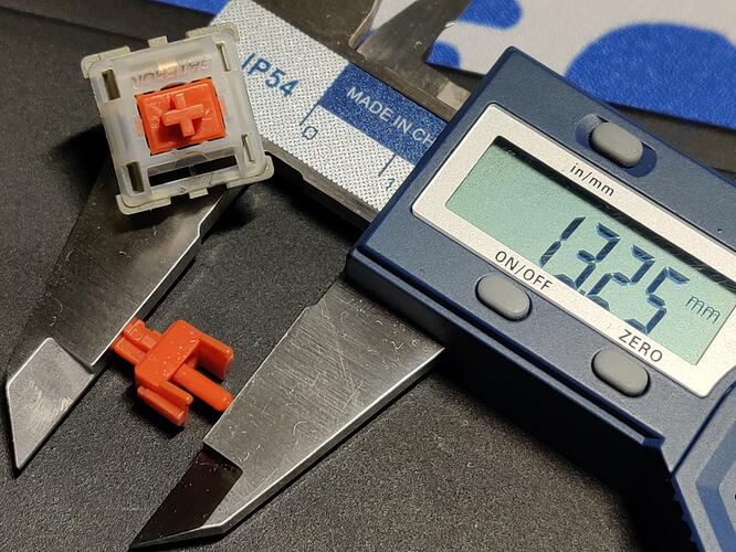

The lubrication and weight of the spring gives the feeling that this is a medium-heavy switch. It has a stronger pushing force upward than downward.
The body is good, no film is needed, no wobbling. But the wobbling “stem” is slightly above average, at the highest point and at the lowest point.
Press form from “g pro 3.0”
The sound is quite deep, low, not loud.
I uploaded my typical videos to Instagram and YouTube.
Now we can say the disadvantages or features.
The first thing is there is a moment in the video. When you lightly tap the keycap, there is a high-pitched sound; it also occurs if you accidentally press the keycap while printing. Such a high, clicking, clicking sound.
I also came across a moment when, when pressed all the way down, when pressed to the bottom while rocking, it seemed to catch something. This can also be caught when you use running in the game, since sometimes it is pressed as if at an angle. But so far I have only found one of 10 of these. Maybe I was just unlucky, when printing text you don’t feel it, only if in a game or at a crooked angle, pressing the stem all the way down.
Still, the switch is good. Today I will put together option one. And I will record the typing sound. I’ll update this post in 10+ hours. :wink:

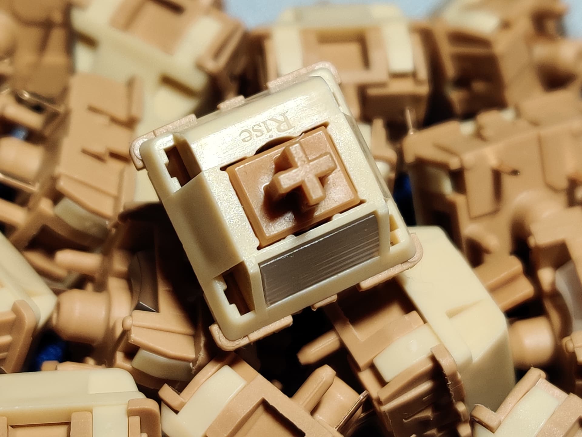

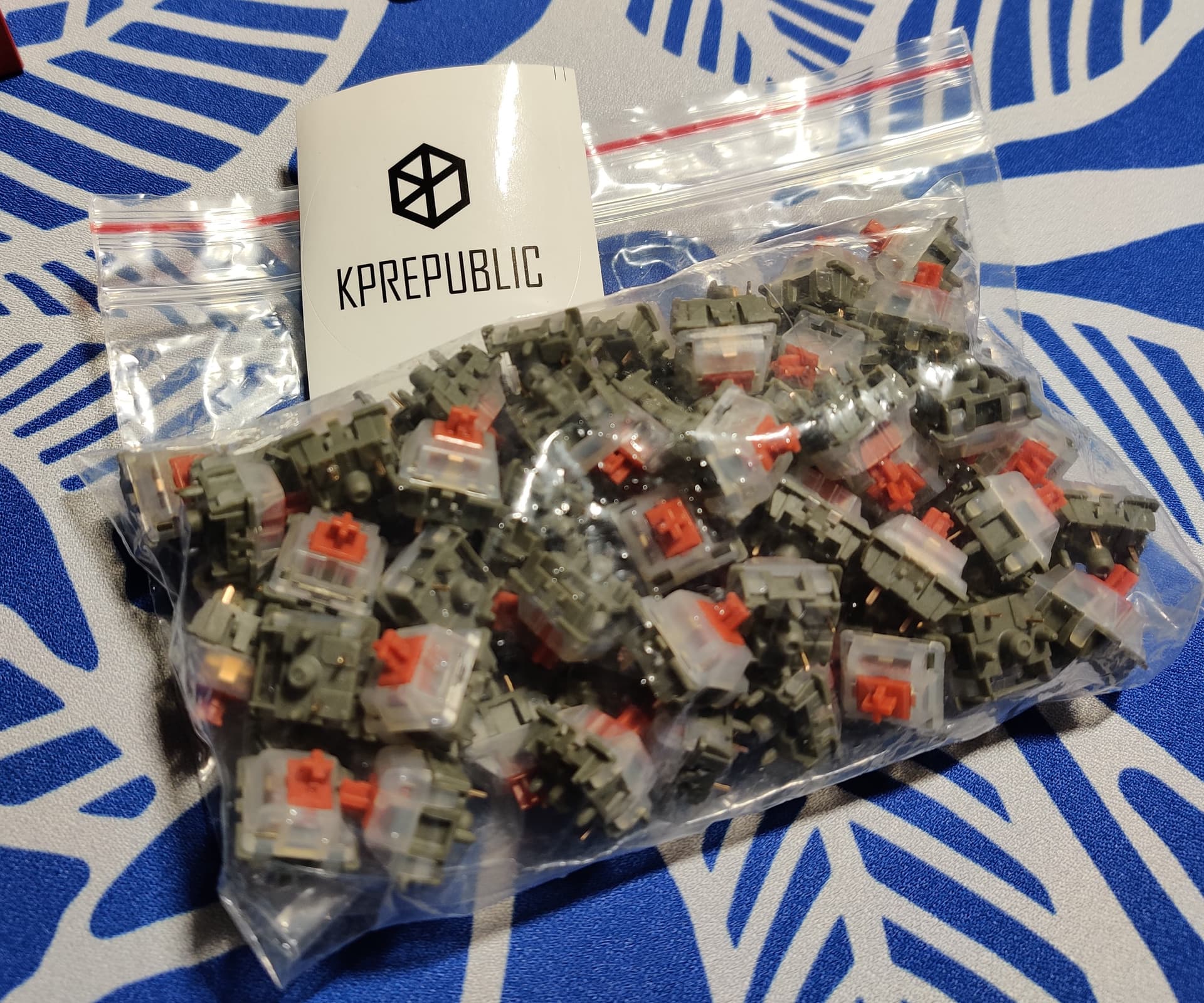

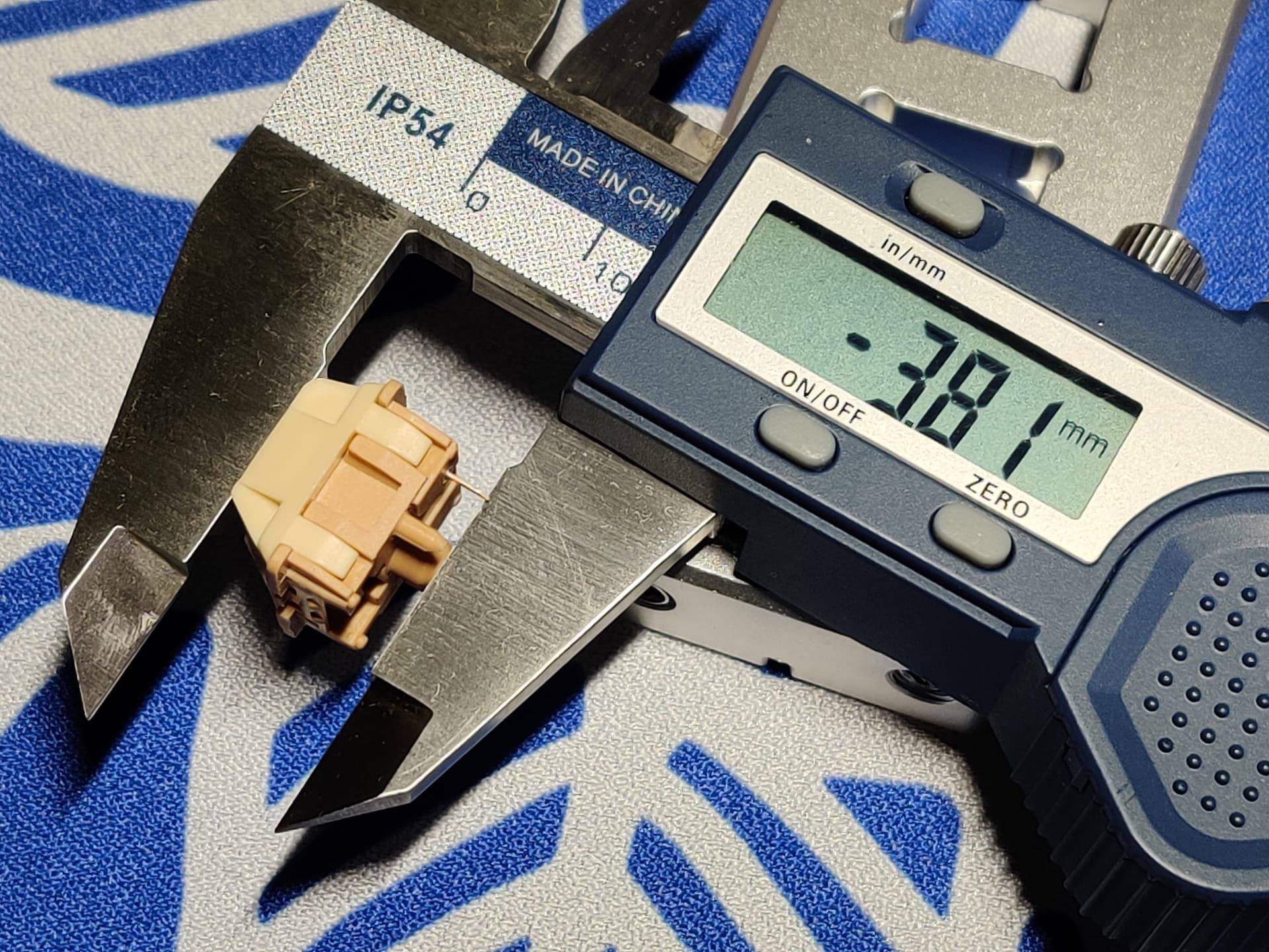

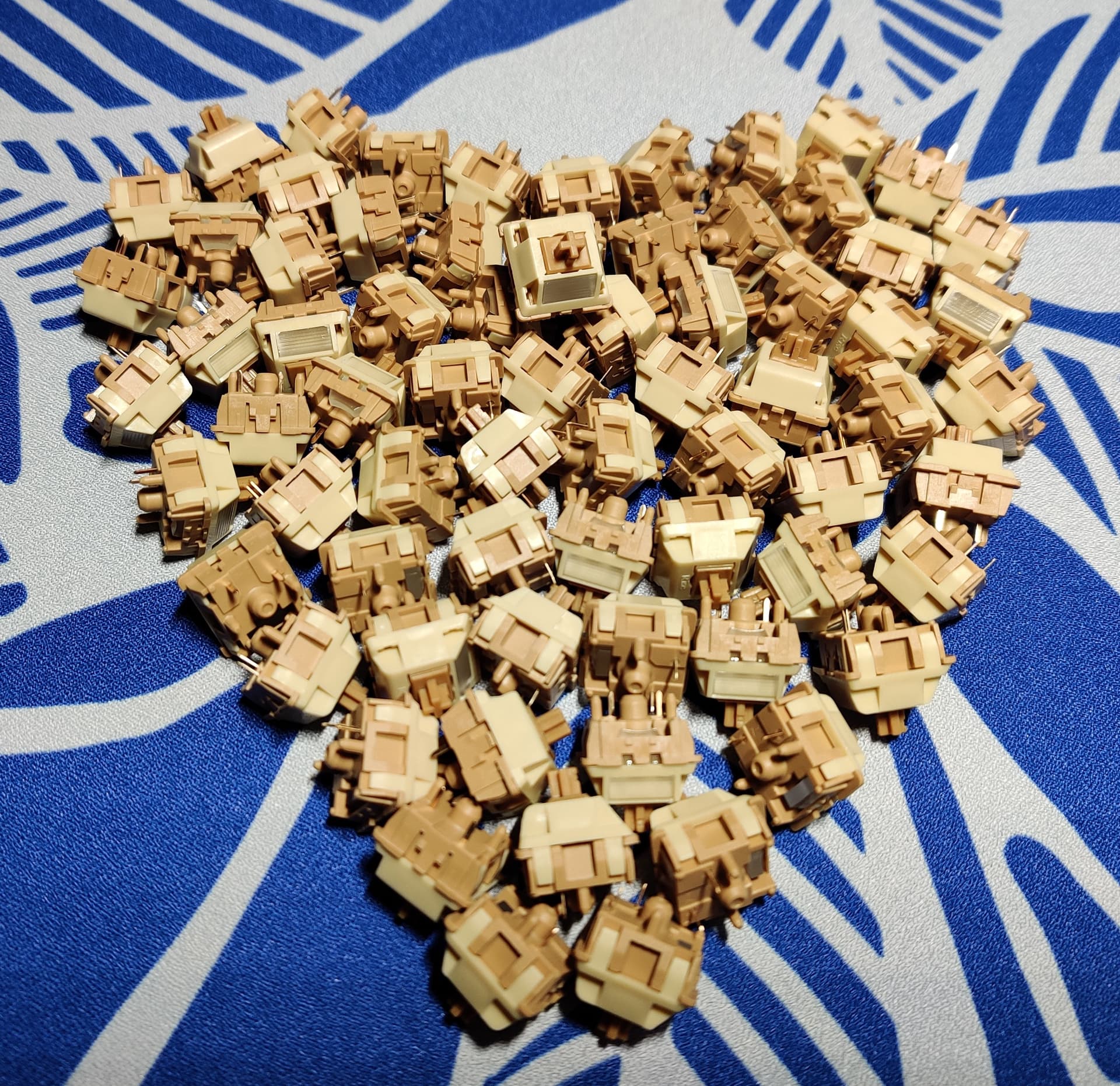

Got some Roselle switches since @donpark liked them so much. So far they are quite nice. I love the color and the spring weight too.

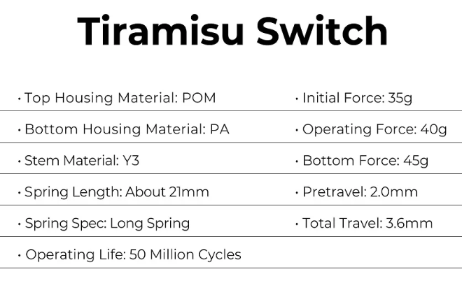

Rise Tiramisu Switch
Summary

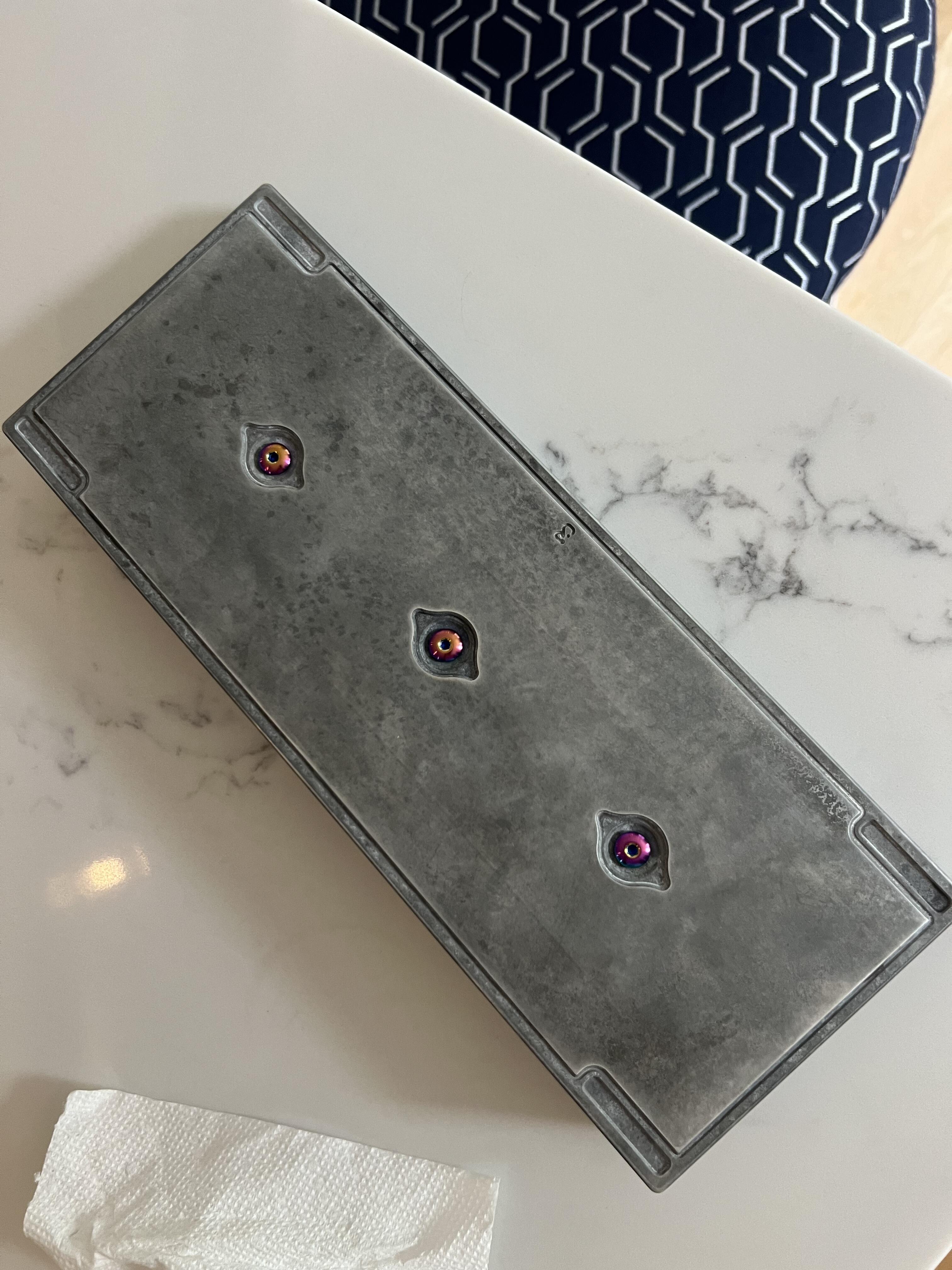

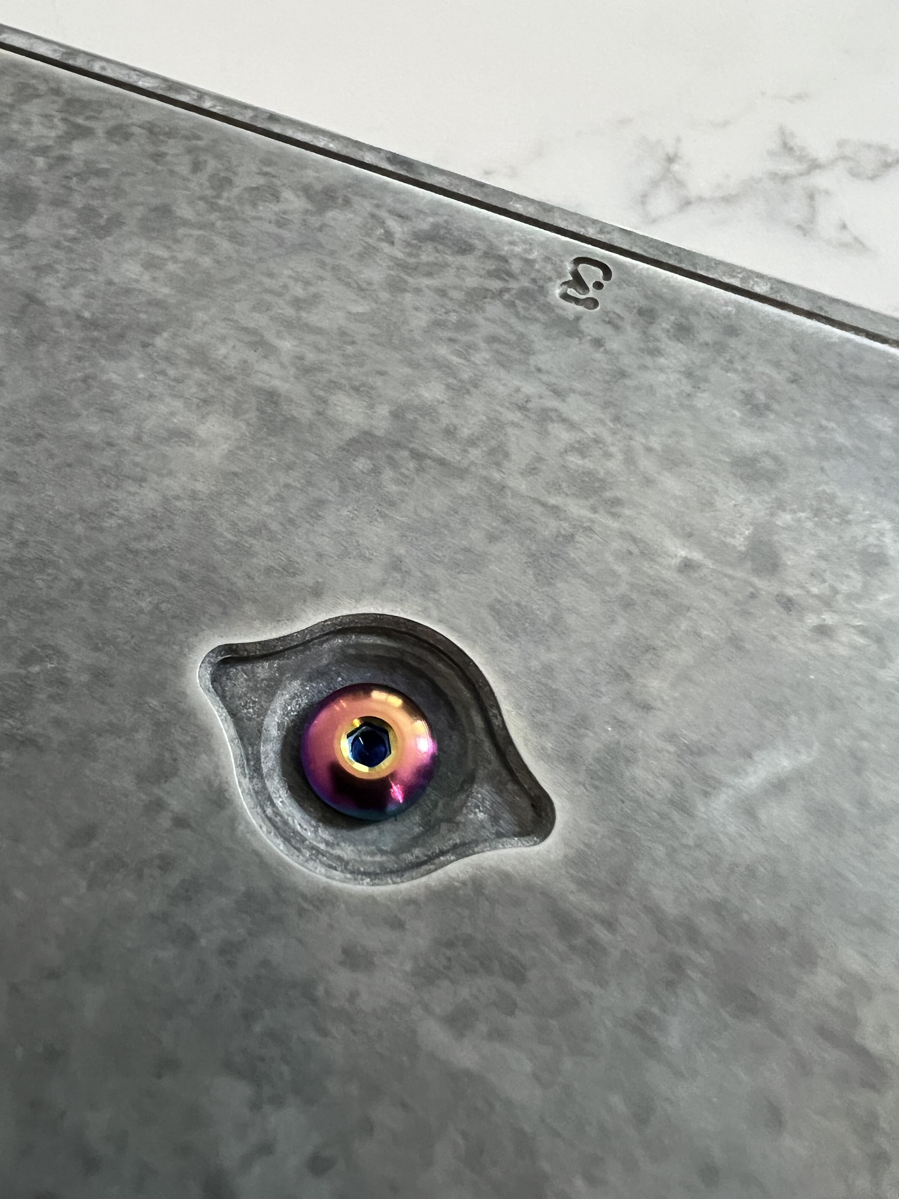

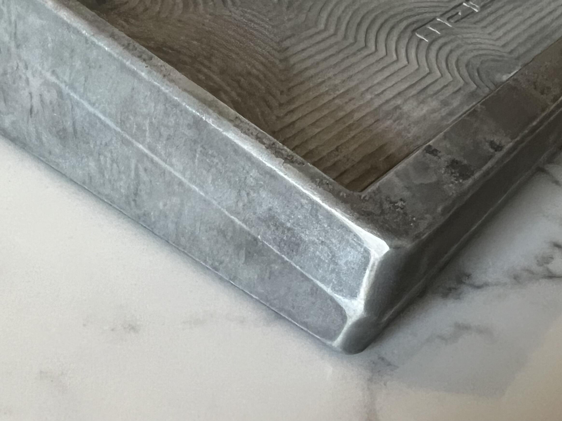

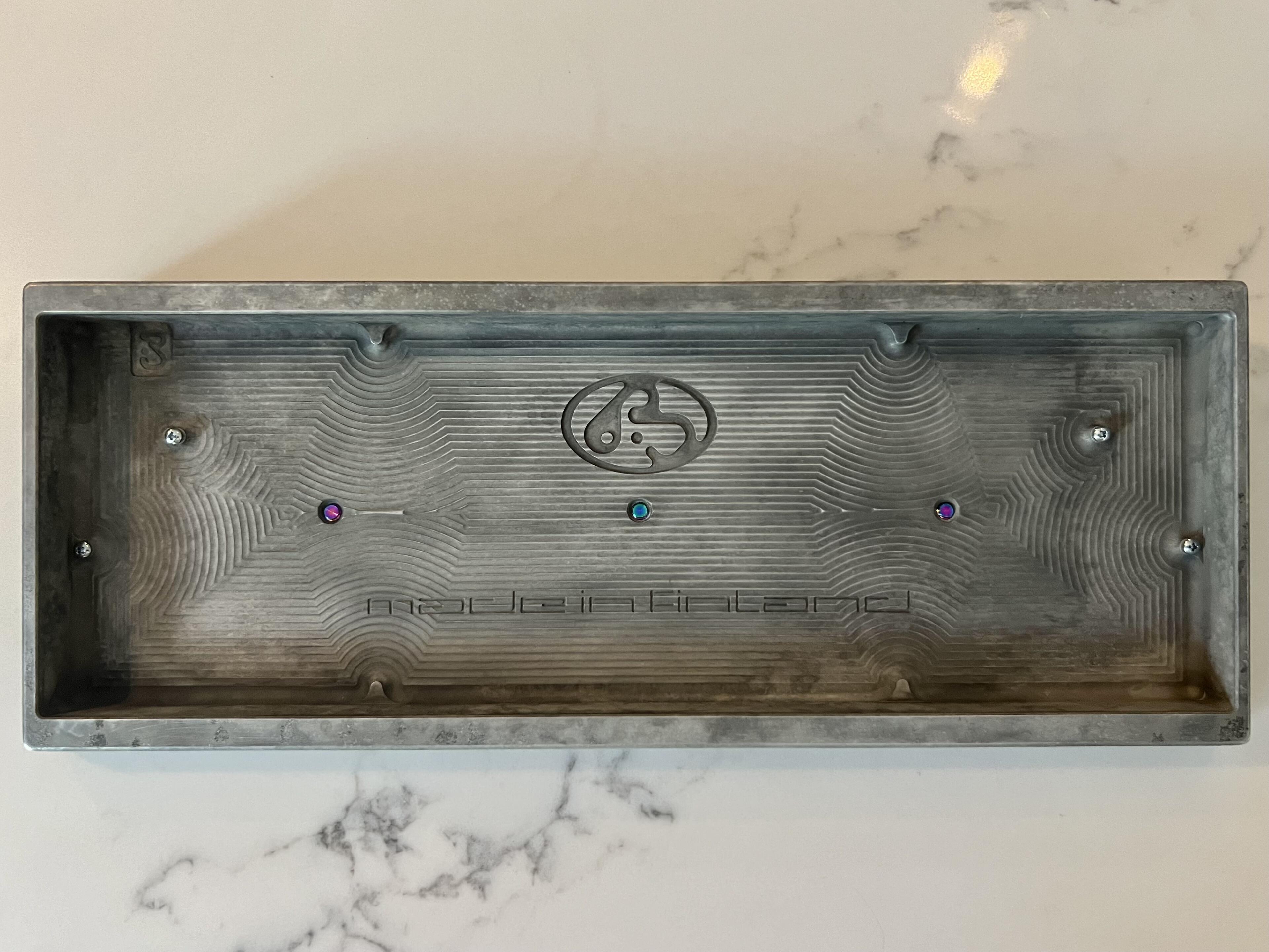

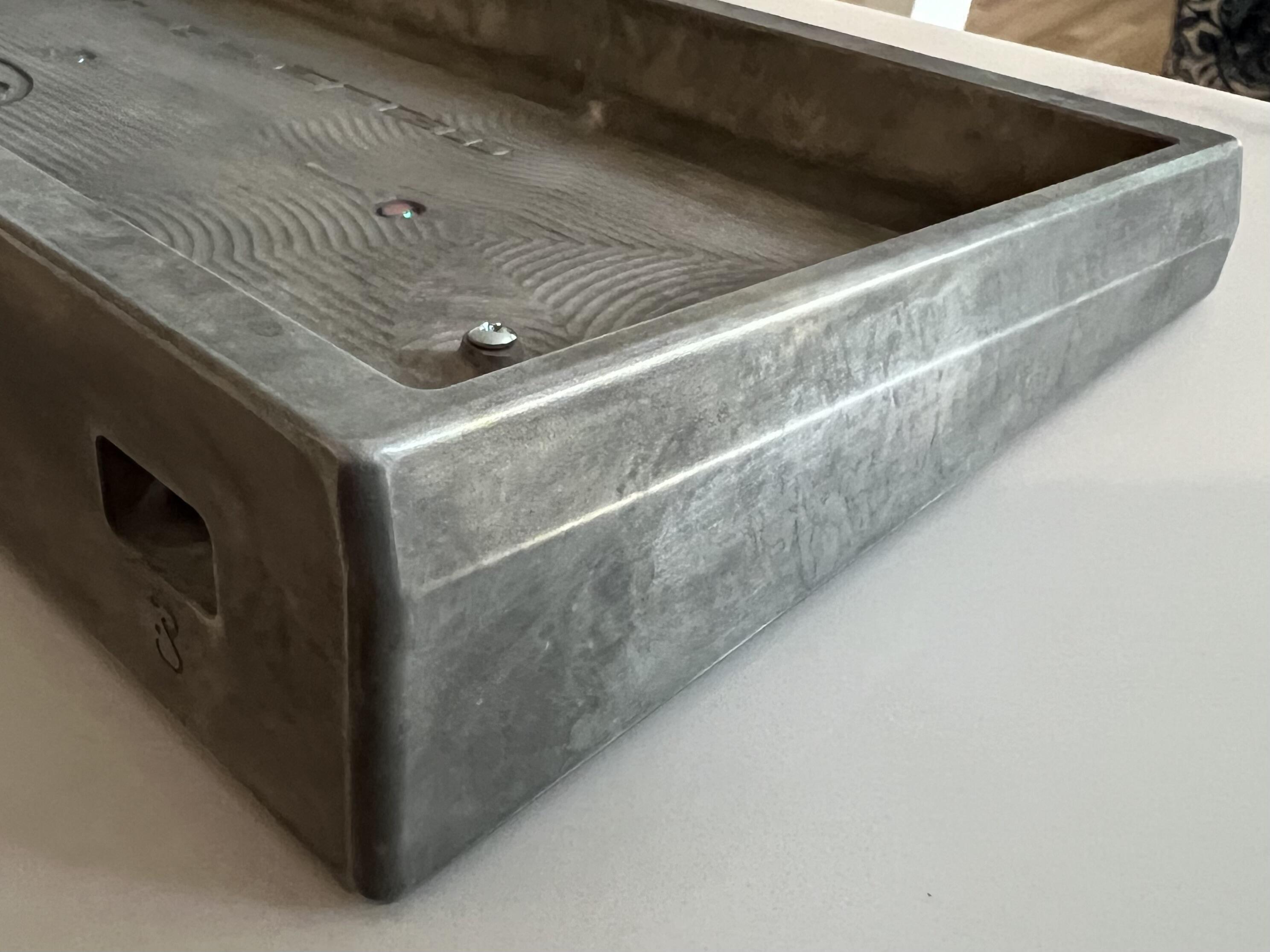

Obj-01 came today. Such a cool finish :sunglasses:
Oh my, that’s absolutely gorgeous. What is it, how much and can I get my hands on one?
