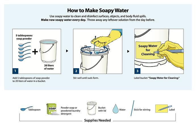

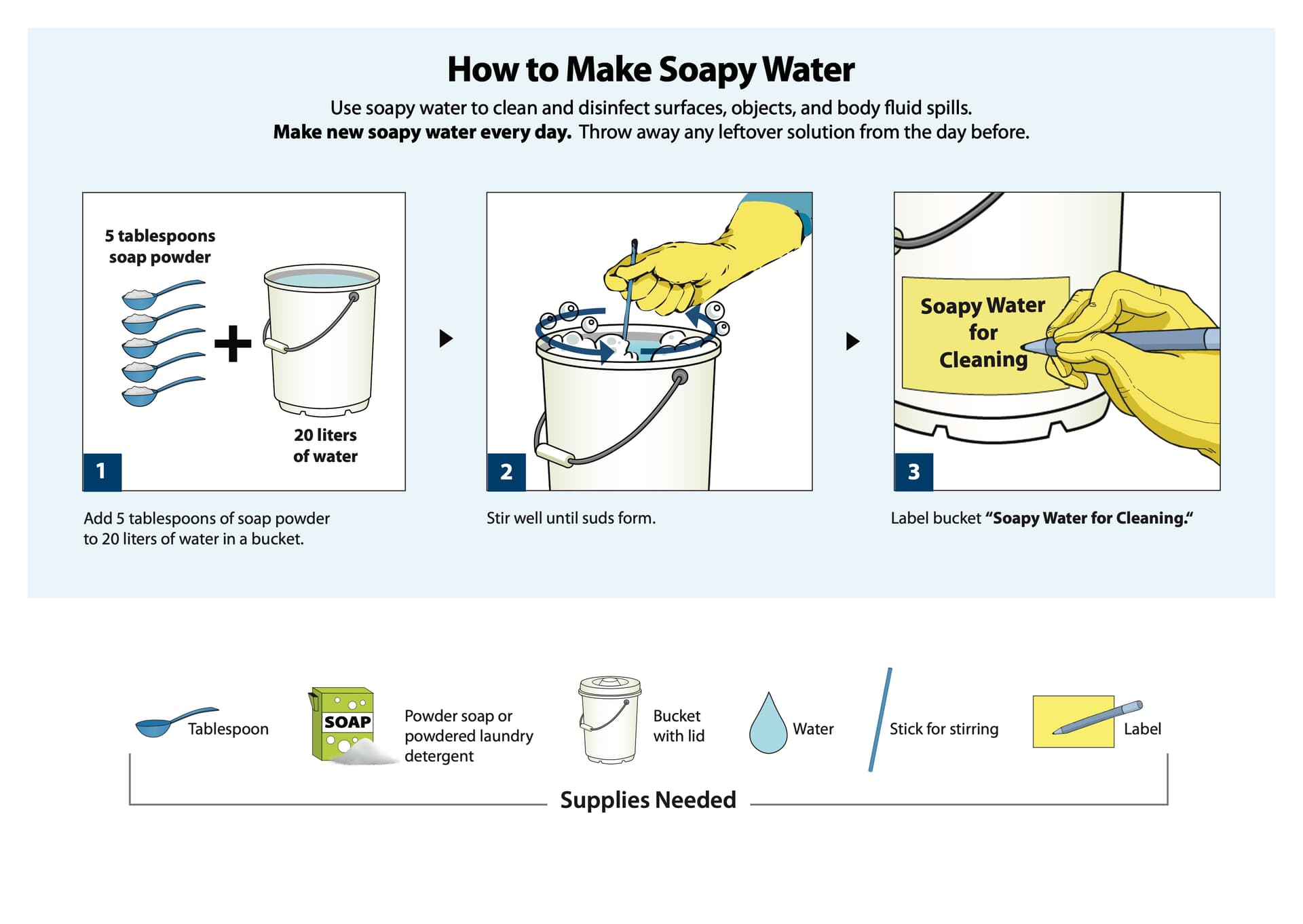

Soapy Water
Mild, soapy water is likely the safest and most readily available cleaning solution for most keyboard parts.
How to make soapy water
Source: CDC.gov
