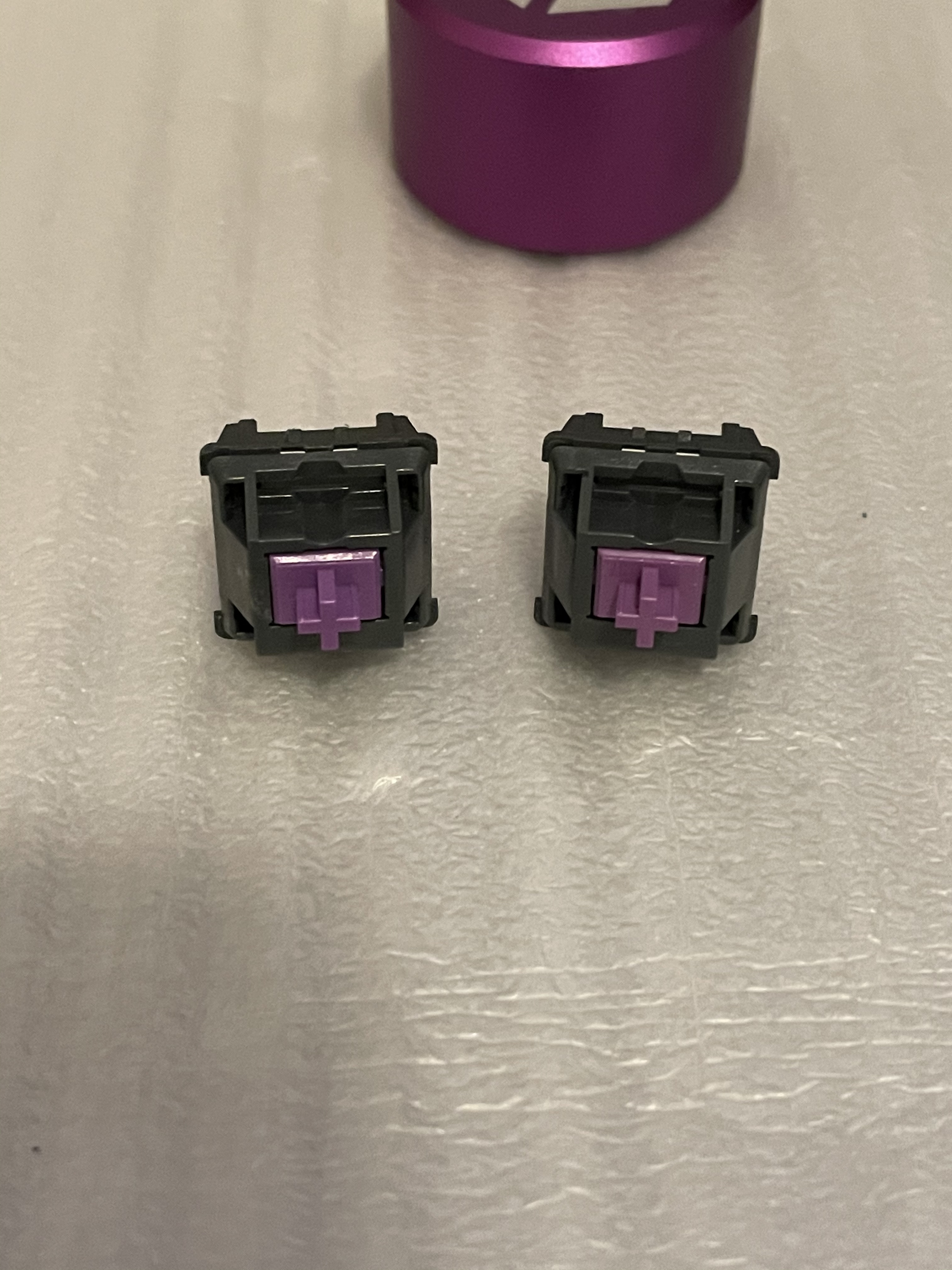

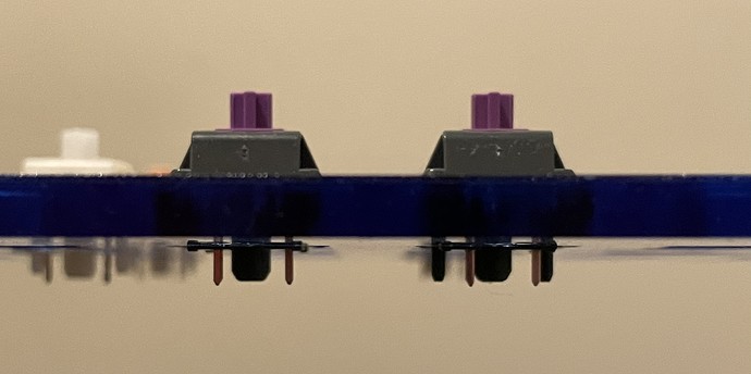

As a mini-update on the 5-pin pandas Novelkeys is now carrying, I took some photos to try to show whatever differences I’ve noticed (without having put them in a board).

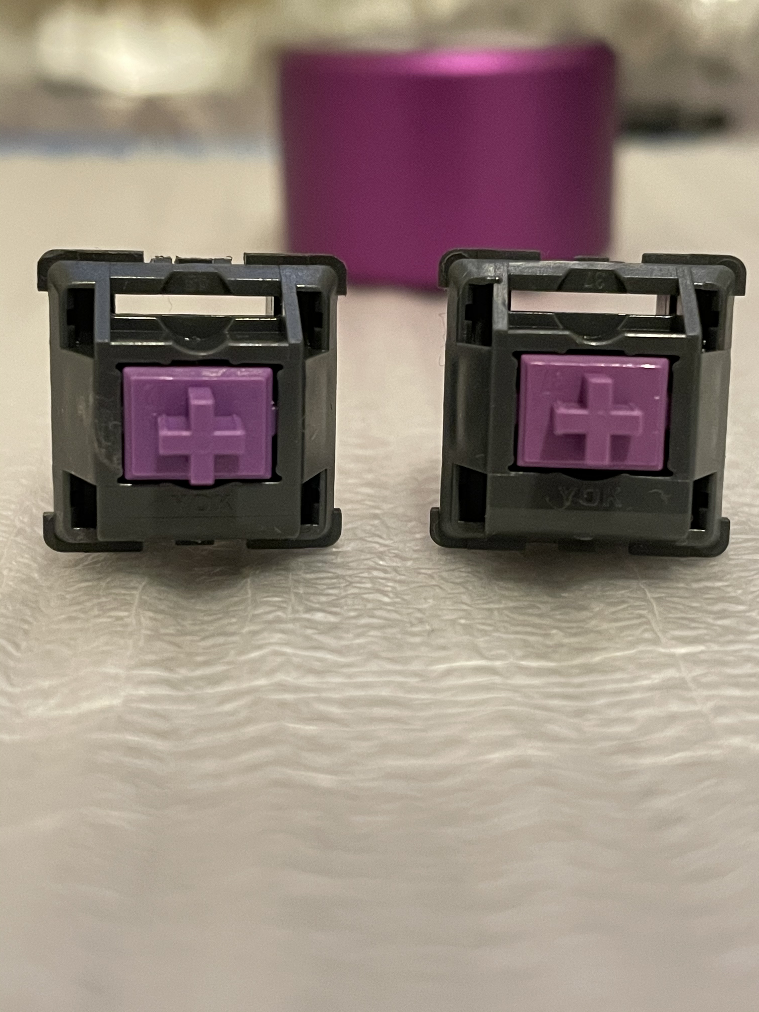

Left switch is always the old trash panda, right is always the new. Specifically, these are the ones with the tactile stem.
The two look pretty similar, although I’d note that the newer ones seem to have a very slightly warmer purple for their tactile stems
Like, really really similar. Housing color, finish, material all seem the same to me

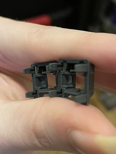

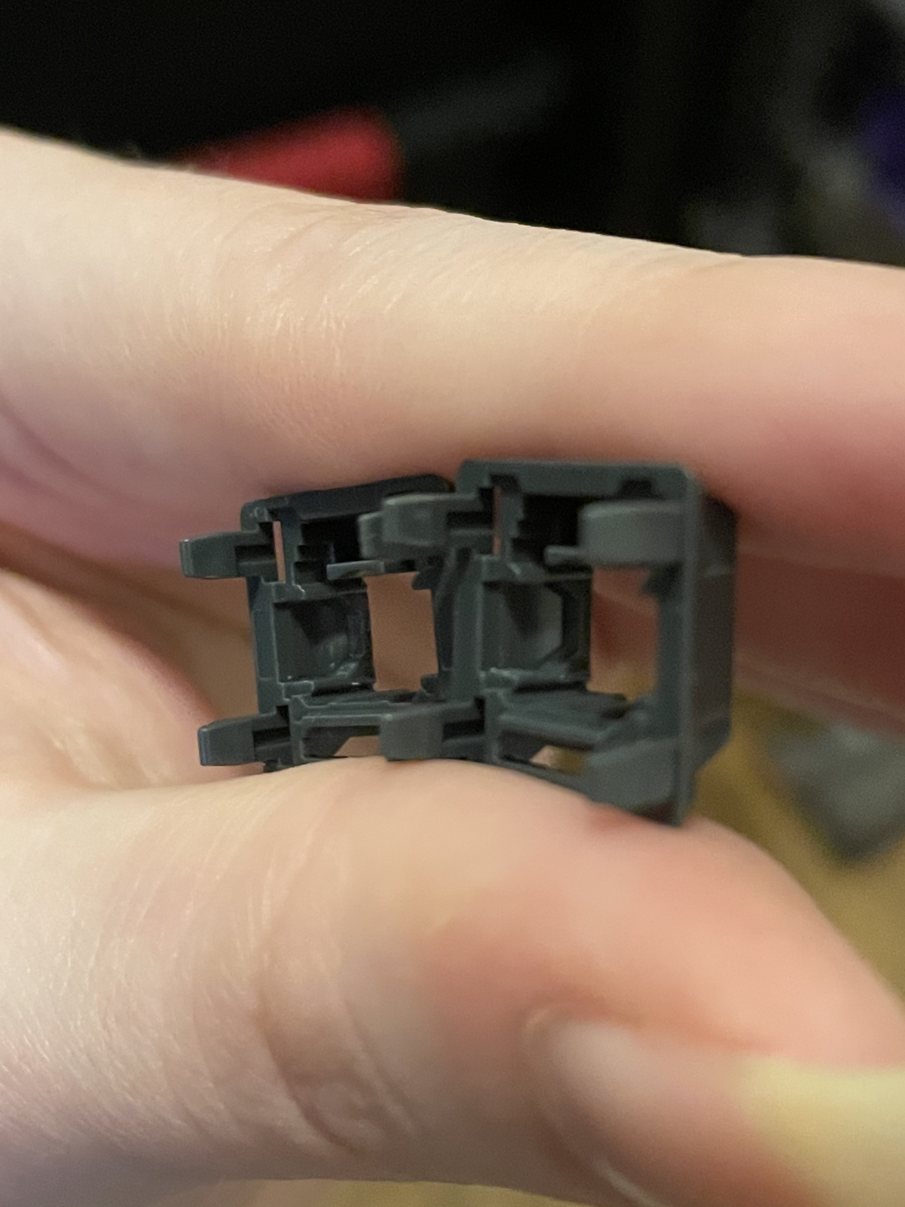

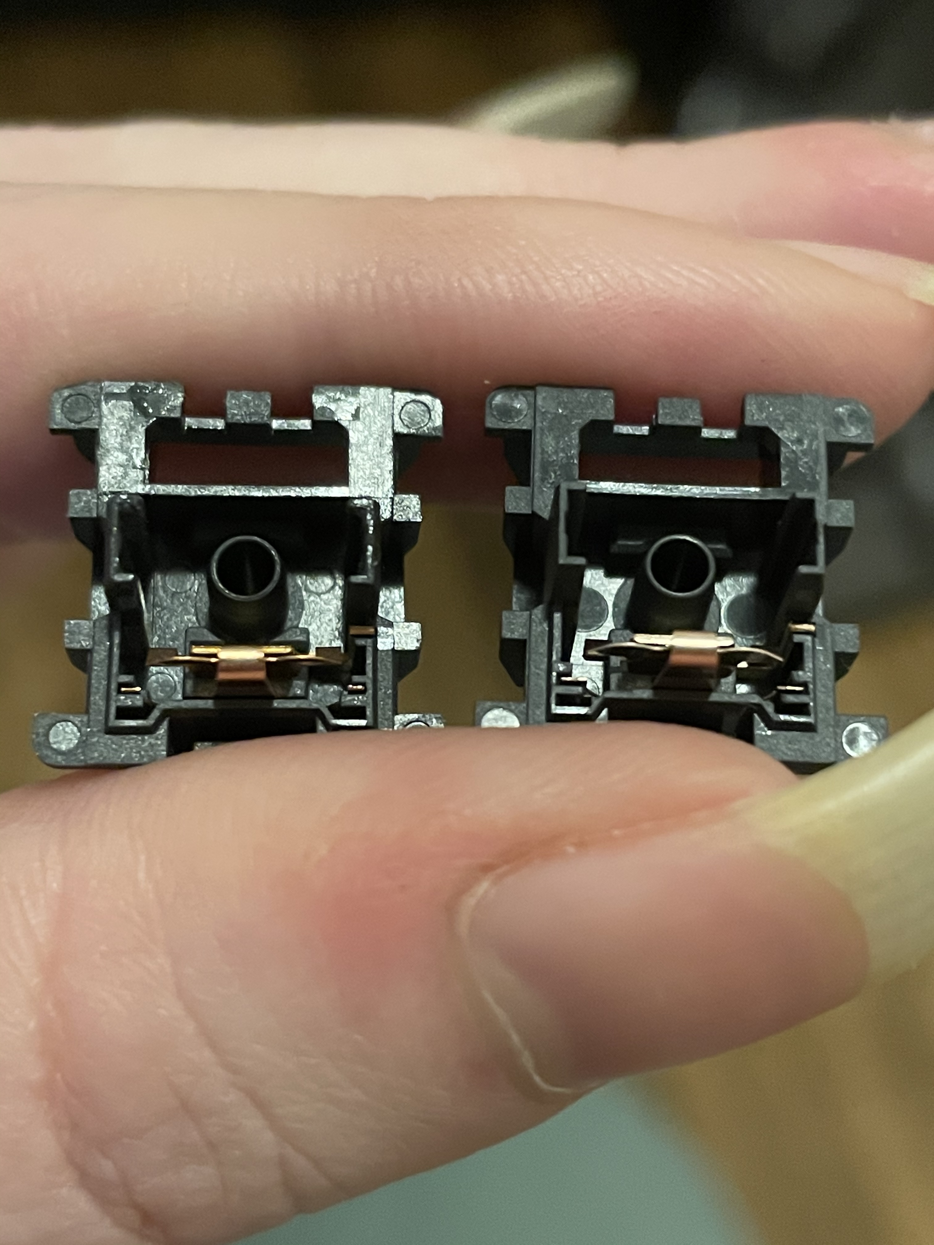

Obviously, different bottom housing molds, but nothing immediately noticeable past the addition of legs and adjustment to mold markers
Lots of mold indents seem bigger on the interior of the newer bottom housing…

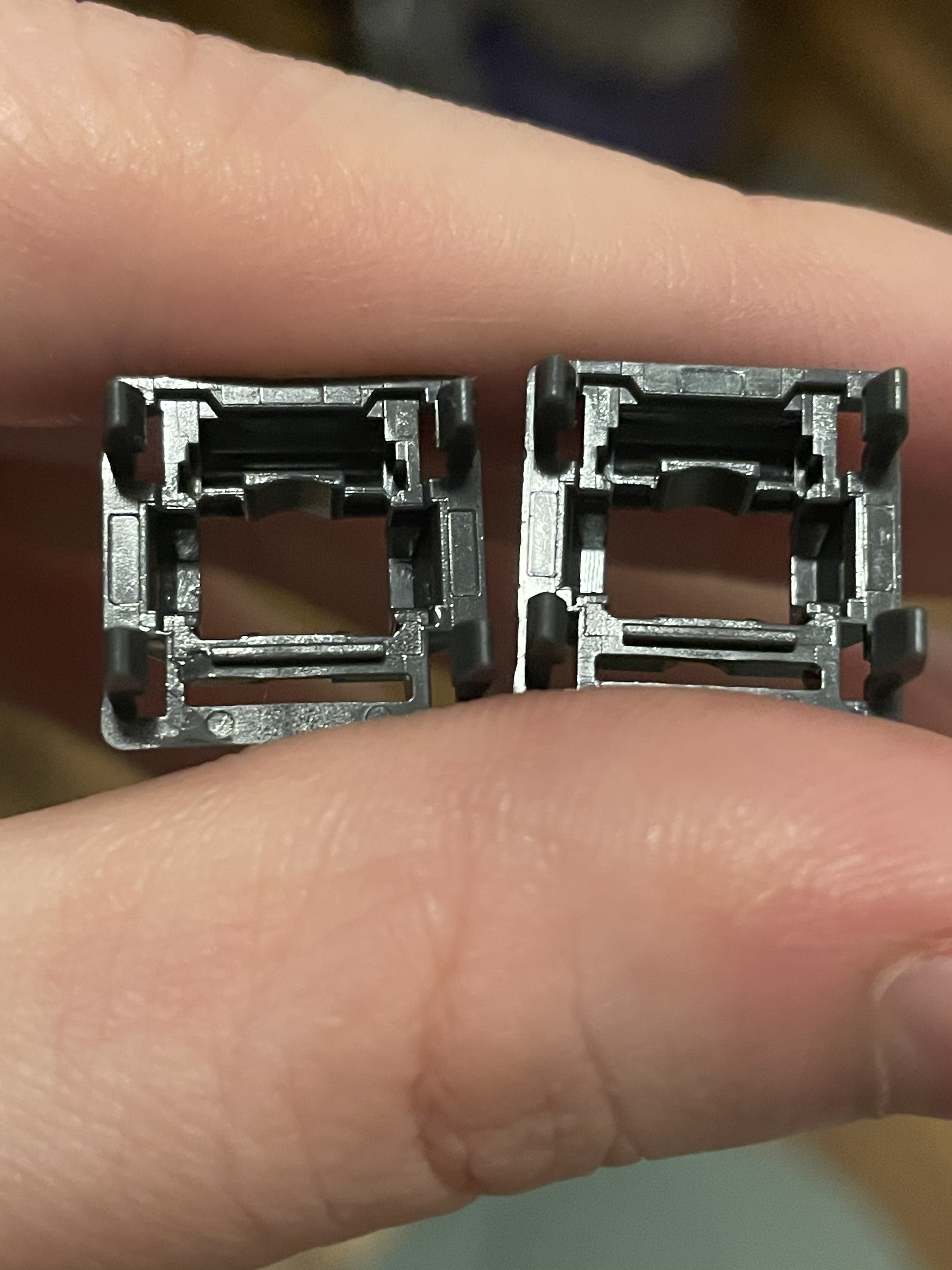

… but the biggest difference my eyes can notice is that the lubing situation has improved

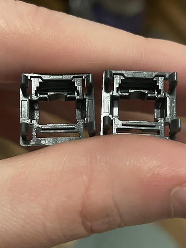

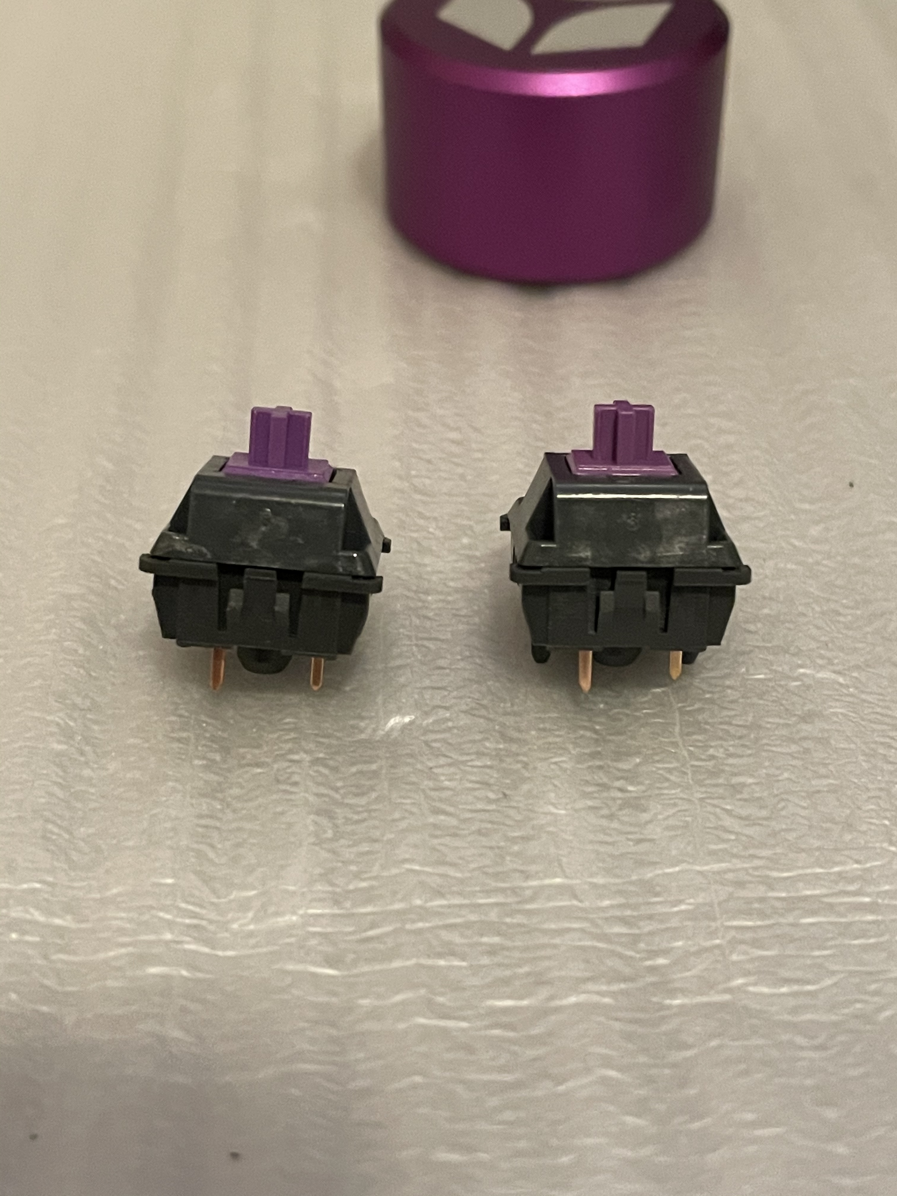

Top housings also don’t seem particularly different

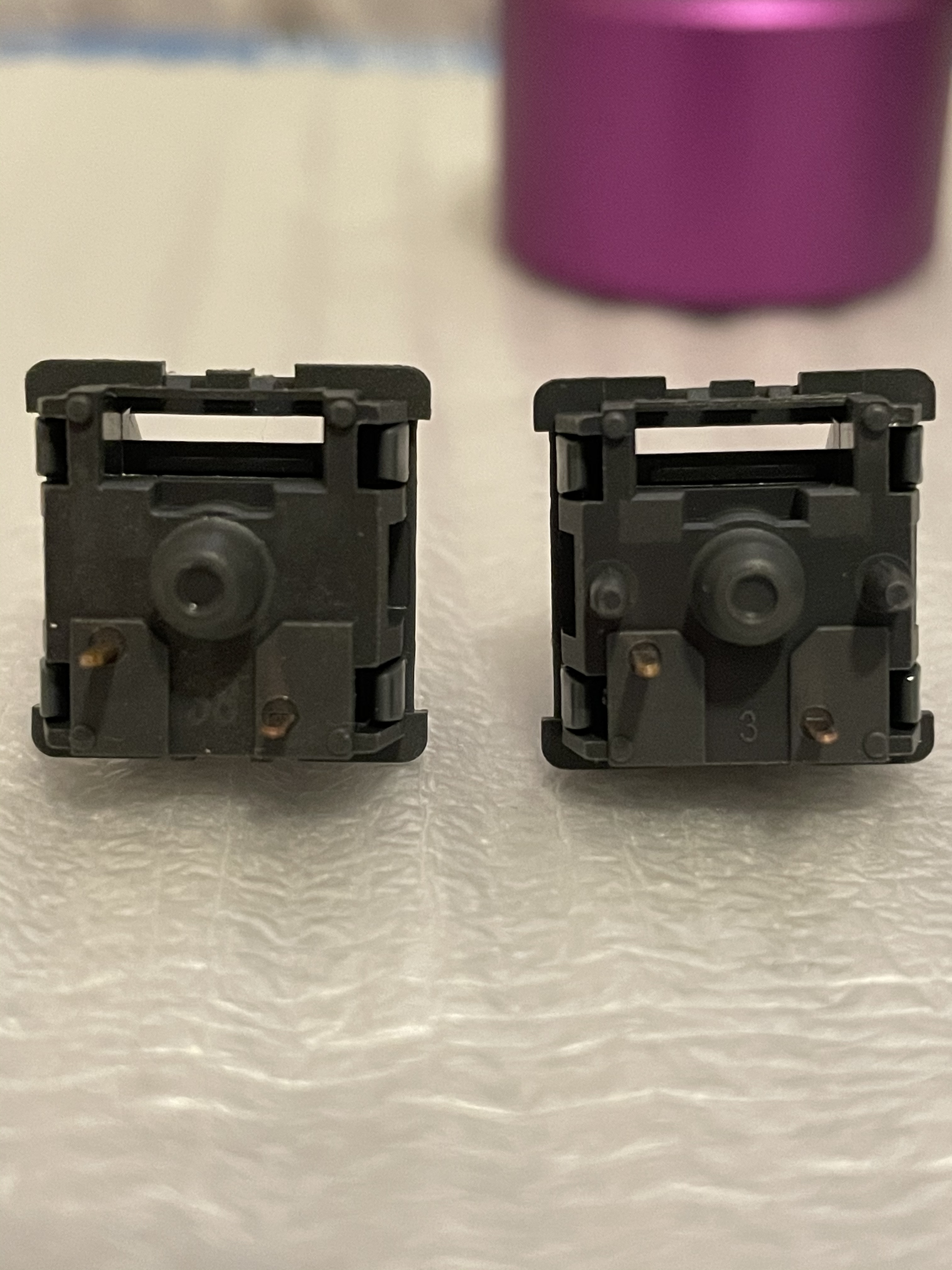

But, they’re marked differently (bit tough to see but they’re numbered up at the top, in the LED slot)
So maybe there’s a difference I’ve yet to find internally? I’ll keep looking

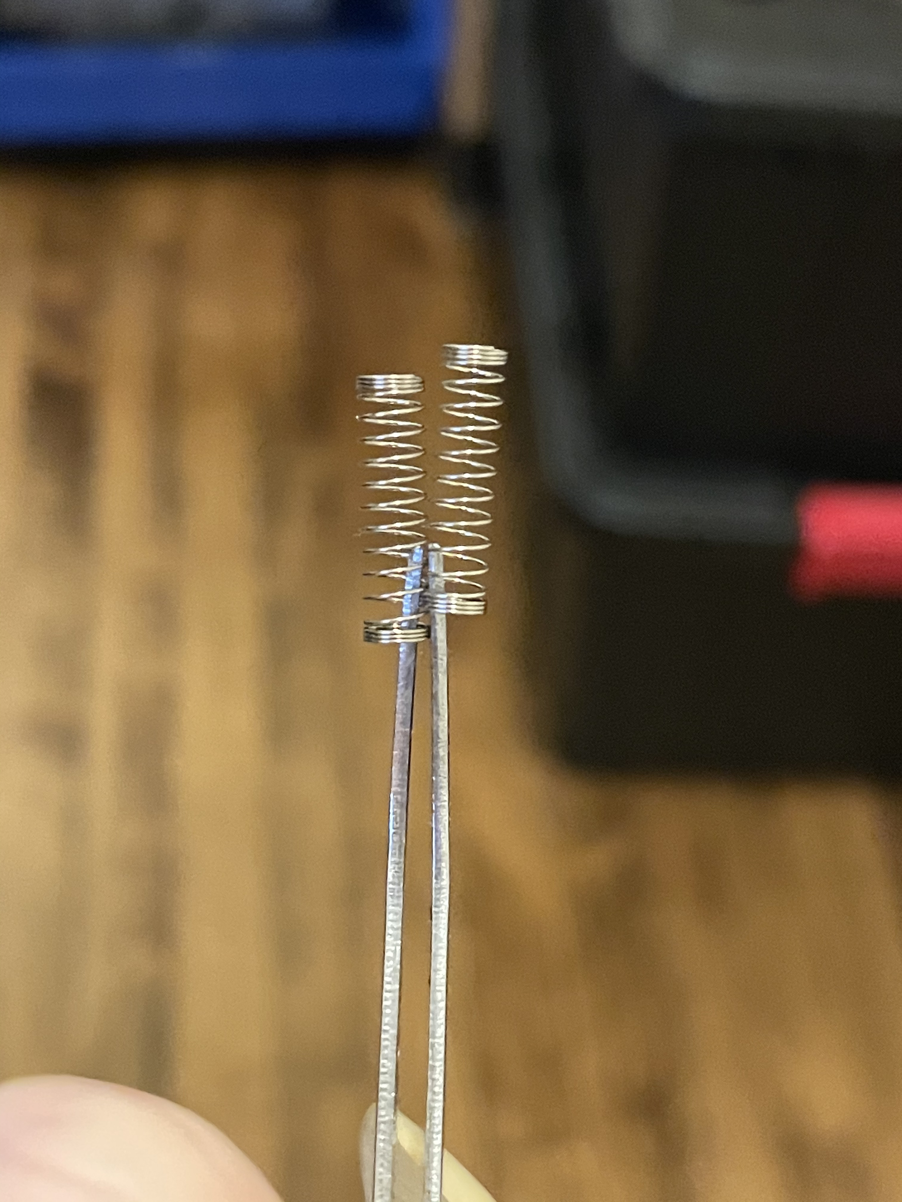

Springs seem exactly the same to me, and they’re both crunchy/pingy in the stock switches. Not a huge concern for me as I primarily use aftermarket springs these days
