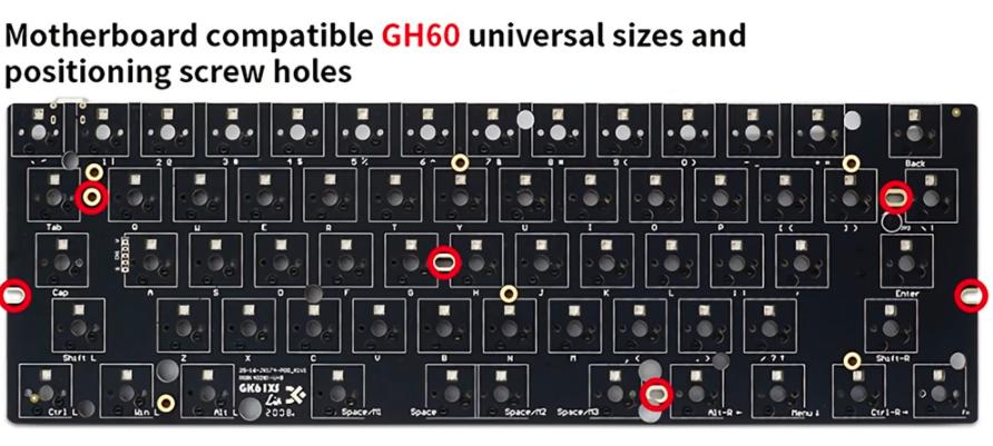

The PCB is compatible, yes! The plate and case that come with it aren’t cross-compatible like the board is, though.
IIRC, you need a pretty specific plate to retain the convenience of hot-swap, otherwise the switches themselves will be what holds the plate, which is fine - but it does make hot-swapping more time-consuming.
Unfortunately I don’t think those plates are labeled all that well - I bought two GK61 plates from the same vendor, one white and one black, and they actually had different screw patterns on them. The white one was only compatible with the GK case, while the black one was only compatible with GH60 cases. Both of them had mounting points to secure the PCB to the plate for hot-swap.
The points that attach the plate to the PCB were the same, but they attach to the case differently.
With one of them, you use the GH60 mounts and attach the PCB directly to the case with holes in the plate to access those screws, and with the other there aren’t any access holes for the PCB-to-case screws, but there are screw-holes for the GK61 case standoffs that attach directly to the plate.

The PCB shown here is the GK61x PCB. Which is a newer generation compared to the GK61 PCB (from what I know, the old GK61 PCB are no longer being produced). There are a few caveats to take note of when it comes to using the GK61X PCB:
The PCB itself is GH60 compatible, which will allow you to fit it in most aftermarket 60% cases such as Tofu and 5 degree
The stock aluminum plate comes with the split backspace module, this makes the plate non-compatible with aftermarket cases because there isn’t support for screwing down the spacebar module
The GK61x PCB needs plate-mount stabs, so you’ll need to look for a GH60-compatible plate with plate mount stabs. There are some options on Taobao and Aliexpress
