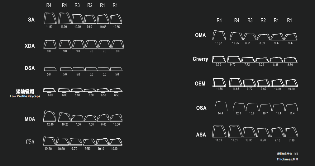

The keycap processes include PBT and ABS double-shot injection molding, PBT and ABS single-shot injection molding, pad printing, PBT dye-sublimation, and resin keycaps, available profile enclosed:
