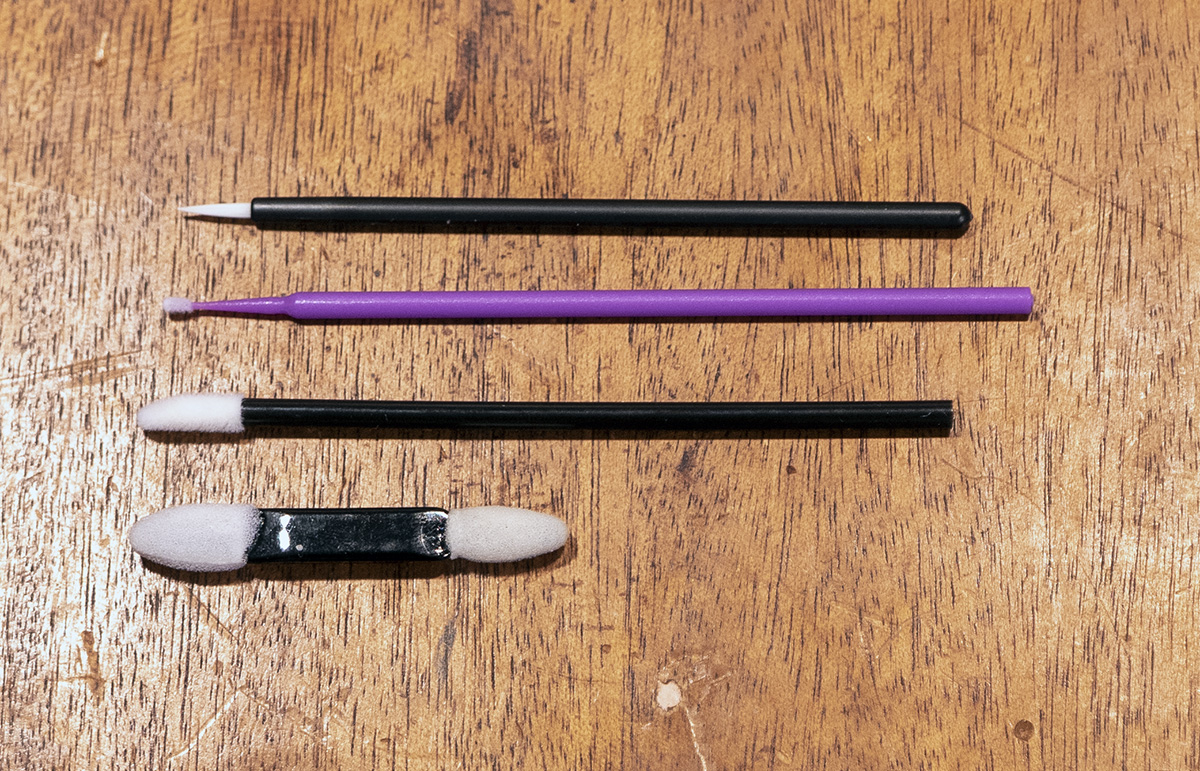

You can definitely get a whole set of switches done with one applicator. They also actually hold up pretty well as I have some that I used multiple times & just wiped clean with a tissue that are still useable. Although personally I much prefer using a fine artist brush for my lubing (like a 0 or 00 tip). I think it is much easier to control the amount of lube you’re getting on & coming off of a brush vs the applicators. That said I do a lot of painting experience & currently work for a painting company (I’m a carpenter by trade, but have experience in almost all phase of residential, commercial, & industrial construction), so me being partial to the brushes may have more to do with that than anything.
Edit: It also makes a huge difference if you get some good artist brushes. The cheap ones are really a huge step back from them as far as how well they perform. In fact I’d actually take an applicator over a cheap brush, so there is that too.
I sell lube with applicator kits as an option. These include one of the applicators we’re talking about in this thread, a tiny synthetic brush, and two types of sponge-on-a-stick. So users can choose their favourite.
And disposable plastic gloves. These are very handy!
That is an awesome selection of stuff to send along with lube! Most place I buy from you’re lucky to get a few applicators with it, not that I really mind that, but that is definitely a sign you’re going above & beyond which would make me want to buy through you if I wasn’t in the US & closer to AU!

From what I’ve seen, they appear to come in several sizes, which some manufacturers distinguish with different colours.
Some lube applicators.
