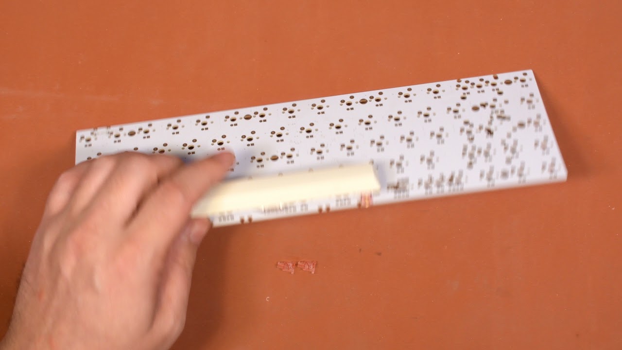

A new stabilizer mod for Durock stabs to reduce rattle
Here’s the mod:
Here’s before and after:
