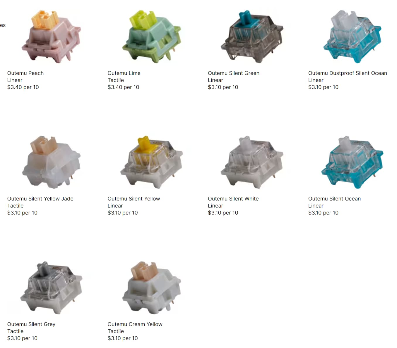

Interestingly, Milktooth has some Outemu silent switches that I had never heard of before:
Specifically, the “Outemu Silent Green” (not to be confused with the “Lime”) and the “Outemu Silent Yellow” (not to be confused with the “Cream Yellow” or “Yellow Jade”) may be new switches? I couldn’t seem to find these two varieties from other vendors.
Also, they have two versions of the Silent Ocean, with or without the “dustproof” stem.

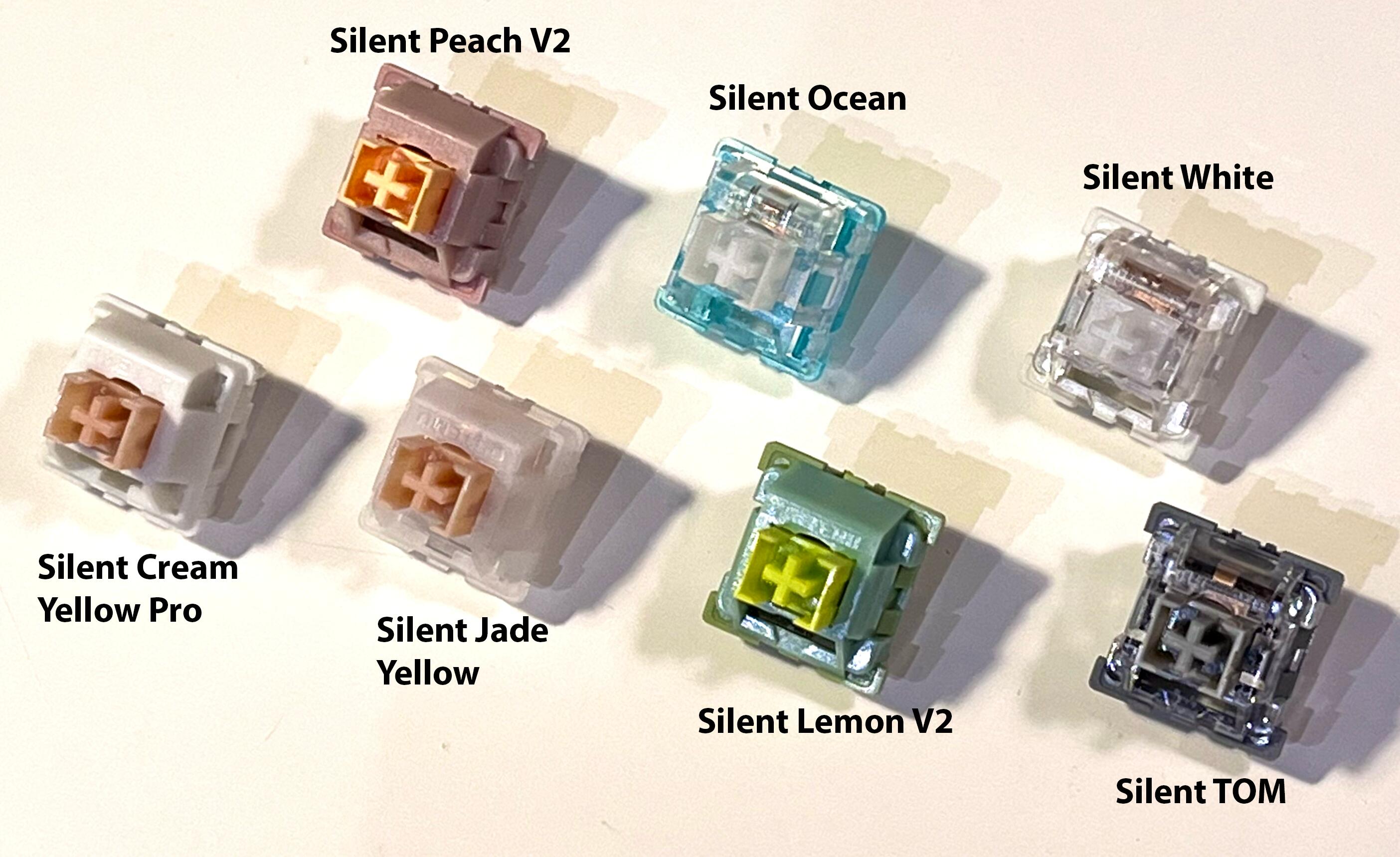

Just reporting back on the Outemu samples I received recently from Aliexpress. I did a blind test of the silent switches on a keyboard I have already (RK84 with foam mod) and found that the Silent Cream Yellow Pro was my favourite in terms of silence and feel.
I was surprised at how quiet most of these switches were, coming from RK Red switches. I couldn’t notice a significant difference between the Silent Cream Yellow Pro and the Silent Jade Yellow in terms of volume, but I did enjoy the former over the latter’s feel.
I was disappointed with how scratchy the Silent Peach V2 felt, and the Silent White felt too mushy. Interestingly, I believe the linears would be ever so slightly quieter than the tactiles if the scratchiness was not there, but overall I found that the tactiles did not have a significant difference in how silent they were compared to the linears.
Some of the switches that I found to be too loud for my needs were the Silent TOM, Silent Ocean and the Silent Lemon V2.

Yes, the SCY is a very popular choice, these days.
I, too, preferred the Silent Cream Yellow over Silent Jade Yellow in hotswap. In-hand, the Jade actually seemed better. But the Butter Yellow seems a little easier in a board.
The sound difference isn’t much. Currently, it seems that the reason to pick Jade would be RGB.
The “Pro” OUTEMU switches you tried are better-lubed than the older-generation Silent Lemon and Peach.
That’s why the Peach seemed scratchy, and the Lemon loud. I can tell you for sure that Silent Lemon is much quieter with 3204. Quieter, in fact, than stock Butter Yellow.
But there’s no point discussing them - the Silent Cream Yellow Pro V2 is a good switch, and is popular for a reason. And if you’re looking for a smoother silent linear, try JWK/Durock Silent Alpaca or variants, or Bobagum.
