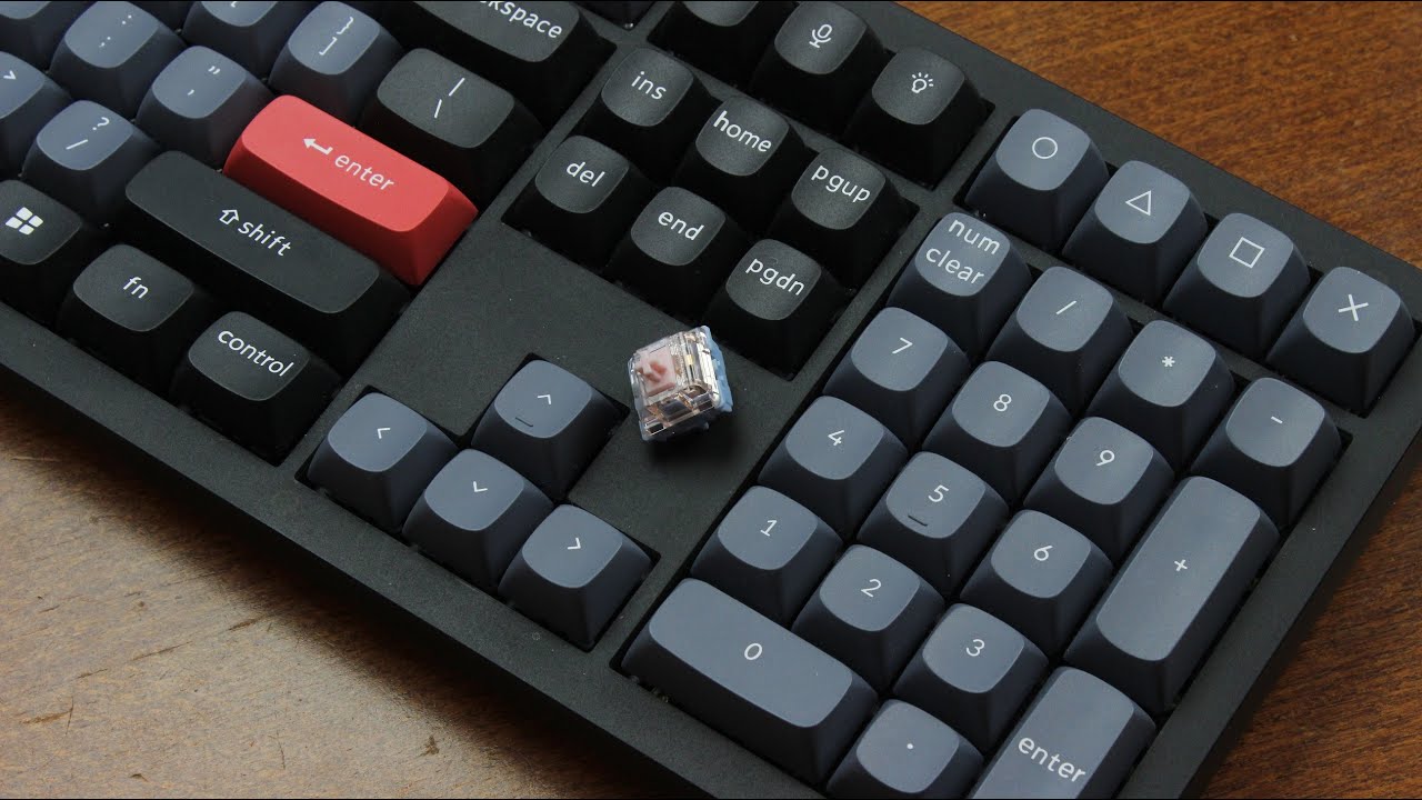

Somebody actually wrote about the foams:
One of the reasons I like the idea of the Keychron Q-series is because I believe you can order them with dampening materials.
However, because of the Q-series weight, you might want to consider the Keychron V-series. It is like a Q-series, but plastic-case. Unfortunately, I think V-series lacks the Q-series gasket-mount. You could still use it as a silenced keyboard, but Q-series mounting should be a little nicer.

Also, here’s a recent review of the Keychron V6:
