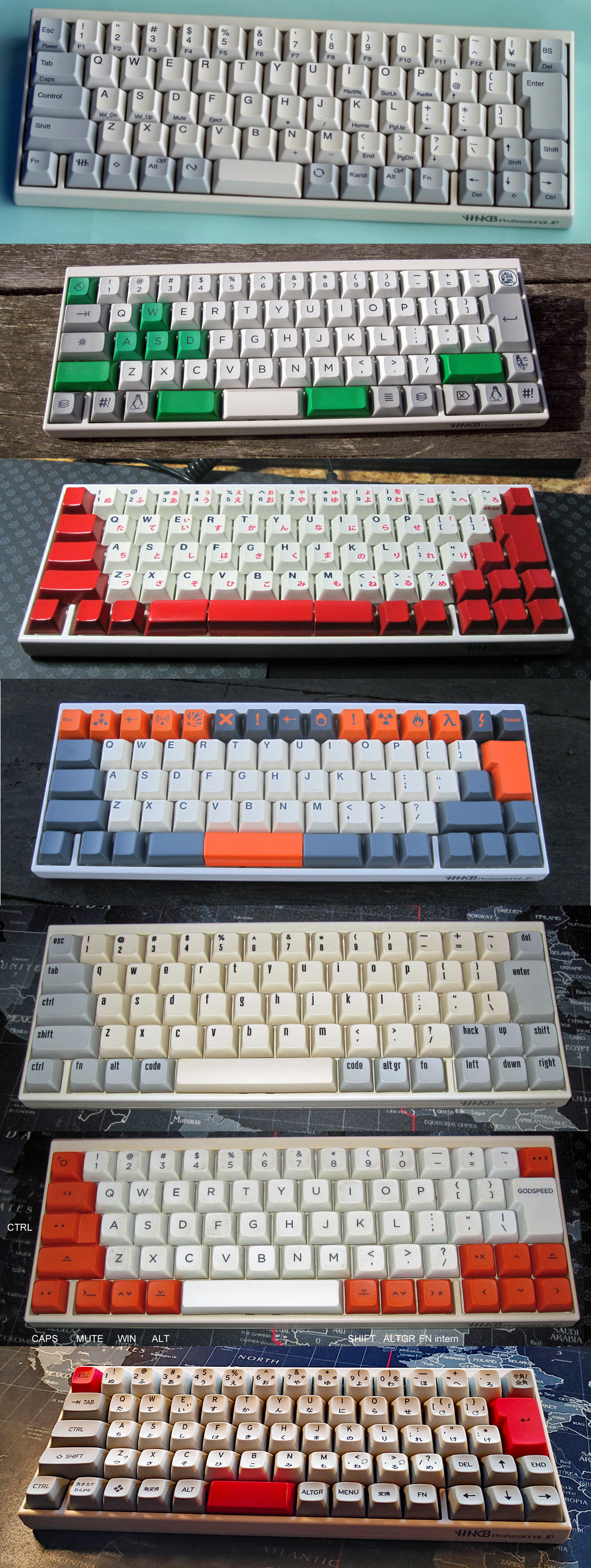

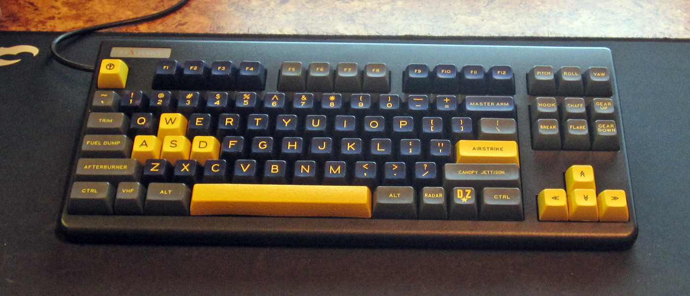

What I really love about Topre and JP layout is the flexibility of the bottom row.
The only limit is our imagination, a quick collage of some older pictures, even 6.5u works fine, but that’s way too big for me.
Sweet setups!
How did you do the 2u Right shift & longer spacebar mods?

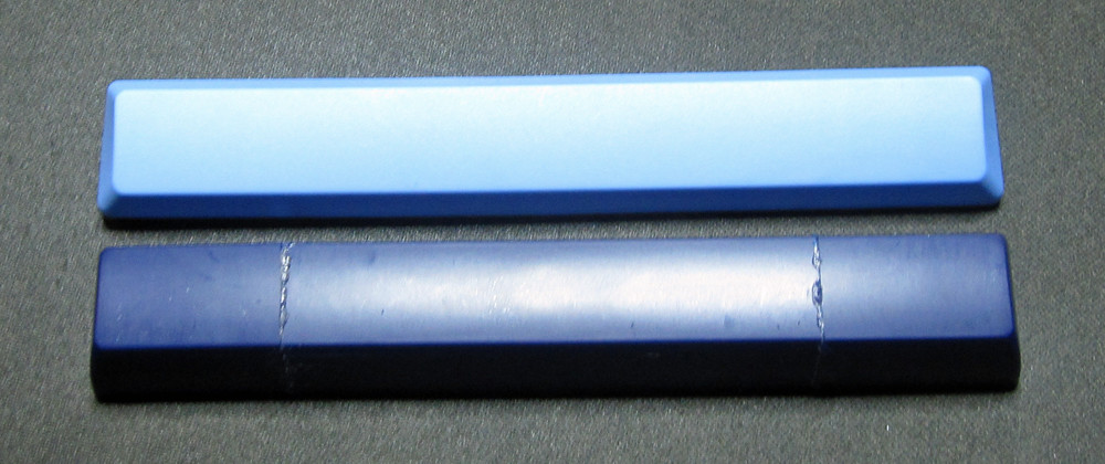

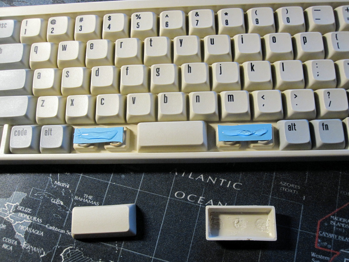

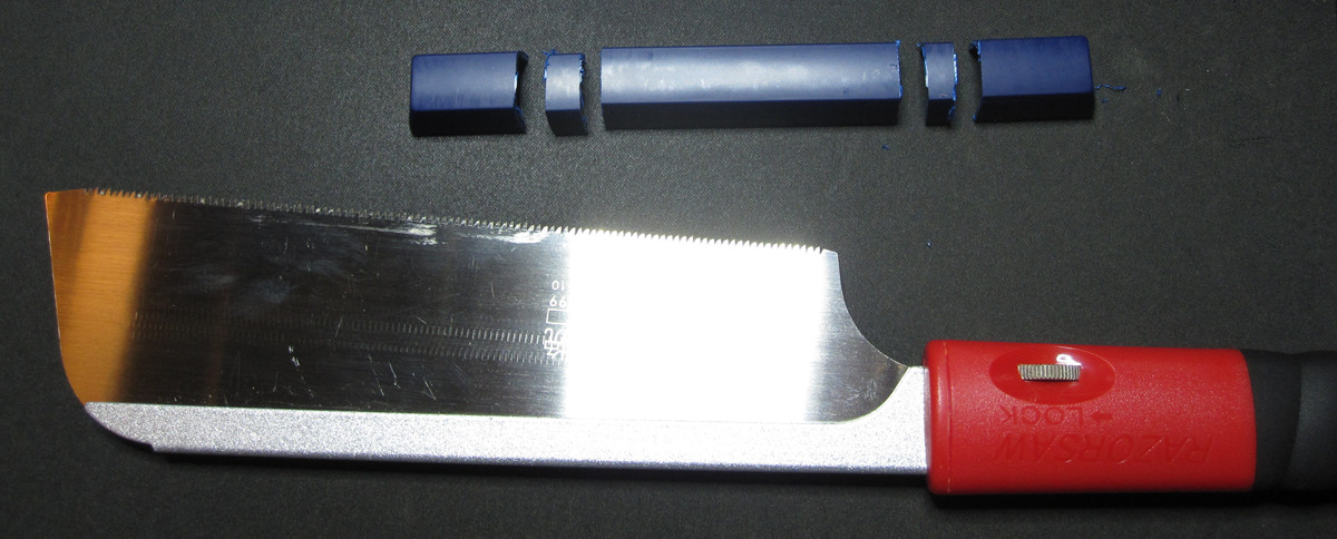

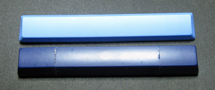

4.5u spacebar as example. Keyboard disassembled, middle key as usual with dome and spring, outer keys, left and right without domes and springs, just the sliders working as stabilizers.
This is only going to work if you attach the spacebar, keyboard disassembled, otherwise the outer ones can’t be attached.
This way I’ve built myself a 6u SA spacebar many years ago for a Realforce as example:
The first one, picture shown, wasn’t perfect, but you learn from trying and get better!
I hope this helps to let your imagination fly!
