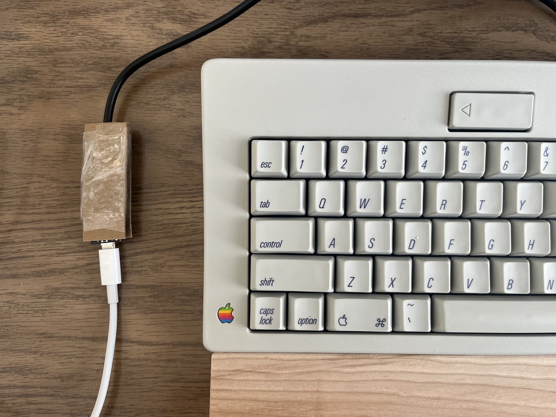

It works!
Not the prettiest dongle I’ve ever seen, but maybe I can find a small project box for it or something.
Thanks @wjrii for pointing me in the right direction.

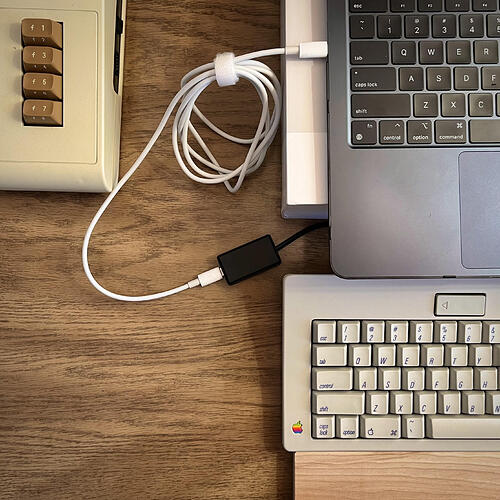

Ok, I stuck it in a project box. Now it looks… almost disappointingly low-profile and unremarkable!
More seriously, it’s even smaller than a few of the commercial solutions, which is sick. And unlike commercial solutions, you can easily customize the firmware to adapt the layout, which is pretty handy given that the M0116 is a little strange by modern standards. I’ve adjusted the placement of arrows and mods to be more intuitive, as well as added a function layer. Hasu and TMK are awesome.
The keyboard could actually work as a daily driver now!
