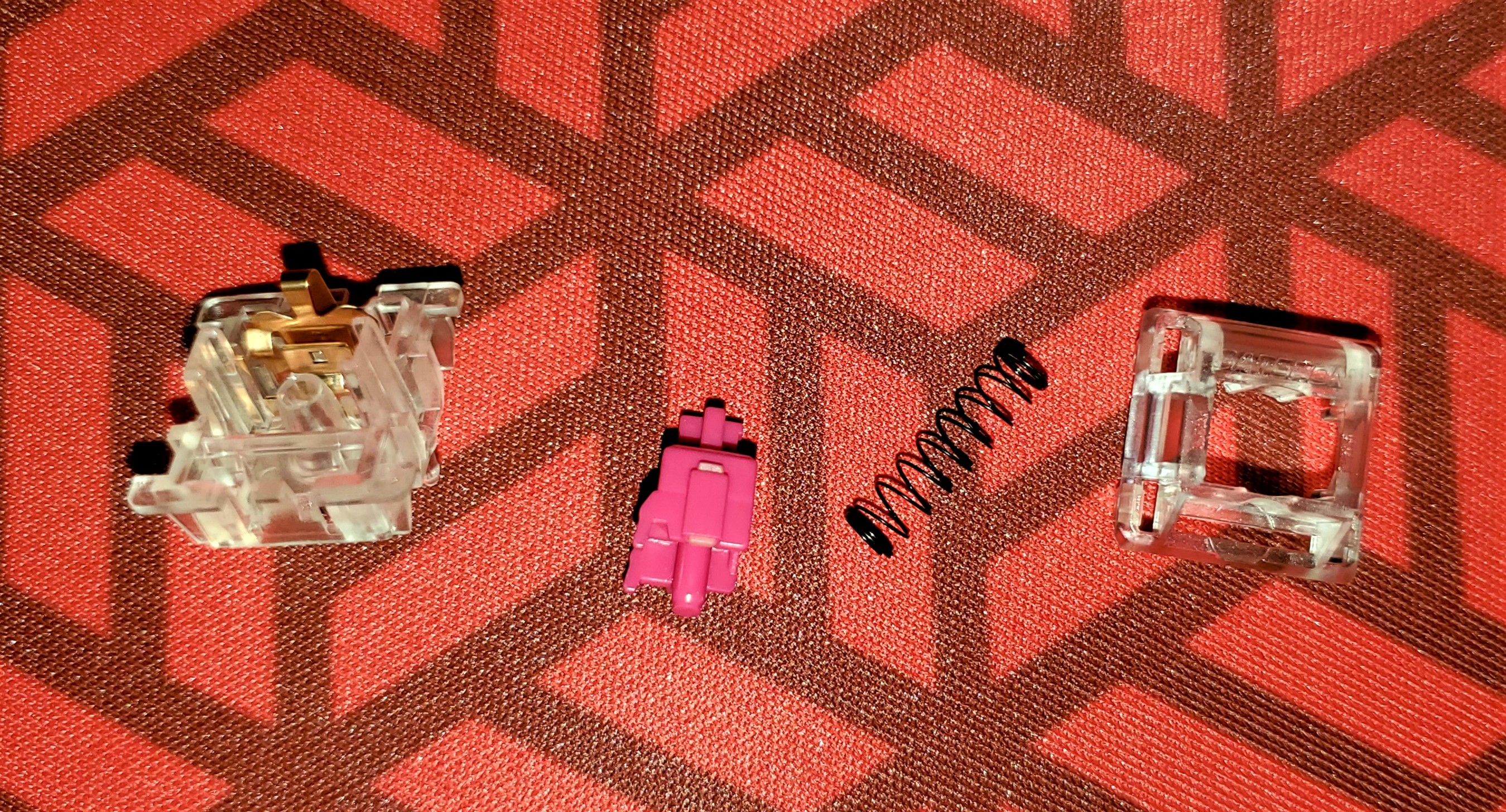

So I really don’t have any extended experience with Aliaz switches, but can answer some of your questions at least & provide you with some other info. I have a few sample switches of each weighting, for any personal experience I talk about. I used the 60g variant for the pic I’ll provide down further.
  1. How do they hold up? - Like I said I can’t personally confirm this, but I do believe Aliaz are serviceable switches from the samples I have & what I have heard from people who have used them in a build. I’ve never heard of them dying out of nowhere, having chattering issues, or anything like that. The housings compare really well to Zealio housings & some people have used them as alternative to Zeal housings for MX Zilents. The only thing I think really isn’t up to snuff with them is the black spring they come with, very crunchy without any lube.
  2. Aliaz tactility is right on par with Cherry & Gateron browns, actually they feel even a little less tactile since of the heavier spring weightings. Smoothness wise they smoother than Cherry browns, smoother than Gateron brown/silent brown in milky housing, & just a tad smoother than black bottom/clear top Gateron browns IME. Sound wise they are they loudest of the three to me, between the spring noise & higher pitched sounds the all clear housings tend to make they do not sound good for a silent switch IMO. Although I should say I haven’t found a silent MX switch I really liked the sound of to be fair.
  3. Searched in haata’s files & elsewhere, doesn’t seem to be force curves available for them yet. Maybe @HaaTa or @Manofinterests could run the tests for them if asked nicely :wink: since they haven’t being documented yet.
  4. No, the rubber bumper is molded into the stem like all other silent MX stems, here’s that pic of a disassembled 60g Aliaz.
