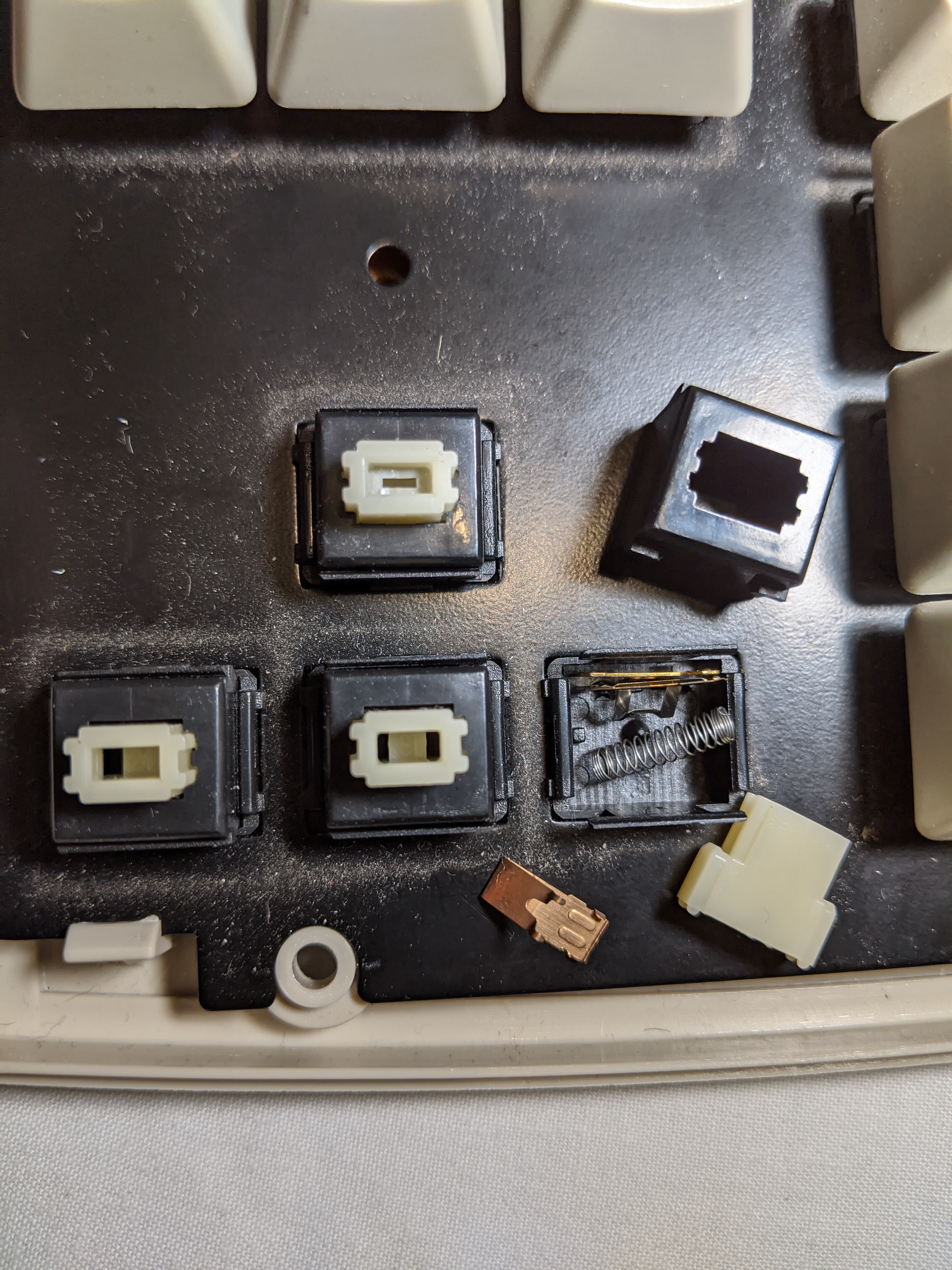

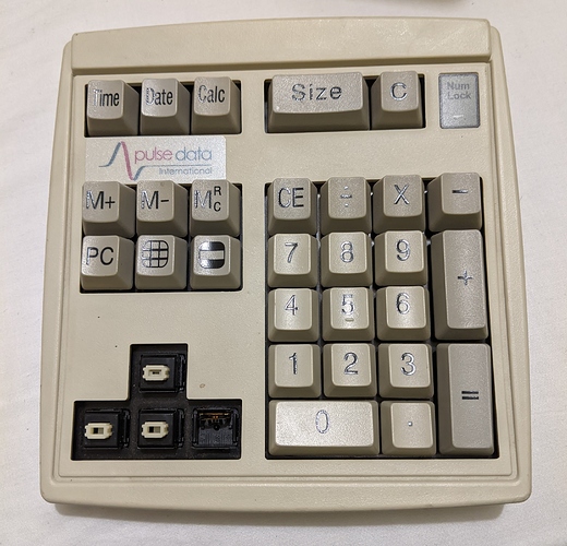

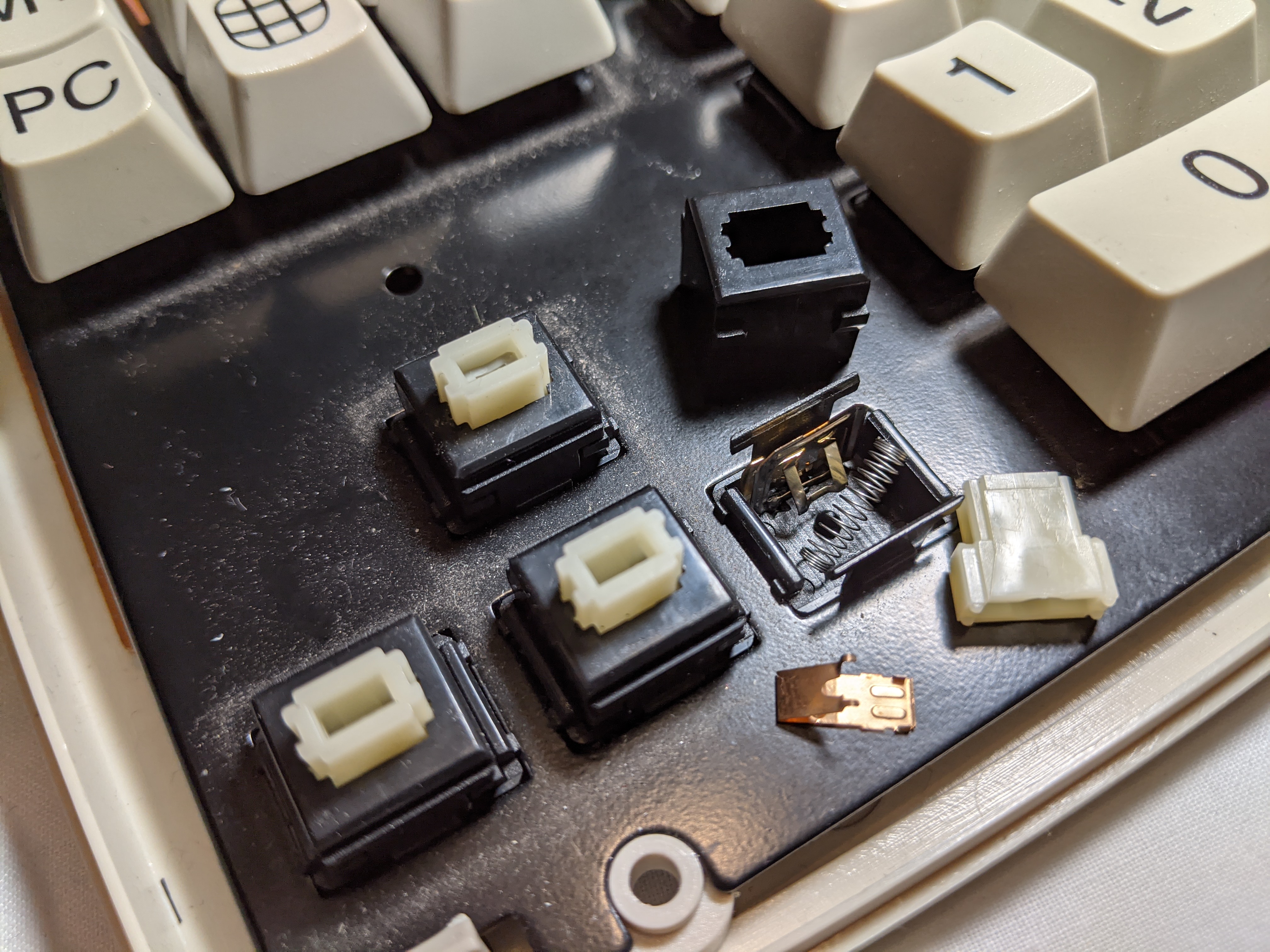

Anyone recognise these Alps clones?
They are clicky, that’s pretty much all I know.

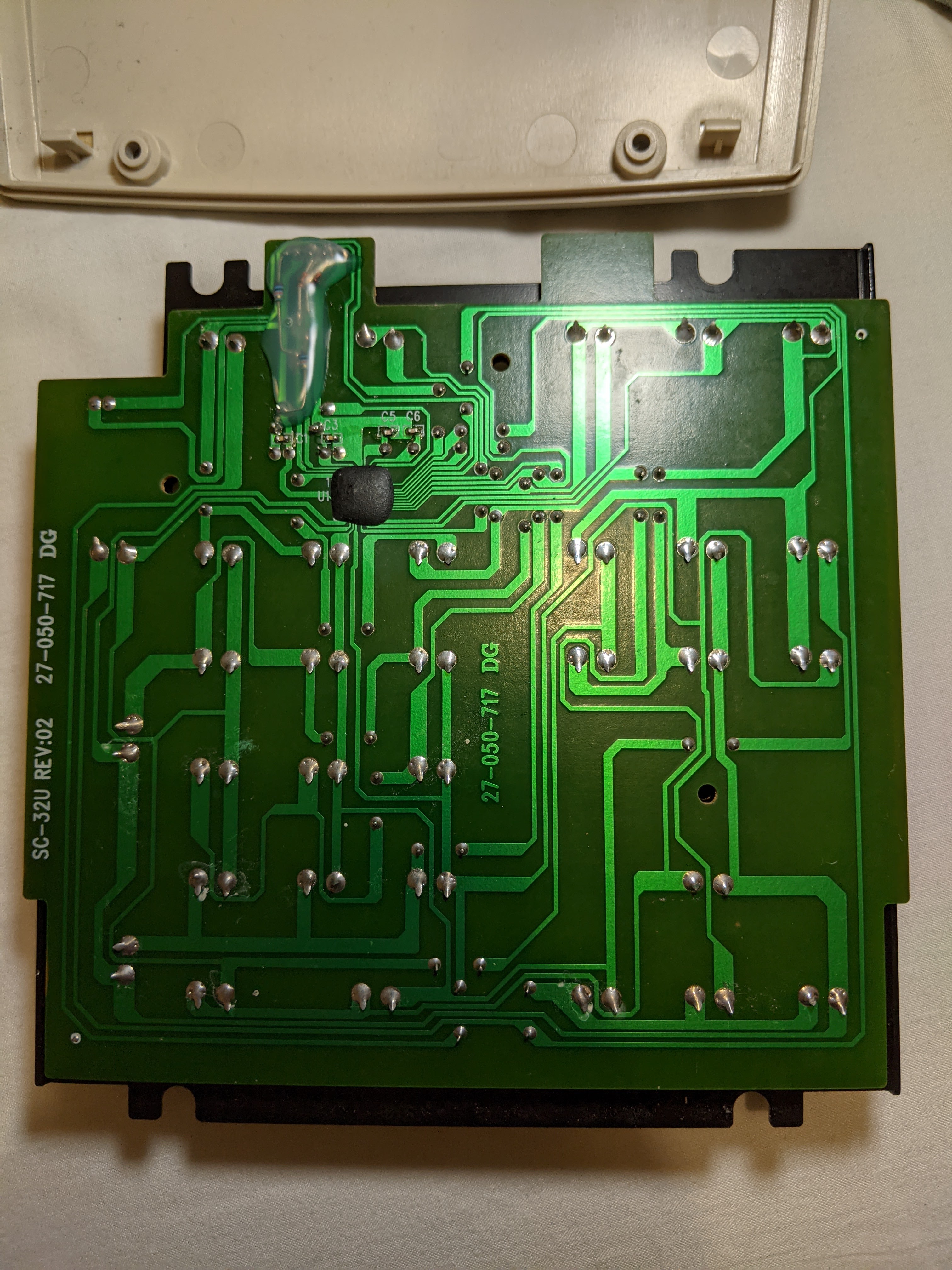

PCB (I have no idea what the numbers mean):

Found the wiki on DT for the keypad, but it is said to come with MX blues or Aristotle MX clones no mention of ALPS clones? As for the switches themselves, my guess would something from the Hua-Jie AK series. Honestly putting up a post asking about the keypad on DT would probably yield you the best results.
Thanks mate!
I posted the same thing on DT and someone said AK-CN2 from the Hua-Jie AK series. It matches the description from the wiki as well, so I guess thats what these are. Awesome work!
