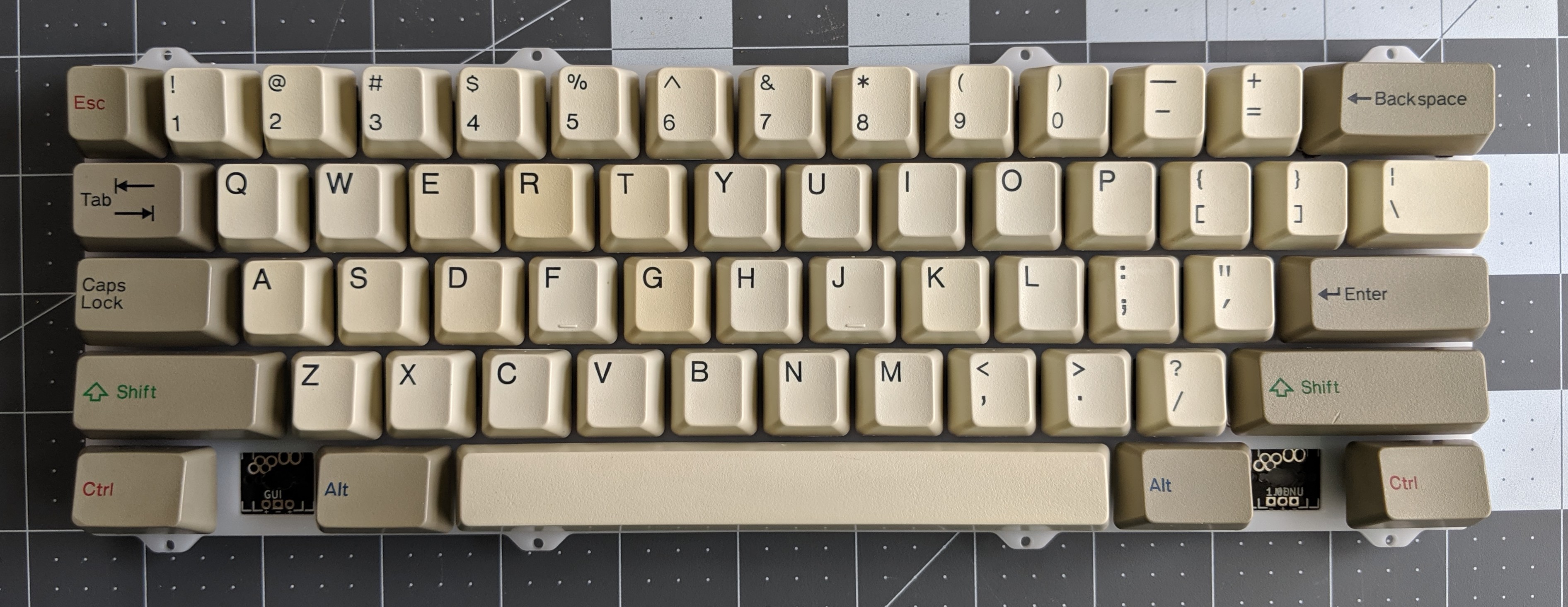

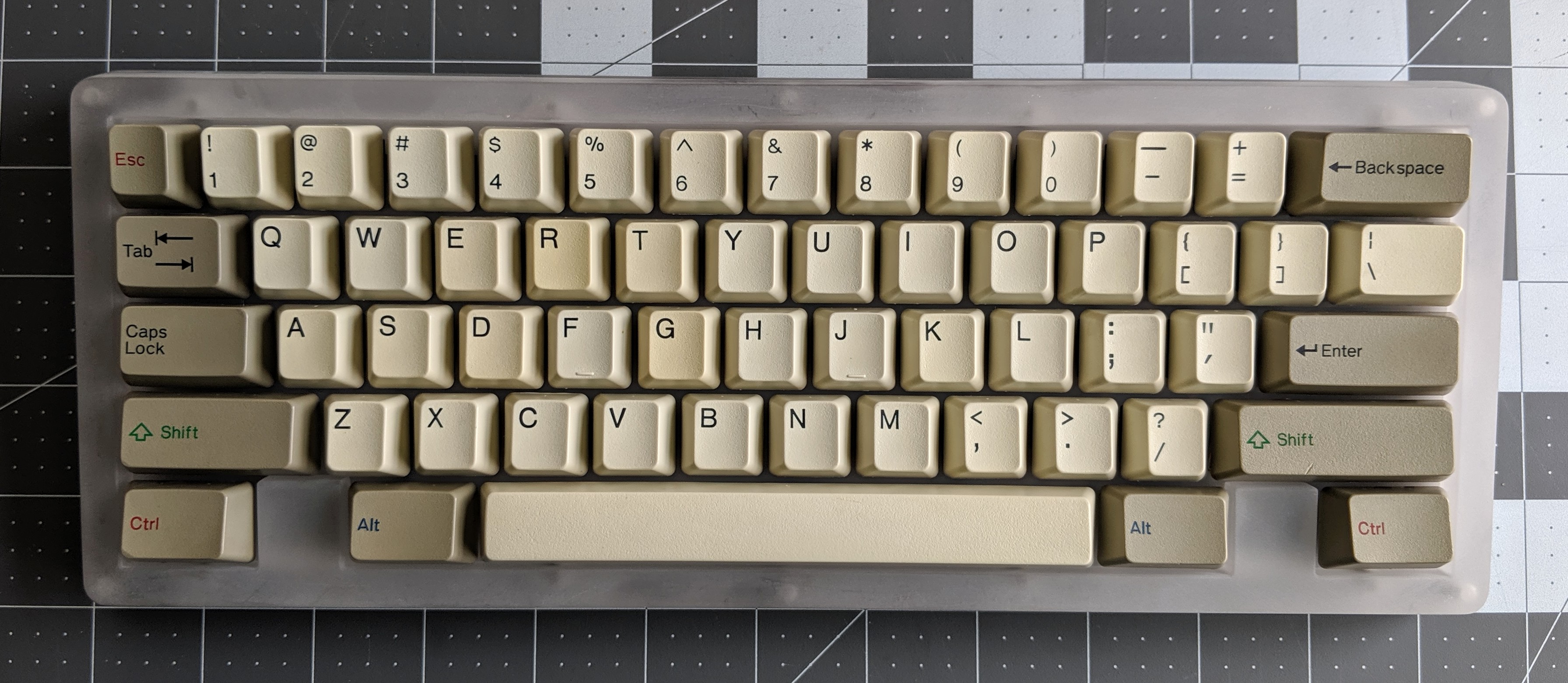

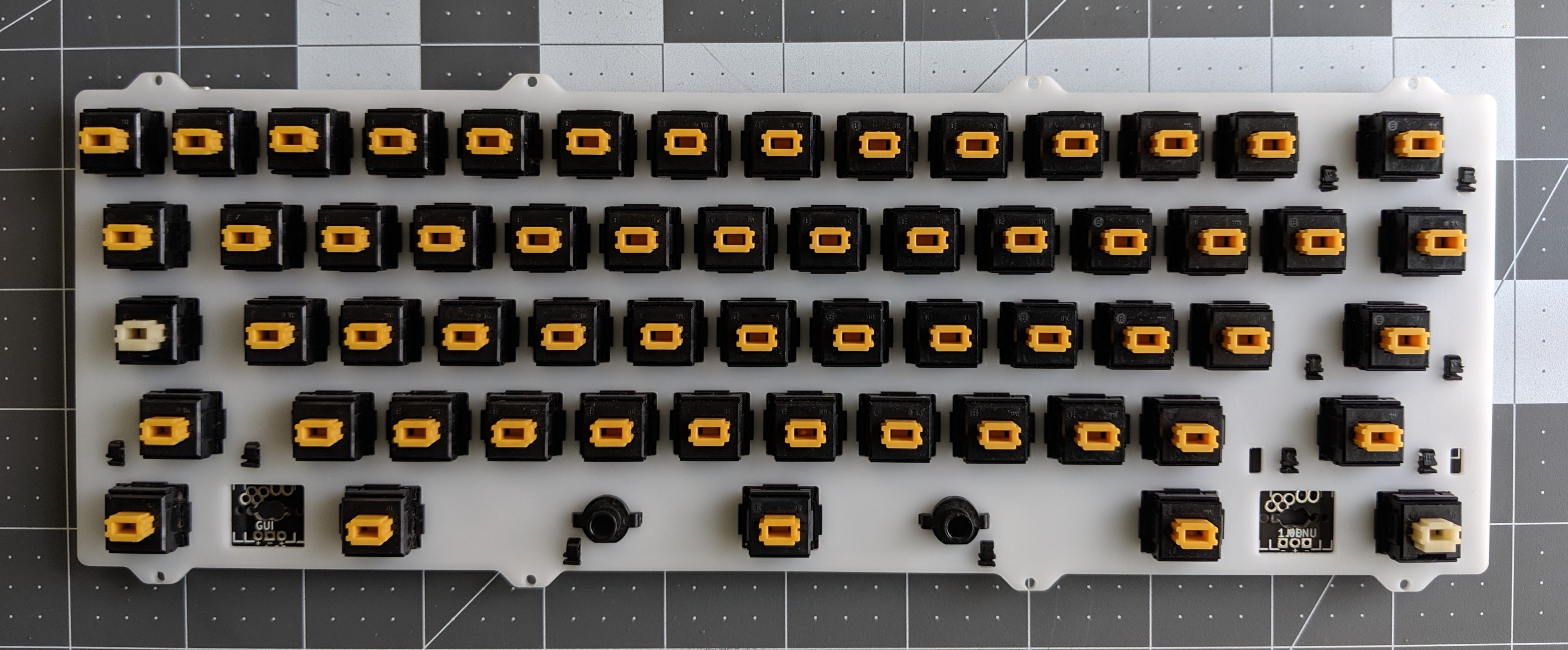

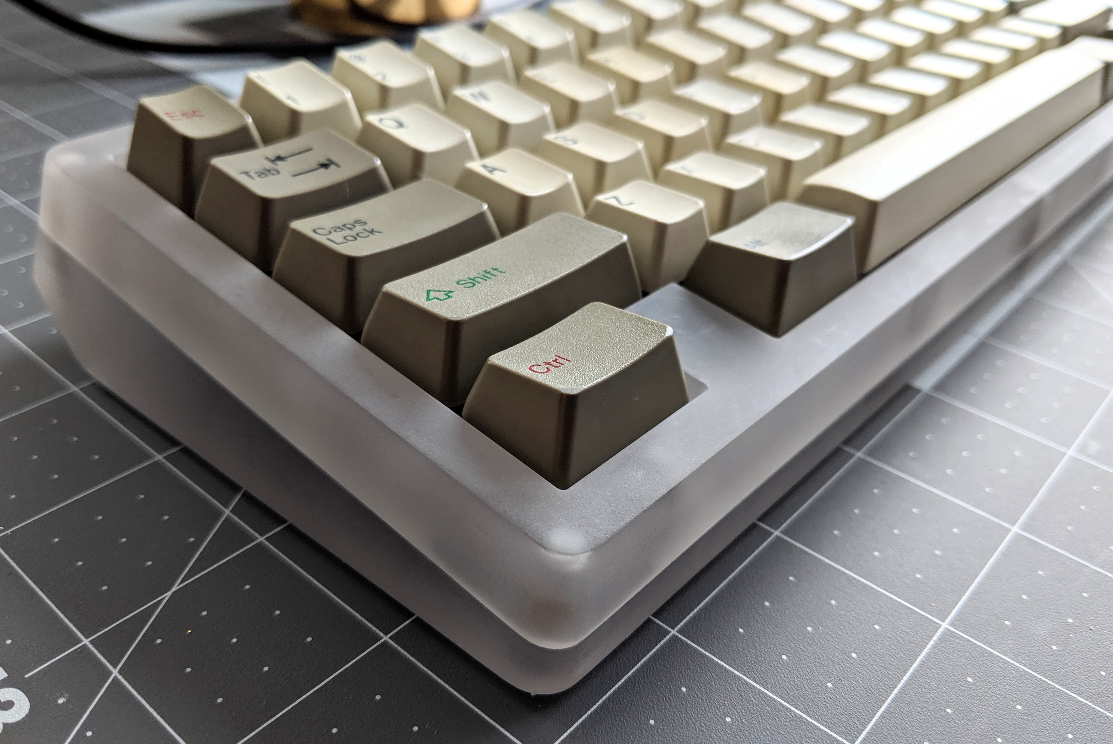

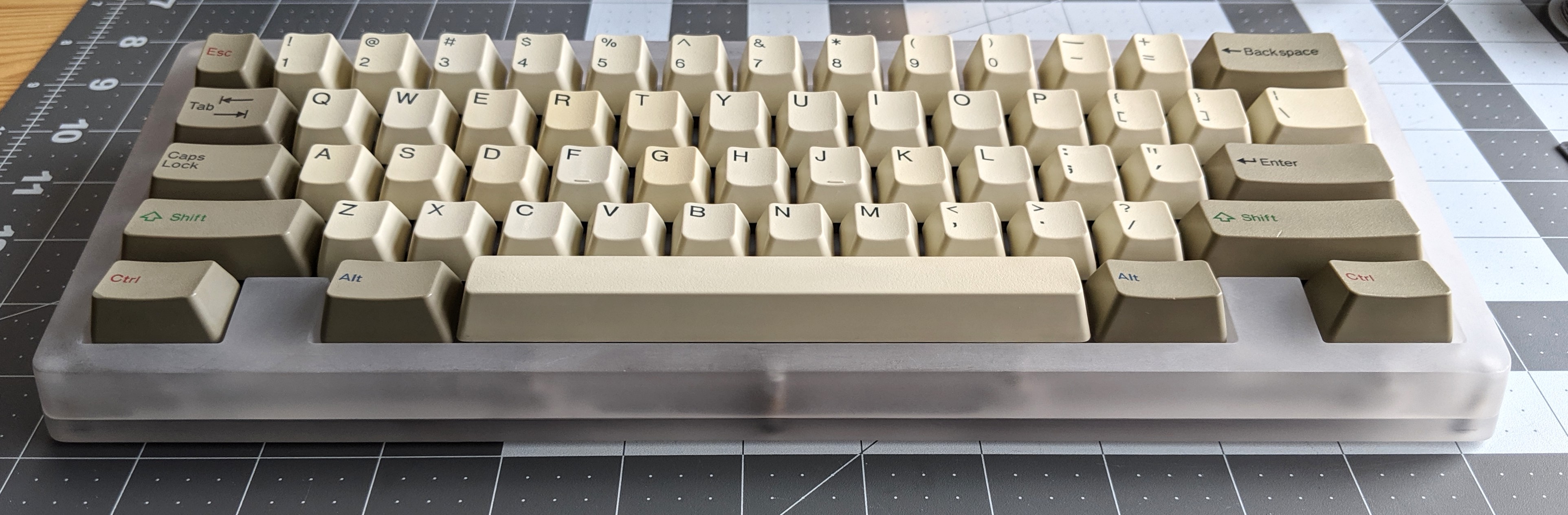

I took a bit of a dive into Alps recently and built my first board with them!
Amber Alps salvaged from a IIc keyboard, built in a polycarbonate Sirius prototype with a custom designed plate, Waldo PCB, and finished with the keycaps and stabalizer parts from a Northgate Omnikey. I ended up liking it very much.
