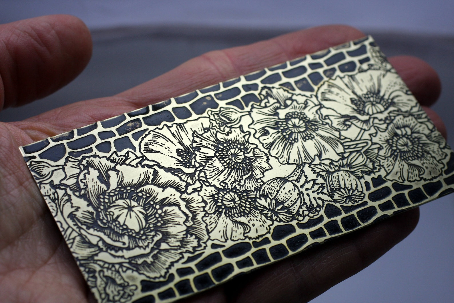

With that much surface you could do some seriously beautiful etching. Either by laser or via a chemical etching process. This is just an example of what is possible on metal surfaces:

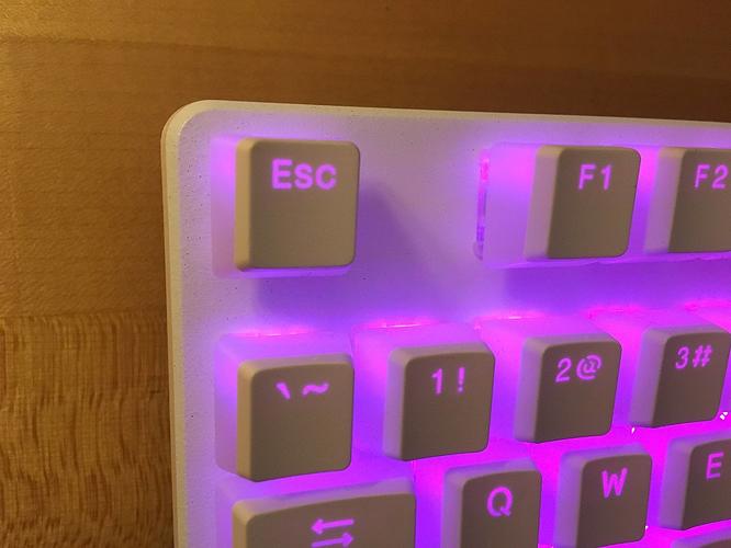

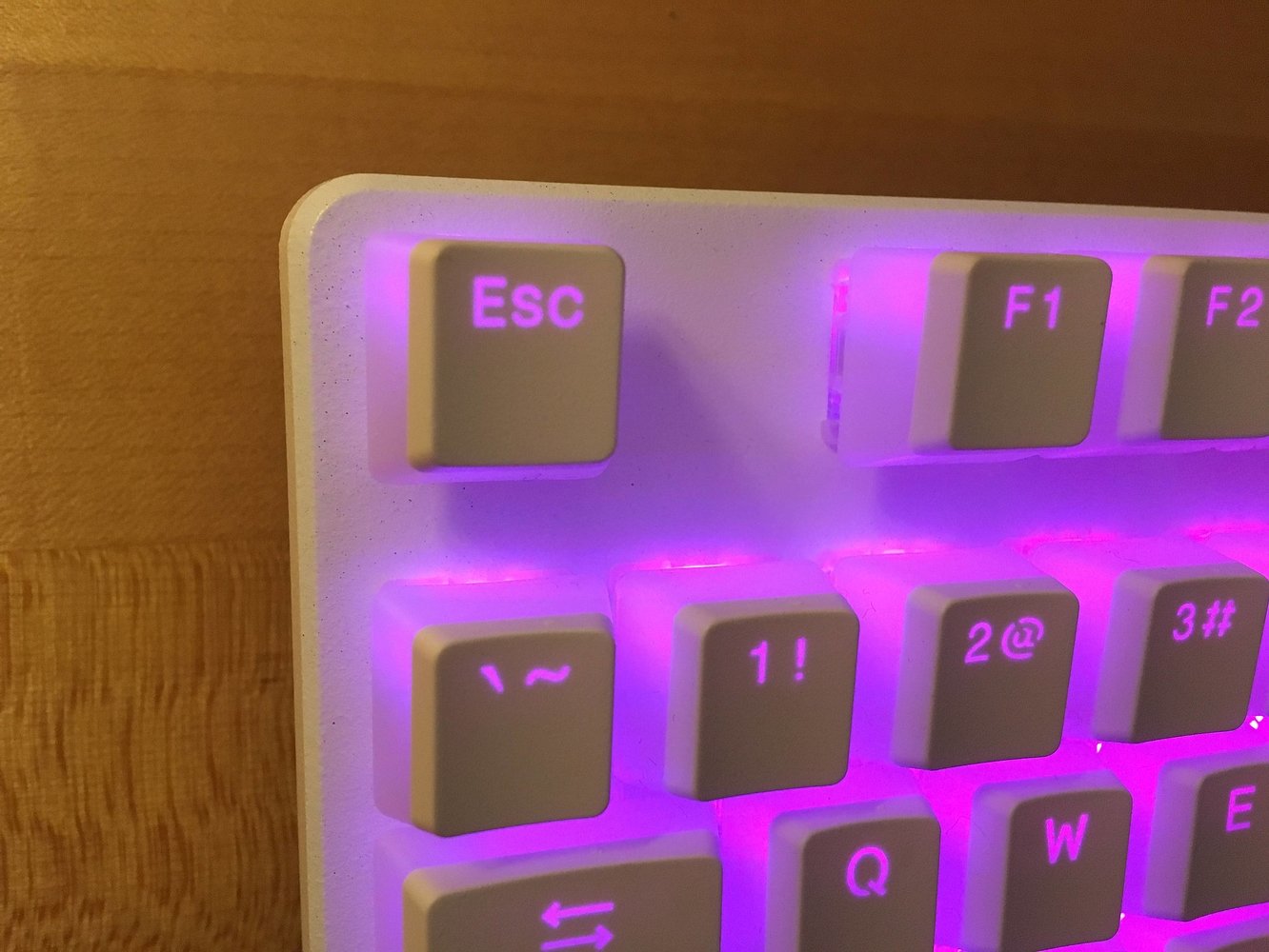

    Here’s a closeup photo of a GMMK I had powder coated satin white:
    You might be able to see some small bubble imperfections in the surface; I’d call this a “so-so” job, and I’ve definitely seen better - but the finish will definitely last.

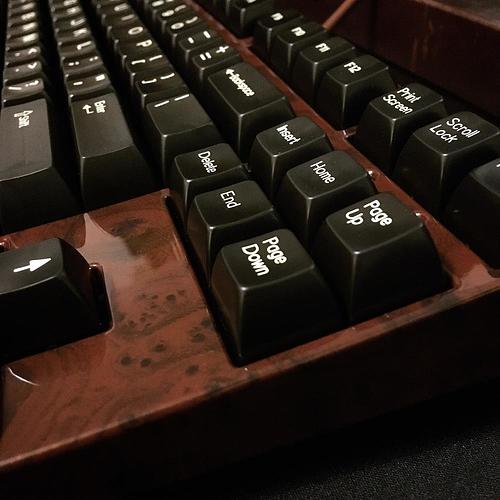

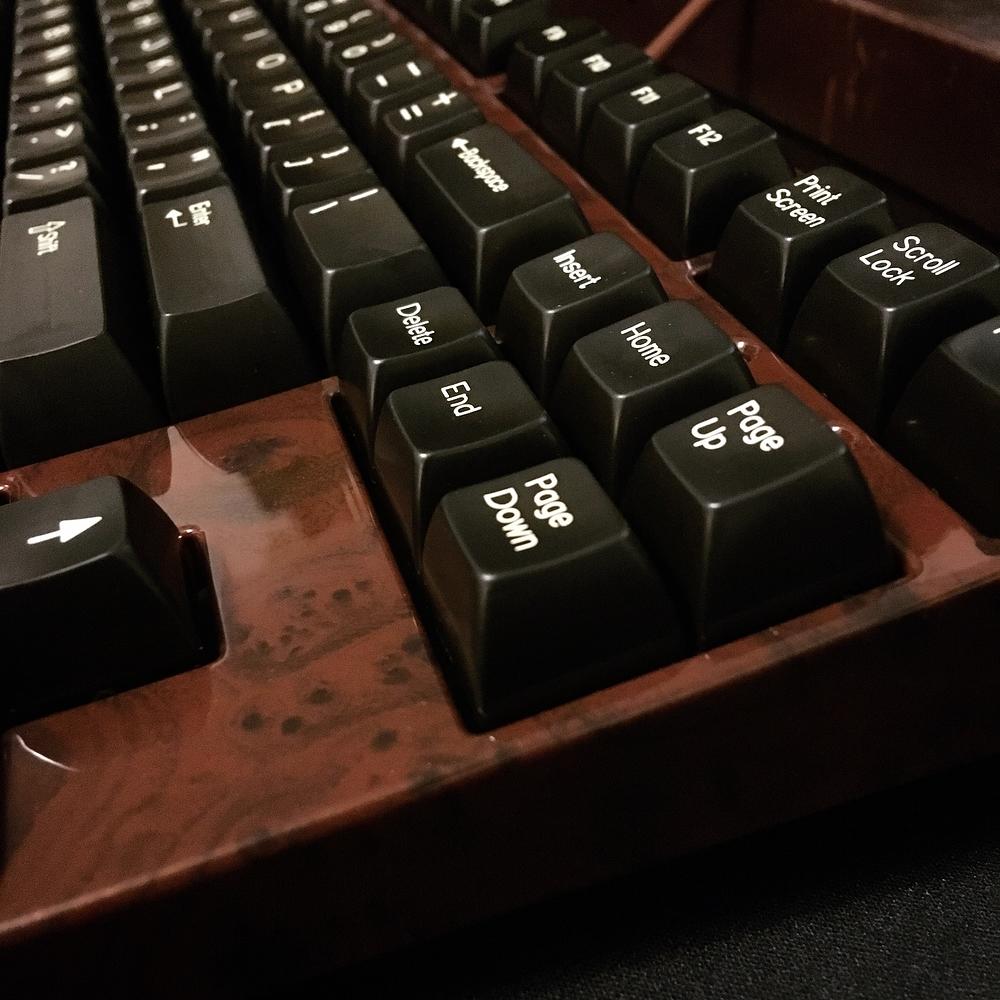

  • Lacquer:
    Not so much as an aftermarket thing, but as an option on a stock keeb. I have one of Filco’s Kobo cases and am a big fan of the finish; it’s glossy, smooth, and can have all kinds of neat effects like sparkles, an almost woodgrain sheen, splatter designs, etc. From what I understand, the case underneath is a standard plastic Filco case, though I don’t know exactly what plastic that is. Here’s a closeup of the Kobo “classic brown” finish:
    The graininess is actually the old phone camera this was taken with; the finish itself is done with dripping pigment, so you won’t see any pixels there like you might on a faux-wood desk.

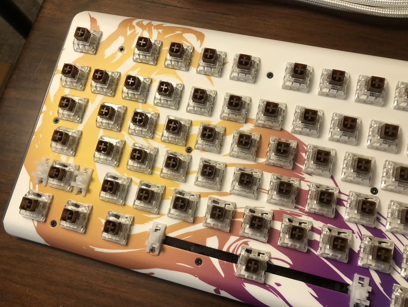

  • Laminated Vinyl Wrap:
    Really only suitable for cases with flat plates, or at least ones that only bend in one axis - unless you’re an industry wrap expert, then go HAAM. While the range of finishes is small (gloss, semi gloss, not gloss), the possibilities for design are totally endless.
    You can use a camo pattern. You can use wood grain. Paisley. Whatever pattern you want - but it doesn’t have to be a pattern, either. You can use photos, custom graphics, anything that can be printed can be put on vinyl. Here’s a shot of a Hexgears Impulse with a wrapped top plate I did for a friend:
    The lamination layer makes it a little thicker and harder to work with, but it will make the print last much, much longer and stand up to scuffing and basic cleaning.
    As for the type of vinyl to use: you’ll want “air-channel release” auto wrap vinyl, or a similar product - the adhesive layer has air-channels to let out air and prevent bubbles; the difference this makes compared with standard adhesive is huge, and makes application much easier.
