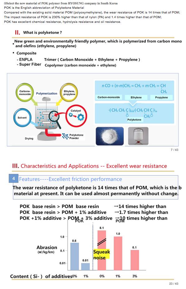

Today I was browsing TTC’s site, and saw they have a switch touting a new(?) plastic called “polyketone” or “POK” - this replaces POM (polyoxymethylene) in the stem:
What are some of your favorite (or least favorite) “novel” plastics (or other materials) for switches or other keyboard components? (POM plates and caps, terrazzo cases, etc.)
