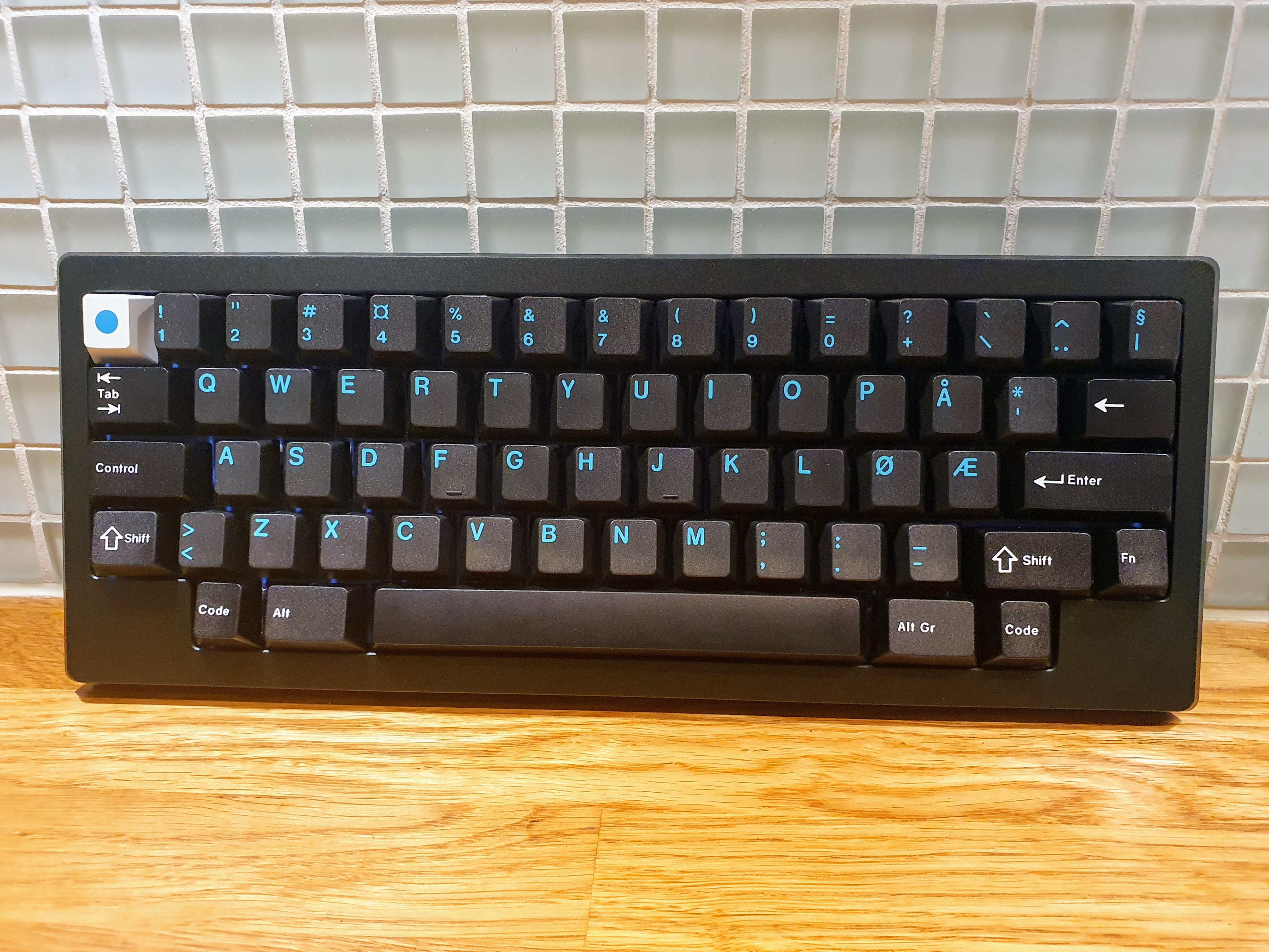

This is a little off topic, but since I also use a Norwegian ANSI-style layout, here’s my recommendation (you can ignore the HHKB bottom row and Ctrl placement):
In other words, I use a 1.5u Backspace above Enter (known as “split backspace” since the usual Backspace key on the top row is split into two 2u keys) instead of a 1.25u Enter, and I’ve swapped the (Norwegian) '* and ¨^ keys so '* remains close to Enter. That sadly means that the profile of those two keys are wrong though.
That said, I’ve also created the Norwerty layout for standard ANSI (which I don’t use myself anymore) in case that’s something you’d be interested in trying.
Haven’t tried a 1.25u Enter, that could be interesting too, but I prefer the sizes of the modifier keys to be somewhat symmetrical on the left and the right side of the board (the ISO split left Shift is an unfortunate problem for me, and I currently have a BoW <> key on there so it matches the mods). That’s actually one reason I prefer split Backspace; the | key on ANSI is IMO an abomination.

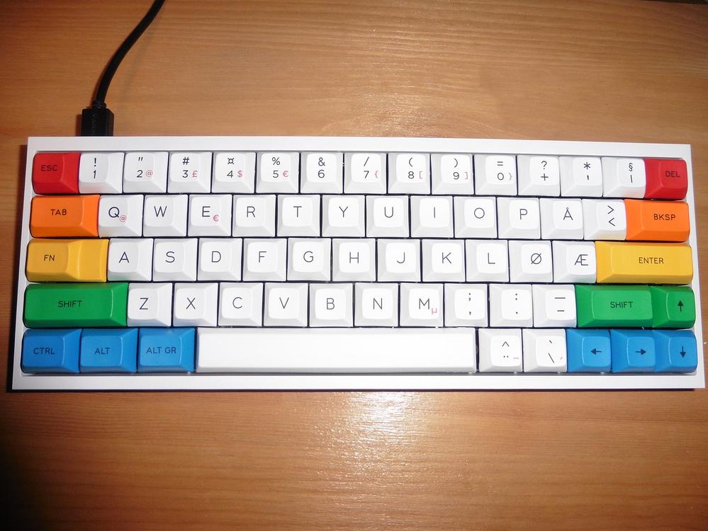

I actually use a HHKB-inspired Norwegian ANSI layout with split backspace too.
Slightly different to your layout.
It’s a big improvement on my previous build, but I’m still not entirely happy.
